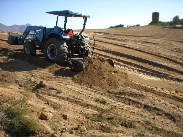

I think that the roll over box blades are usually considered to be heavy duty. They might be a little on the light side to really be that, but they are heaver than a medium duty blade. My 81" roll over is 980lbs and has held up fine behind my 12,000lb tractor. If you look at industrial blades, you will find them to be 1200-1600lbs for a 7 foot model. Oh, and the industrial models are a lot more $$$$ than the roll overs.
Something to have in mind is that the roll over blades were designed back when there were no rear remotes on the tractors. So with the pull of a lever you could have your rippers in the ground without getting out of your seat. And the same holds true for the other functions of the blade.

Brian,
Thanks for the comments and pictures. It looks like you have nice soft, sandy soil. I'm dealing with clay and embedded rocks though :( Mostly I would be using the blade for building and grading trails through the woods.
When I had a light duty scraper blade, I was a frequent customer at the weld shop <sigh>.
