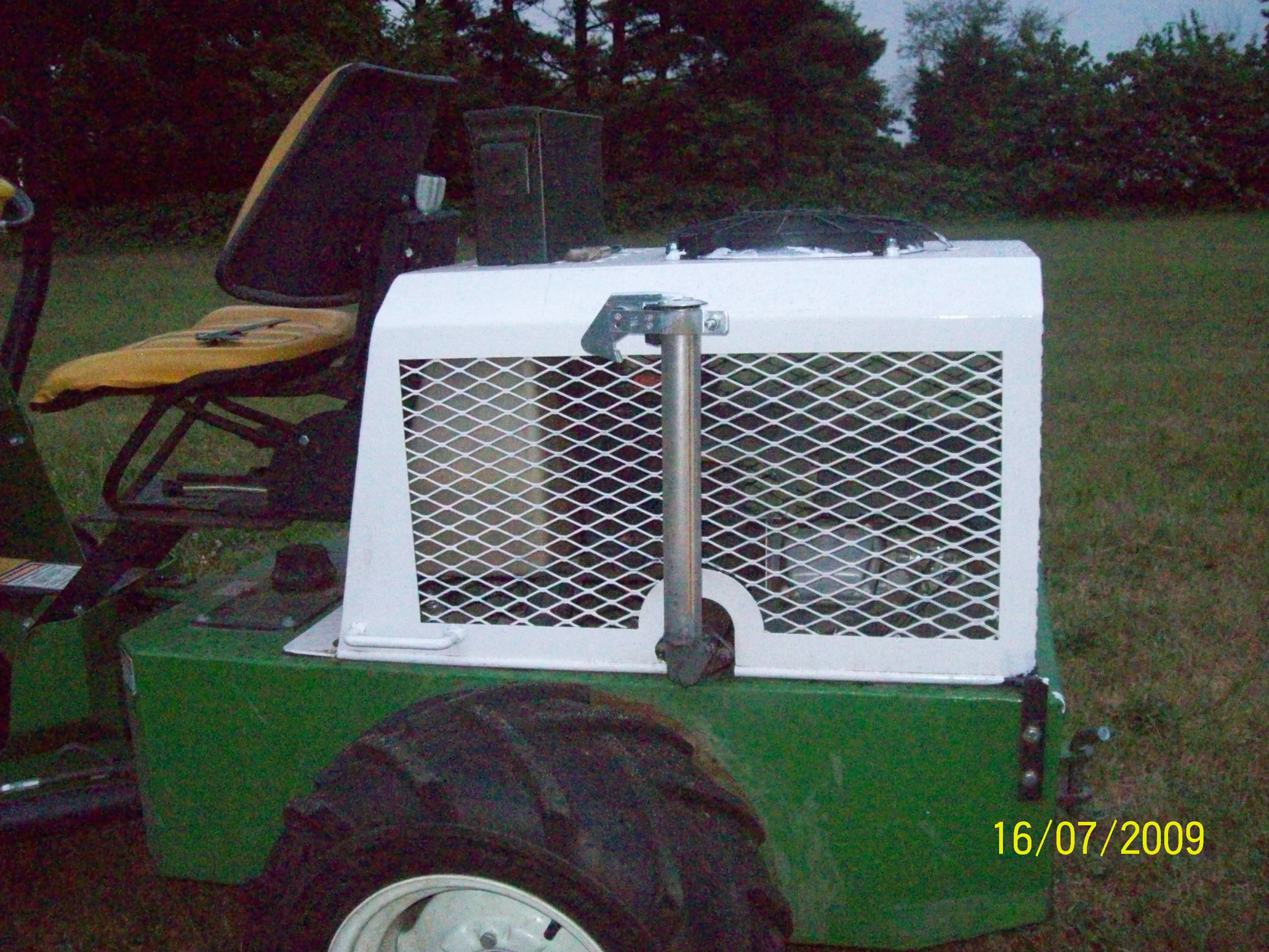

this is how I fixed the VL problem on my 2007 model 425 please note a motorcycle style baffle is in the straight pipe (keeps the neighbors on good terms) I also welded a longer stud onto the carburator so I could use commonly available Kohler airfilters

a little more info the muffler was replaced because I accidently backed into a tree and bent it :eek:original muffler had approximately 12 3/16'' diameter holes on inlet and the same on outlet pipe :mad: suprised the motor could run with such a restriction:eek:replaced with straight pipe with internal baffle:cool:now it starts quicker it uses less fuel and no air bubbles in fuel cell, plus no backfiring when shut off and no more glowing pipes when working at night I have been checking my plugs to make sure I am not leaning out the motor;)I guess the fix was acheived through accident/incedent I have also noticed the engine runs best on 89 octane fuel not sure why maybe more complete combustion? thoughts on the octane?
