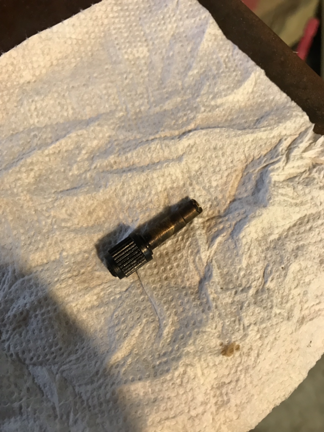

Loaded tires on my BX25d have been fine for 4 years but today I went to put my chains on and found the tires almost deflated and the valve stems wont take air. I got the chains on and somehow forced air into the tires by putting my air blower attachment on my compressor line over the valve stem. The little valve inside the stem that you push in to air down seems to be pushed in and not coming back out. Like I said, I somehow forced air in past the valve with my blower attachment and quickly put the cap on and they seem to be holding for now.
I need new valve stems for sure and I supppse the tires have to be broken down to replace them..? Im also thinking of getting rid of the liquid inside the tires and leaving them dry or unloaded...Any thoughts?

I forgot what the liquid is but it looks like water coming out of the valve stem. I recall the salesman telling me it was something other than water though...maybe treated with something to keep from freezing? I tried my small tool that removes the inner part but could not unscrew it...must be corroded. It is just a common valve stem. Thanks for the reply.
/ Valve stems bad #3
If it were beet juice - its red, sticky and can very likely be a bit stinky. Otherwise - salty tasting - sodium chloride // smells like windshield washer fluid - its some kind of blend of WW fluid and water.
If its salty - you should expect to change the inner core almost every other year//
Get yourself a "man sized" core removal tool - twist hard - the inner core will break loose and screw out.

Thanks! Yes the core tool I have is the plastic one that comes with a bottle of Slime...lol! I may take a ride to the dealer after plowing this afternoon. Hopefully it is that easy of a fix!

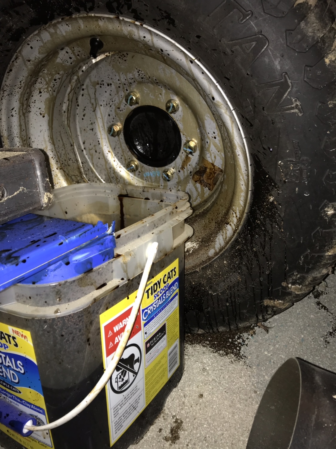

Rear tires both of them. Can this be done from the outside or do you need to break the bead and put it on from inside the wheel? And if you did not notice the tires are loaded.
Jack up tire then rotate tire valve stem to 12 o'clock. Remove valve core if fluid comes out tires were probably overfilled anyway because they're only supposed to be filled to 75%. Back when I was employed by a dealer I added fluid to many/many tractor tires. Easy peezy.
Tires are filled correctly it is the valve stem cores that are corroded and stopped working. I have new cores to try tomorrow if I can get the old ones to unscrew.

You have to get the weight off the tire! as txjim said...
