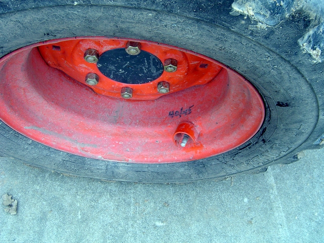

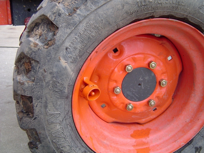

I was out in the woods pushing tree debris the other day. I heard a hissing sound...and the first thought was hydro line leak. The sound was coming from a front tire. A limb had rubbed up against the tire and busted off the brass valve stem. I slowly drove the tractor out and onto the trailer. A new brass valve stem cost $4 and $12 to remount the tire. I now keep a spare valve stem in the tractor toolbox. These valve stems unscrew about halfway up. The upper half is what broke off. You would think the manufacturers would think of these everyday life things and add better protection...
First pic is the OEM valve stem cover which does not protect much.
Second pic is my modification. I cut a piece of pipe, ovalled it and welded it to the OEM cover.

I like it Redbug! Thats a great idea!
/ Valve Stem Mod #4
I really like that. Nice work. Good protection but still room enough to get a gauge or chuck on it, etc.

I've worried about that on my BX24- it has NO protection around the stems.
I noticed some of the big machinery has about a 2" pipe nipple with a pipe cap screwed on covering the entire valve stem- now THAT is protection;)
I wonder why nobody makes an emergency valve stem that can inserted from the outside until a proper repair can be made? Seems like it would be relatively easy to make with an expanding rubber portion. Probably afraid of liability when some doofus uses it on his SUV, drives 90 and it lets loose:cool:
BTW one doesn't have demount/remount the tire to replace a valve stem- I've used a jack under my truck trailer hitch to break the bead and shove the sidewall down far enough to reach inside and insert a new valve stem:)

Lots of heavy equipment have a piece of pipe welded over the stem, and it is threded to accept a cap.. this keeps it clean too.

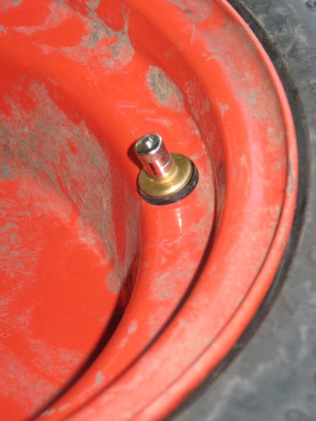

i liked the pipe welded on to protect the valve stem idea. but, didn't have time to mess with dismounting and doing the fabrication work, so here is my solution. so far, it has been working, but a couple of passes through the garden with the plow next week should tell the tale.
basically, its as simple as waiting till your oem valve stem breaks off, then take the tire to a professional tire shop and ask them to replace the stem with the shortest, all metal valve stem they have. they are used for high pressure applications like heavy duty truck and trailer tires, etc. i had to go to several shops before i found one with the right parts. if you can't find them locally, just order them online and then you'll have them to replace as each of your oem stems goes bad.

I worked on off-road wheeled forestry equipment. Most Hyro-AX and skidders use a short piece of black pipe threaded with a pipe cap installed. The threaded pipe welded at the valve stem and capped with the pipe cap. A good system,except you will need a pipe wrench to check/add air.

Hey, that's real good idea with the short valve stems! I had never seen such short ones. Amp...do those short ones also screw apart, (with o ring and shrader valve in the top half), like the longer ones? Or are they all one piece?
