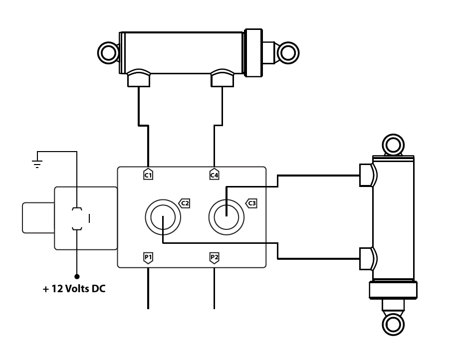

/ Valve Question #6
I am not sure on the piping. How would I connect to the existing two-spooler?
((Stole the pic from your link in the 'instruction' section.))
One of your circuits outlet pairs goes to P1 and P2
C1 and C4 go to the circuits you just stole from.
And lastly, C2 and C3 go to your new circuit (grapple).
