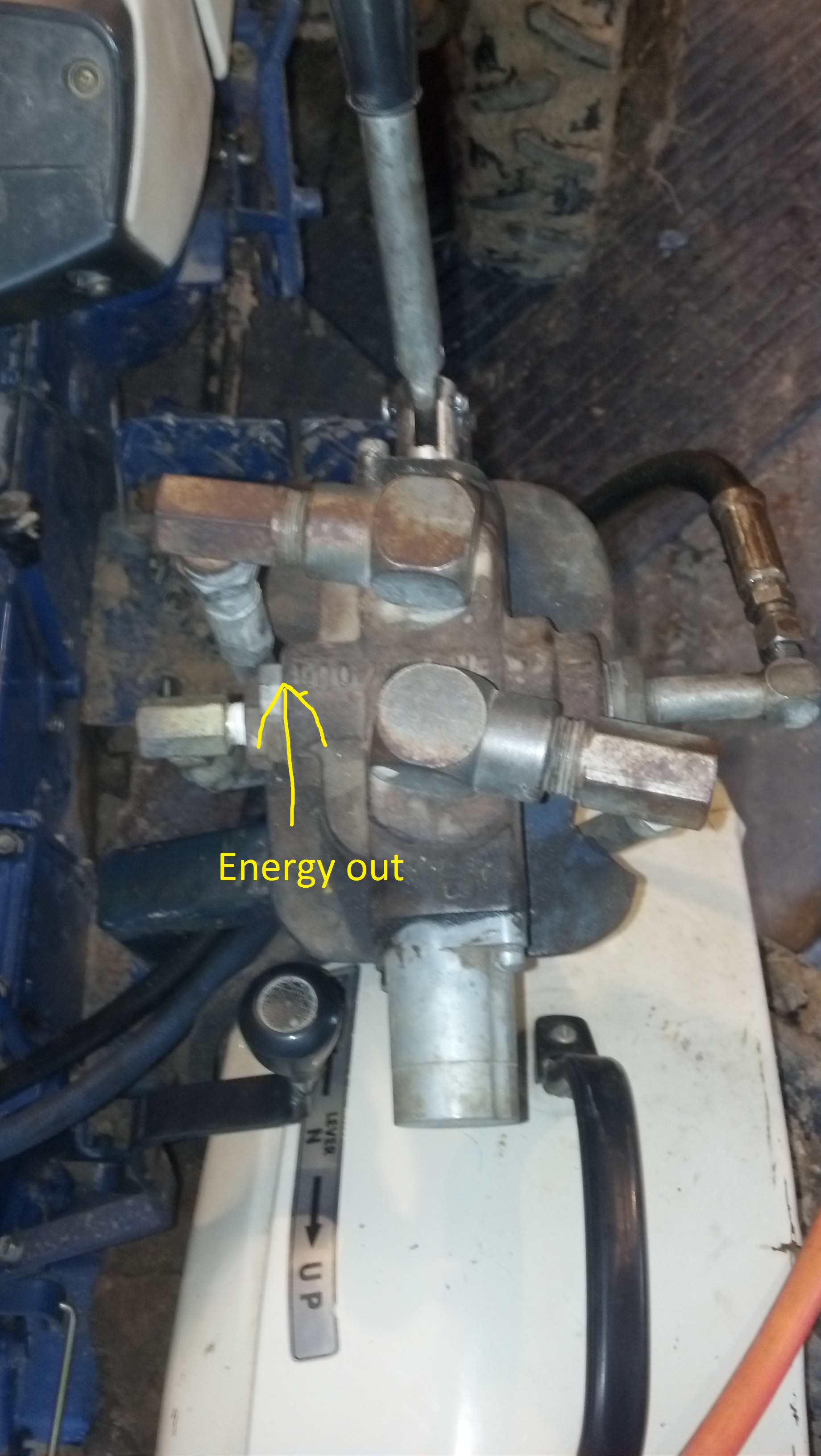

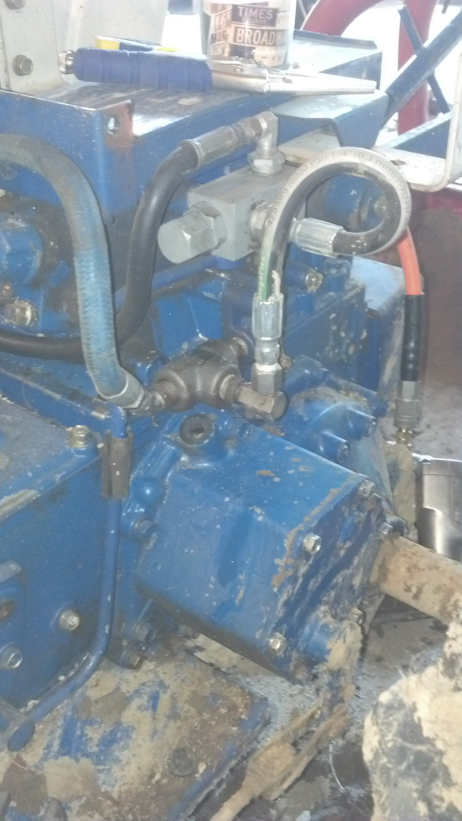

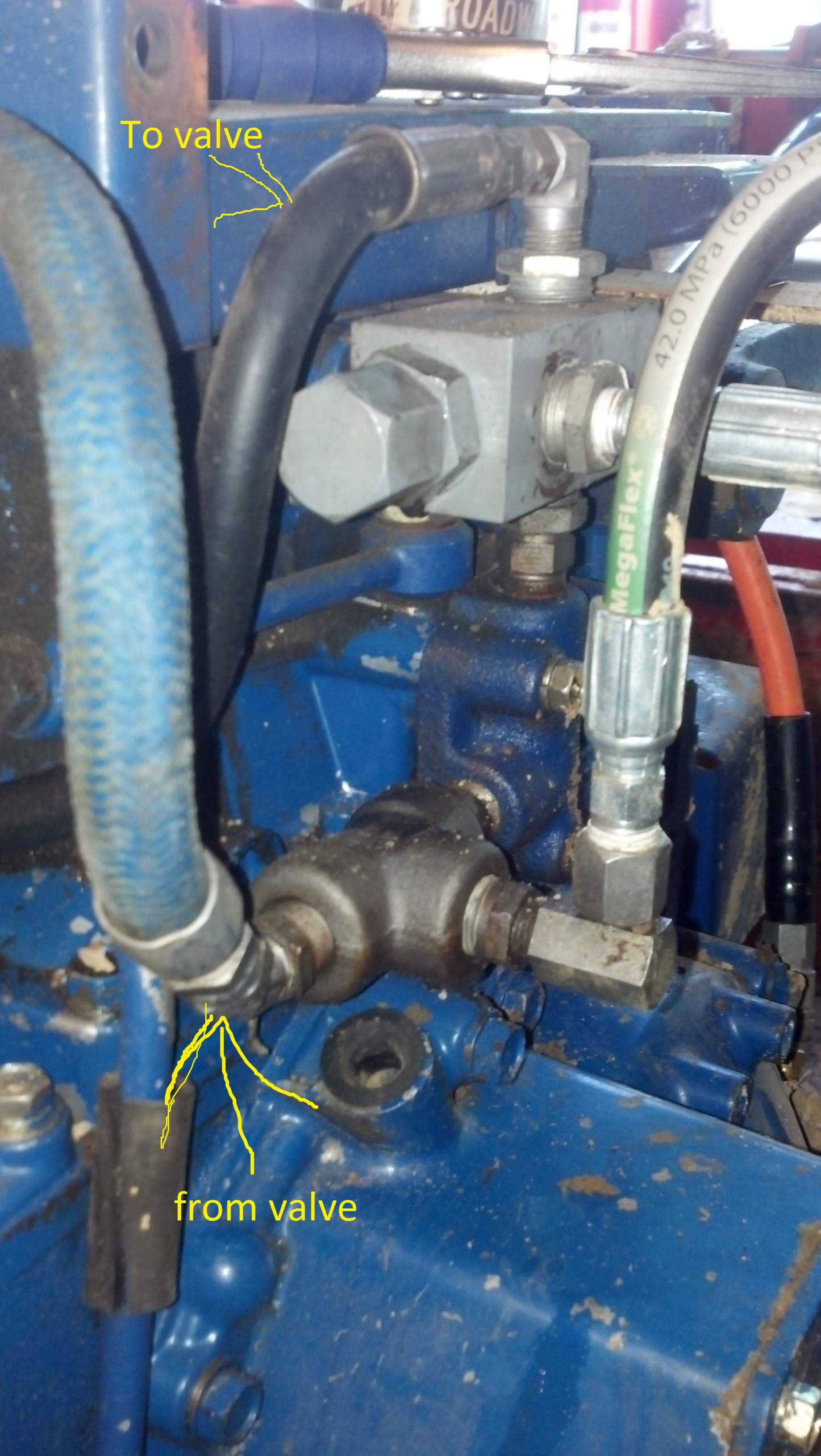

That makes sense and could b my problem. I tested it this morning and when lifting the 3pt the blade does not move with the handle pulled witch would indicate that the 3pt is inline before the spoon valve for the blade. If i could find a schematic for this old tractor i think i could figure it out. I just don't want to start trying thins and ruin the pump.
there are two outputs on the spoon valve and one is labeled energy out, would that be the power beyond port? And if i use the power beyond port would i just plug the other port?
i took some pictures showing the plumbing and will try to attach them.

I would suggest to remove the log splitter valve, if that is what it is.
I would remove all the water pipe fittings.
The blade should probably have a float position.
You could make this work correctly with this valve.
Just plug the curl ports/spool 2 if you do not want to adjust the front blade for tilt.
Surplus Center - 2 SPOOL 7 GPM CROSS SS OC W/ PBYD VALVE
This is the way the hyd plumbing should go if you used the valve above.
From pump to IN port of new valve, from PB port to IN of 3pt valve, the tank or OUT port would go to tank.
Work ports would go to front cyl.
With this valve you would have PB and float, and an extra spool.

Thanks for the reply. I think the valve you suggested will be perfect.
I looked up the valve and found it is a log splitter valve, and had already decided to replace it. The only thing that I have to work out is where to plumb the line to the tank -- which is the transmission on this tractor.
