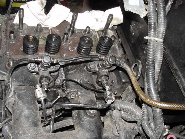

Therein lies the problem with your theory. Take a look at this Y380 head (photo courtesy of HarryG), and you'll see what I mean. The intake and exhaust runners aren't anywhere near in-line with the associated valves.
The fuel injector locations might be better indicators, but I think the visible blowby should be a dead giveaway. Note the discoloration above valves 2/4/6. To me, that spells exhaust gases blowing past the valve guide seals. So by default, that should make 1/3/5 the intakes.
