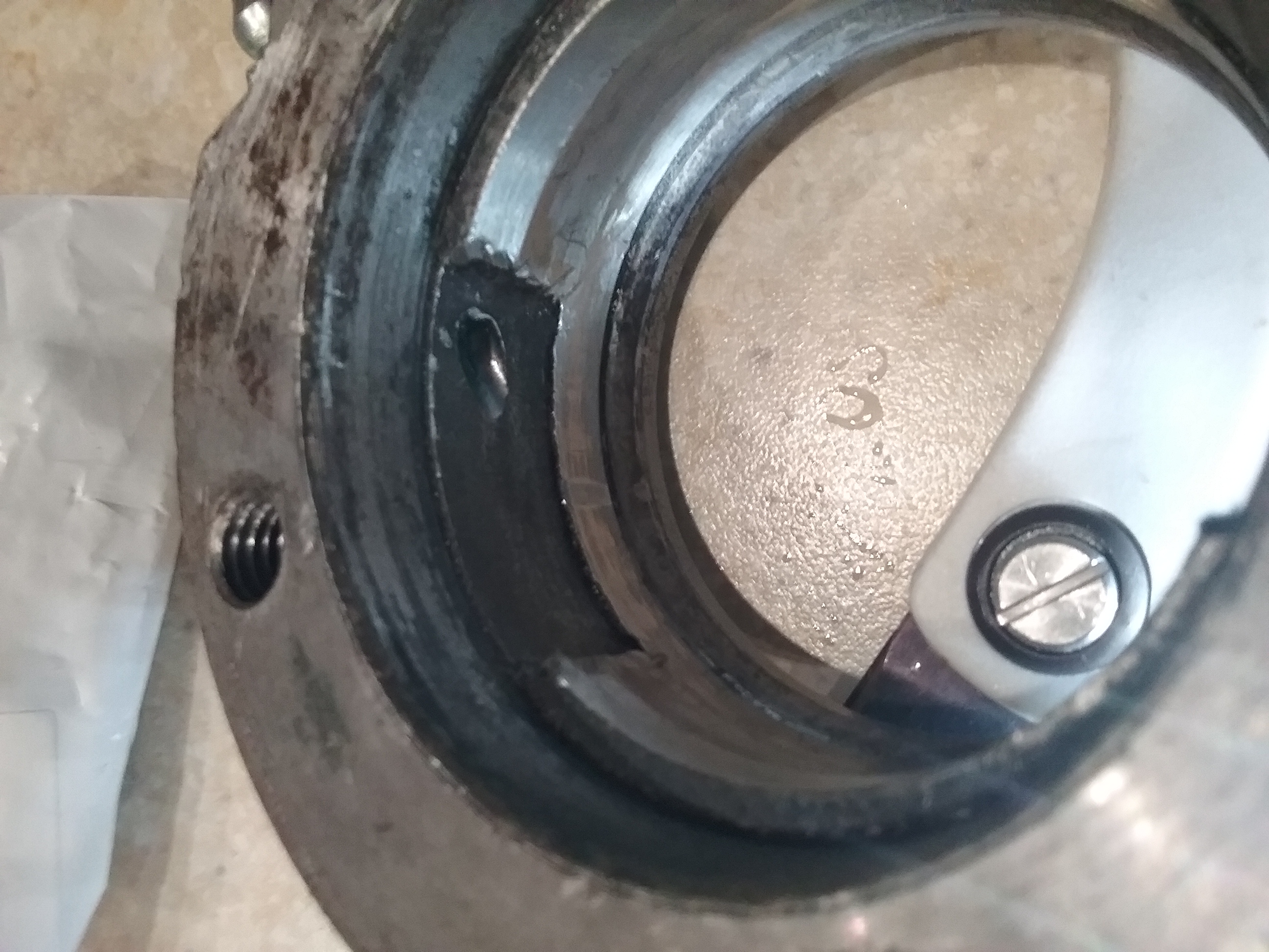

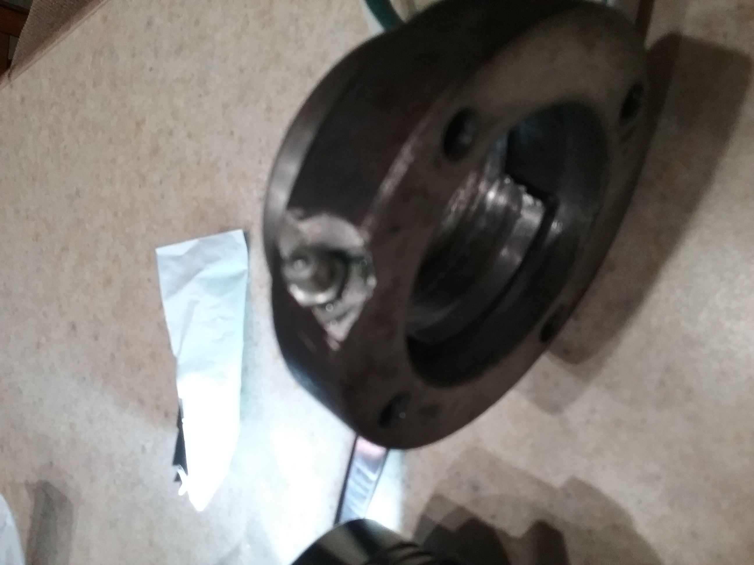

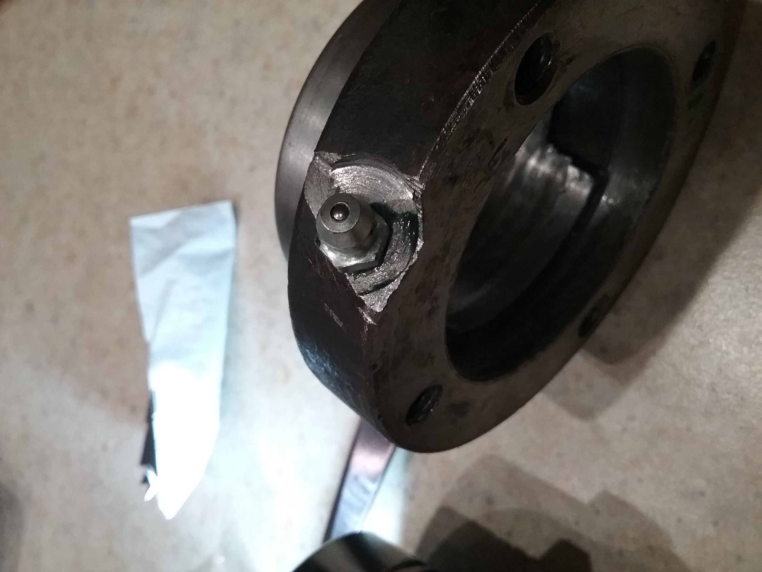

pics of bearing housing after drilling for grease fitting 20190502_205426.jpg20190502_205446.jpg20190502_205428.jpg

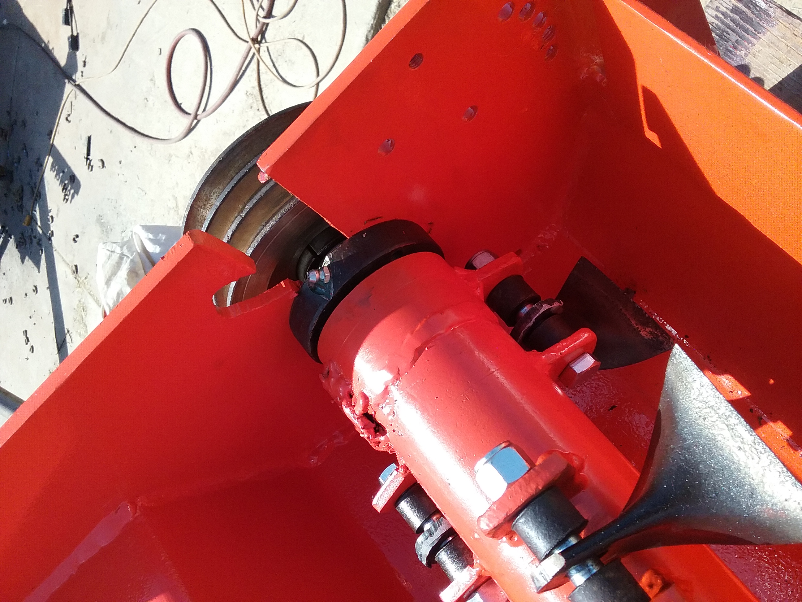

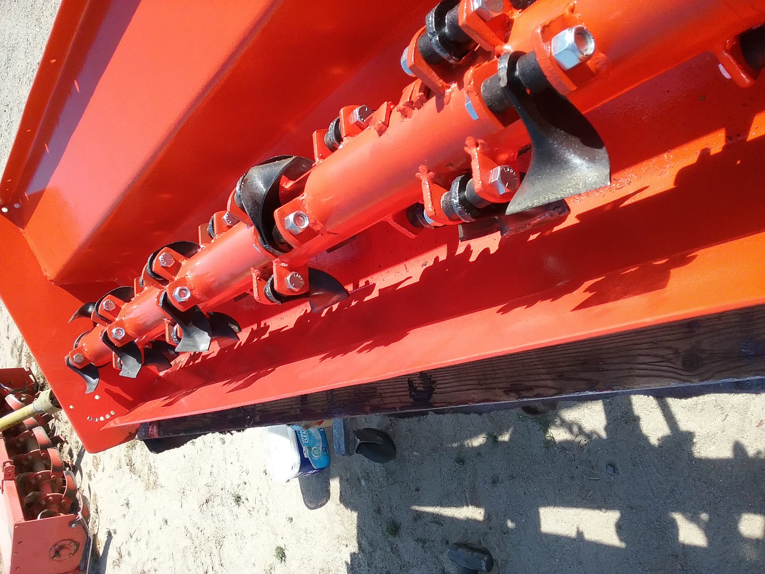

after some delay I finally finished the mower. the rotor repair came out much better than expected. no vibraion at all

Nice work. I am glad you were able to save it.

just and Update, two years later, mower is still working fine, no damage to the grease zerk that is mounted in the bearing housing inside the mower on the rotor , I did hard face the grass blades the last time I changed the blades out. I used a powder hard facing torch, blades blades have lasted about 4 times longer than usual. I know hardfacing blades is not recommended there is risk of the hard facing chipping and causing injury or property damage,
