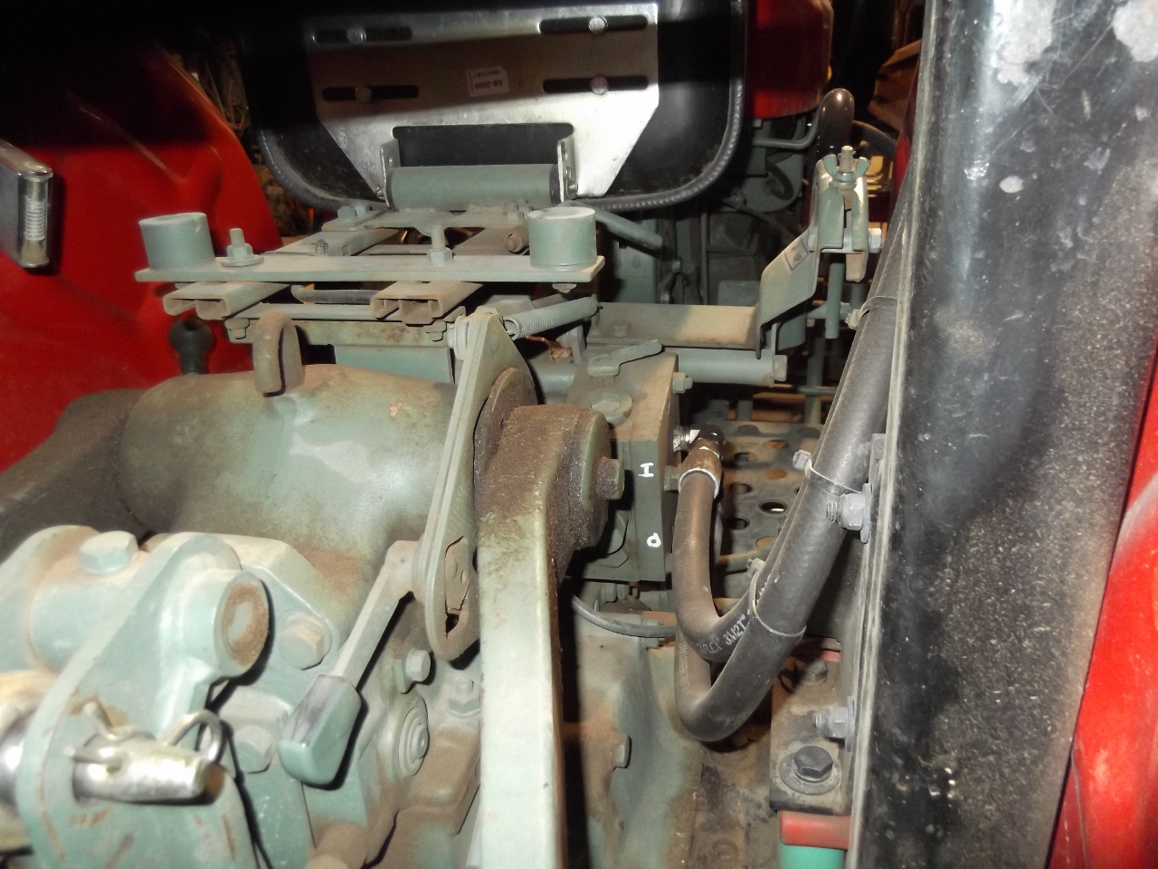

Cardoc - interested in what you said...I thought the draft control had to have an implement like a tiller that put pressure on a spring to make the draft control work.
I have draft control but it does not seem to matter where I set it.

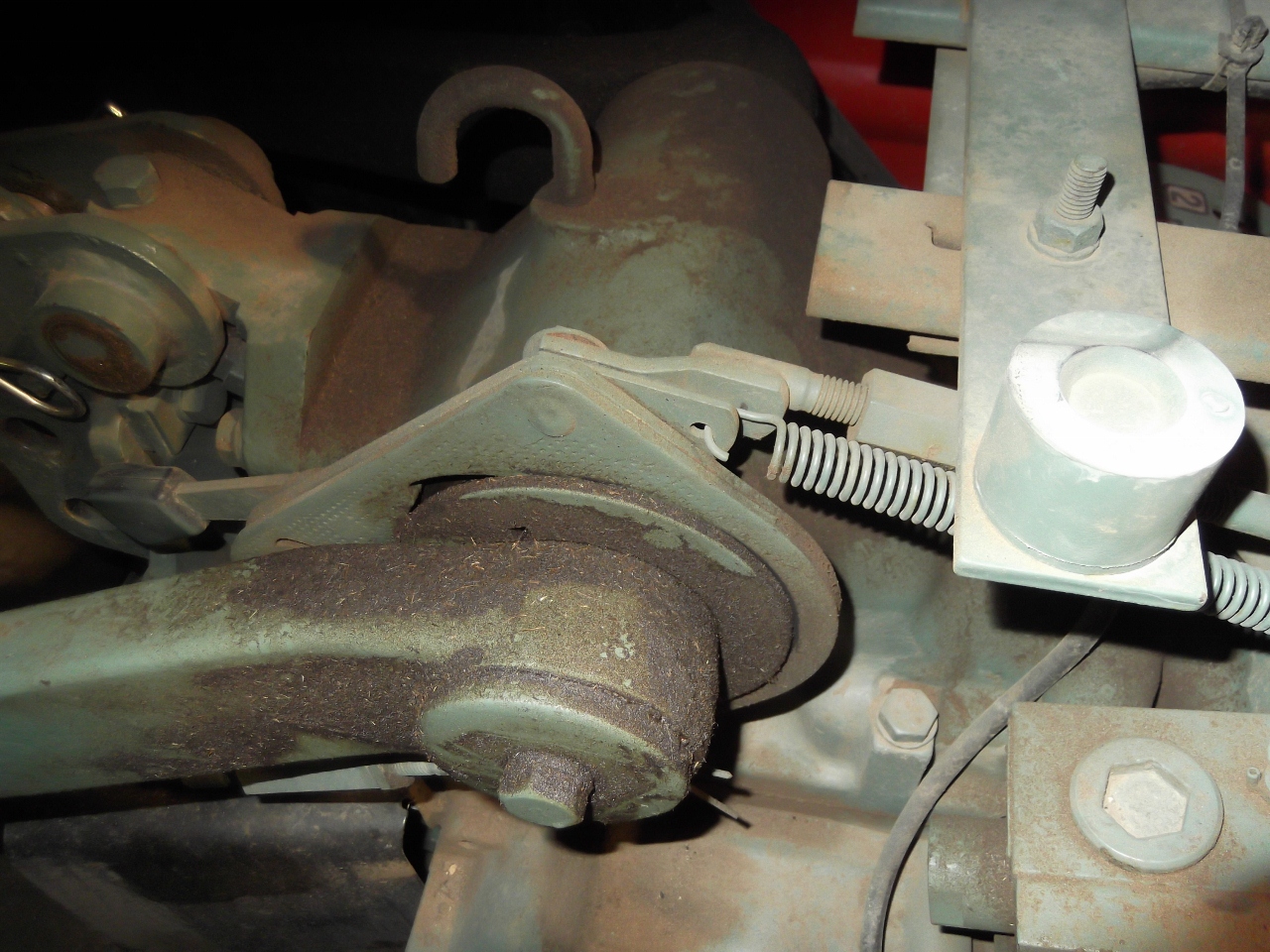

Scotty, Yes there has to be some sort of increased pull (push) on the top link (or whatever is the operating piece) and in my case because the sensing mechanism is the spring loaded top link bracket. On mine it also has 3 holes to varies the sensitivity.
Yours may well differ from mine the pics of yours from the manual are hard for me to grasp because I dont have anything close by to compare them to but it looks like it works the same. I dont know how to make it work properly the instructions are in my manual but they are very vague.
Mine uses a small lever which engages a friction clutch at the rock shaft pivot to lock the pivot into the draft control valve and therefore transmits input manually to the valve just like someone moving the lever by hand just automatically.

Well well well, I learn something new every day. I sure haven't seen that draft control set up before. Thanks for the pictures.

Pics of stuff are good I always like seeing them too wish they were of some help to Scotty but I bet what Winston posted is going to be the way to go. :thumbsup:
