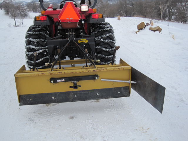

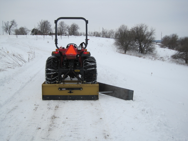

I put a wing on my box blade. My driveway crosses a pond dam and if I push snow over the edge there isn't a snow bank and it stays clean during windy days. It also takes only two passes to clean the driveway wide enough. The angle is adjustable and the lower edge is about an inch higher than the cutting edge of the box blade. I used door hinges to attach it so it is easily removable.
