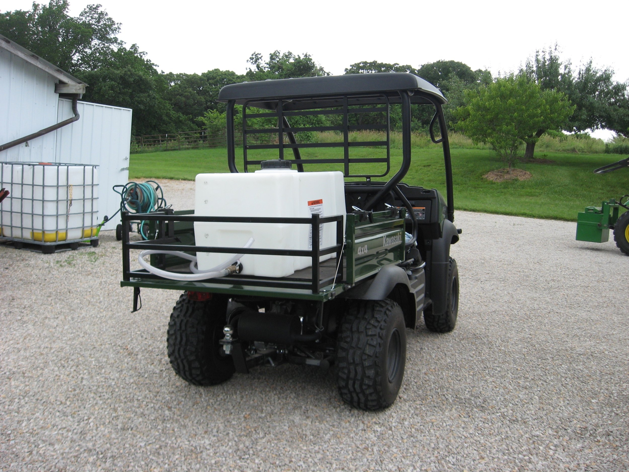

Wondering how the 520 handles trailer towing? Looks like Kubota lists it for up to 1100 lbs or so. The Mule is also spec. for 1100 lbs and it is good for towing, which is about the only real work I use it for. Mostly just transport around the property.
The other task is occasional water hauling duty
