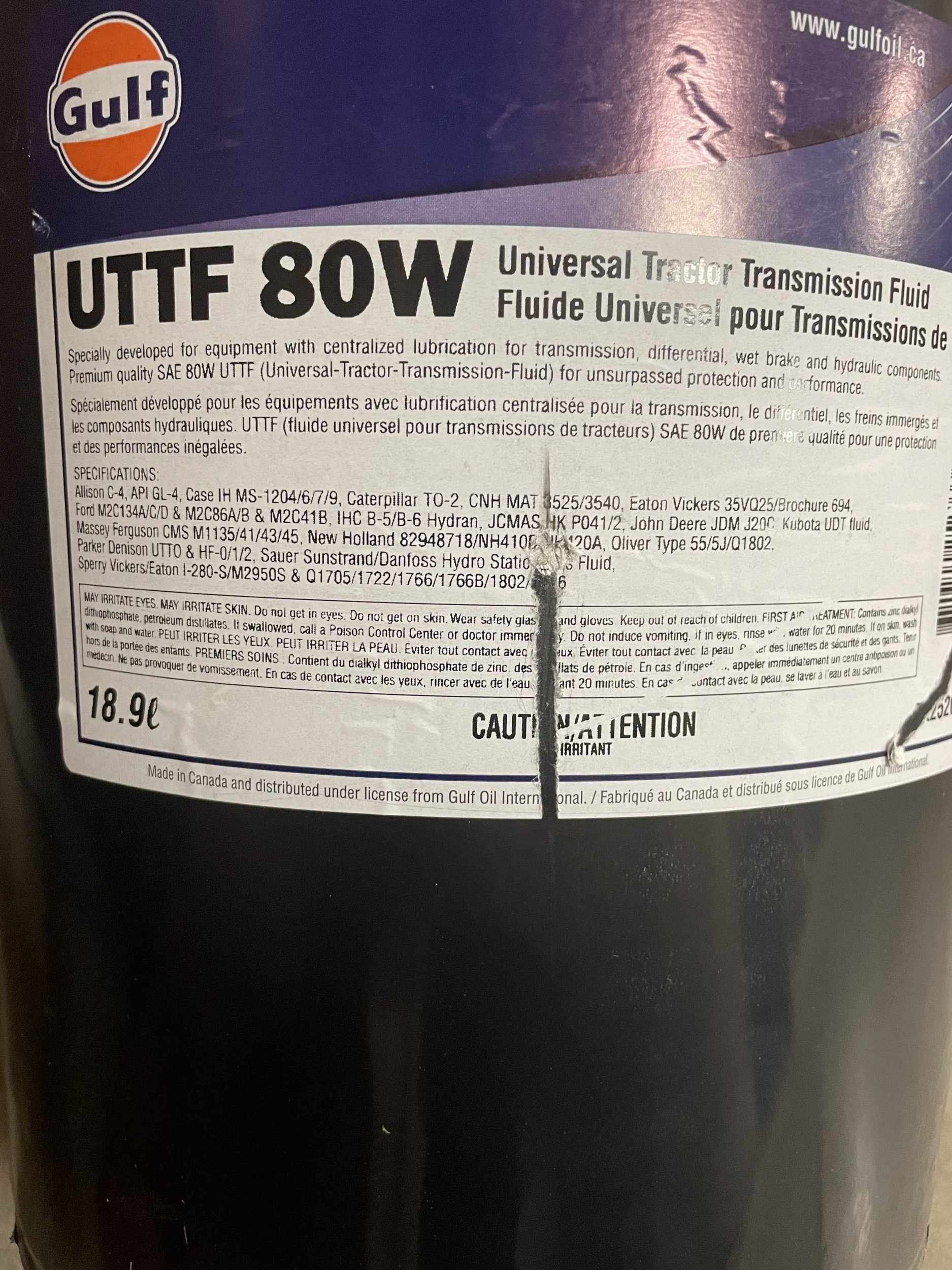

I have a chance to buy some Gulf UTTF 80W. Are there different s weights to UTTF? I thought it was universal fluid meaning it would work in most brand of tractor.

I agree but most UTTF / UDT fluids from what I’ve seen don’t put the weight on the label. For example, what is the weighting of Kubota UDT / UDT2 fluid? This oil says it’s compatible with Kubota UDT fluid which I’m assuming would be fine for my Kioti (other than it may make a cringy face if I used it 😂)
I never really knew the weighting of these fluids, thought they were all compatible. Thanks for any info.

Most UTF will be labeled some were in there data sheets with a weight usually it will be a multi weight,
such as 10-30 or 10-40 the higher end fluids may be 5-30 or 5-40.
I hadn't noticed one with a straight 80W which in gear lubes is about the same viscosity as 30 weight motor oil.
