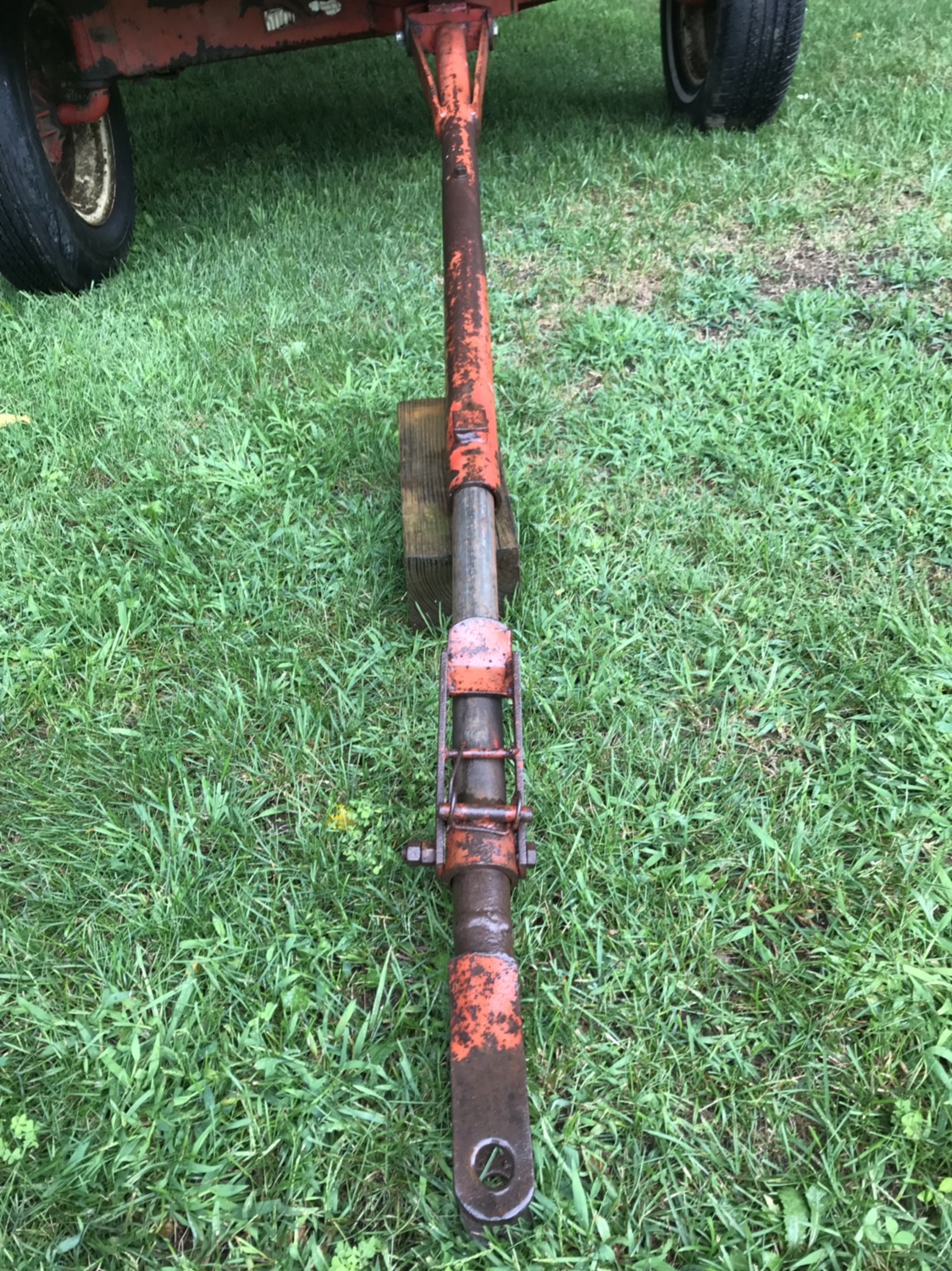

Try and find you a tongue off a gravity flow wagon, they make some that have a mechanism that you can extend the tongue to hook it up then you back up and it locks and off you go. We had two when we were messing with corn and they are time savers and easy to hook up.
They are handier than a pocket on a T-shirt! I love mine.
Pull close, extend out and connect and jump on tractor. Back up and it latches automatically. And off you go.

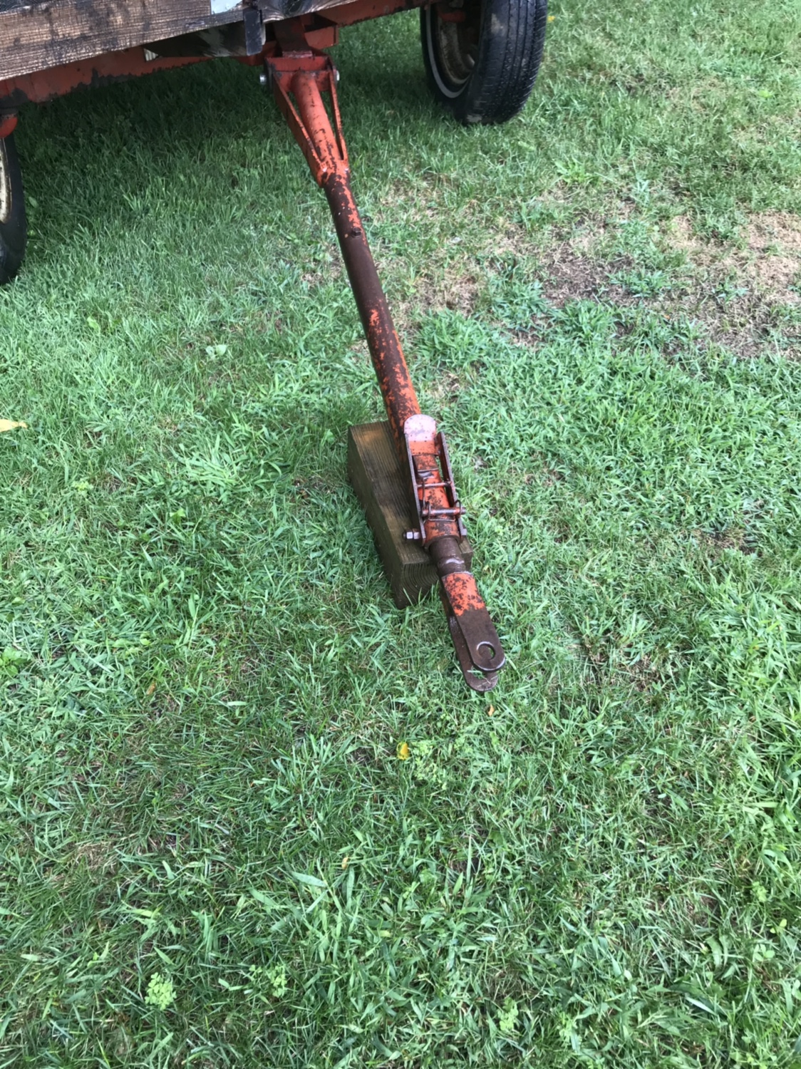

Yes, Shaneard. The tongue DOES have that feature. It's just like the extendable lower links on my tractor. I get pretty close - extend the tongue - make the hook up - back up and "clunk".
I know exactly what you mean. With the weight of the tongue - every little bit helps when making connection. The wagon has set in that spot for over six months. The tires have settled into the soft dirt. There is NO WAY I'm going to move that trailer by myself to make any adjustments. Thank goodness for that extendable tongue.

I believe the extendable tongue is std. on a Horst gear, at least I haven't ever seen one without it...
You can still buy the spring and add it to your Horst gear... I love the way mine works...

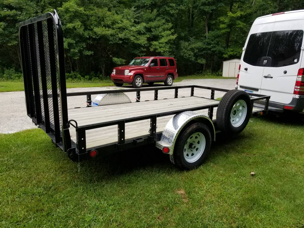

Got the PJ Trailer came with the spare tire, removable back gate and removable sides
I think it'll work great - thanks everybody for the ideas20190821_101713.jpeg
   / Utility Trailer - What type of design worked best for you. #45
Great looking trailer. I think you will really like it. Good luck with your new purchase.
