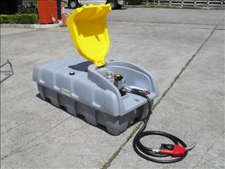

Hey guys great website. I have a fuel cube similar to picture shown 200l for the back of my ute. I currently have it lashed to a 4x4 pallet to fork it on and off.
I think I can get a bit crafty and build an all around metal frame out of RHS(box section) steel and have the poly tank surrounded with a metal frame with a lift point to lift off with a chain and a slot underneath to slide a fork under also utilising the section on top to sit a tool box of sit things on top off.
I would weld most of it together and then bolt some bits on so I can always remove the tank from the frame.
Anyone done this or got any tips? I am thinking I would use 20 x 20 mm steel.

Yes... A 3/4-1" (20-25mm) tube frame/stand/cage would be a good choice to haul/move/protect the tank..
What brand tank, capacity is that ??
Where did you get it.. ??
Good luck

the only thing I would do is "plate" the side of the frame that you would use forks on to lift it, (to protect it from puncture from the forks from the lifting machine,

Id like to see more of that fuel tank.. We dont have ones like that here. There are some that are similar, but nothing with the hatch or fittings like that one.
As to your build, a square frame should work fine. Maybe make a hook eye on the top so it can be lifted out of the back of the ute. If you look at the bulk oil cubes, they are not build with that strong a material, however they are on a metal pallet to carry the weight.

Hey gang thanks for the great feedback. Happy Gilmore, first post on a forum. It's a bit exciting. So I am an Australian farmer. Nice to see we have something you guys haven't seen lol. BHD I do have a picture in my mind. Your tip of plating the side is great I hadn't thought of that I often use the hay forks to do the lifting that's a great suggestion. Here is a link for some various tankers. Most blokes are using them in some size. Diesel Transfer Tanks I will post some pictures when I start the build

That is a nice looking fuel tank. 200l/52 US gal is a good size load. Many in the US don't know that a UTE is usually a small pickup, El Camino style. We would be interested to see pictures of yours.
It looks like the tank is made to be supported at the mold line. That may help it's longevity as it bounces in the back of your Ute. It also looks like the tank is made to direct any drips down the front. A removable capture tray would be an environmental and vehicle friendly feature.

We use similar portable fuel tanks & contain them in a modified IBC 1000lt Water Tank Cage/Frames (gives the best of everything at around $70 base cost: a pallet to fork on/off, a lifting frame for slinging, ability to weld tool tray/box into the frame & if you cut down the 1000 PVC tank to c.12inches a bunded storage area to contain spillages)
