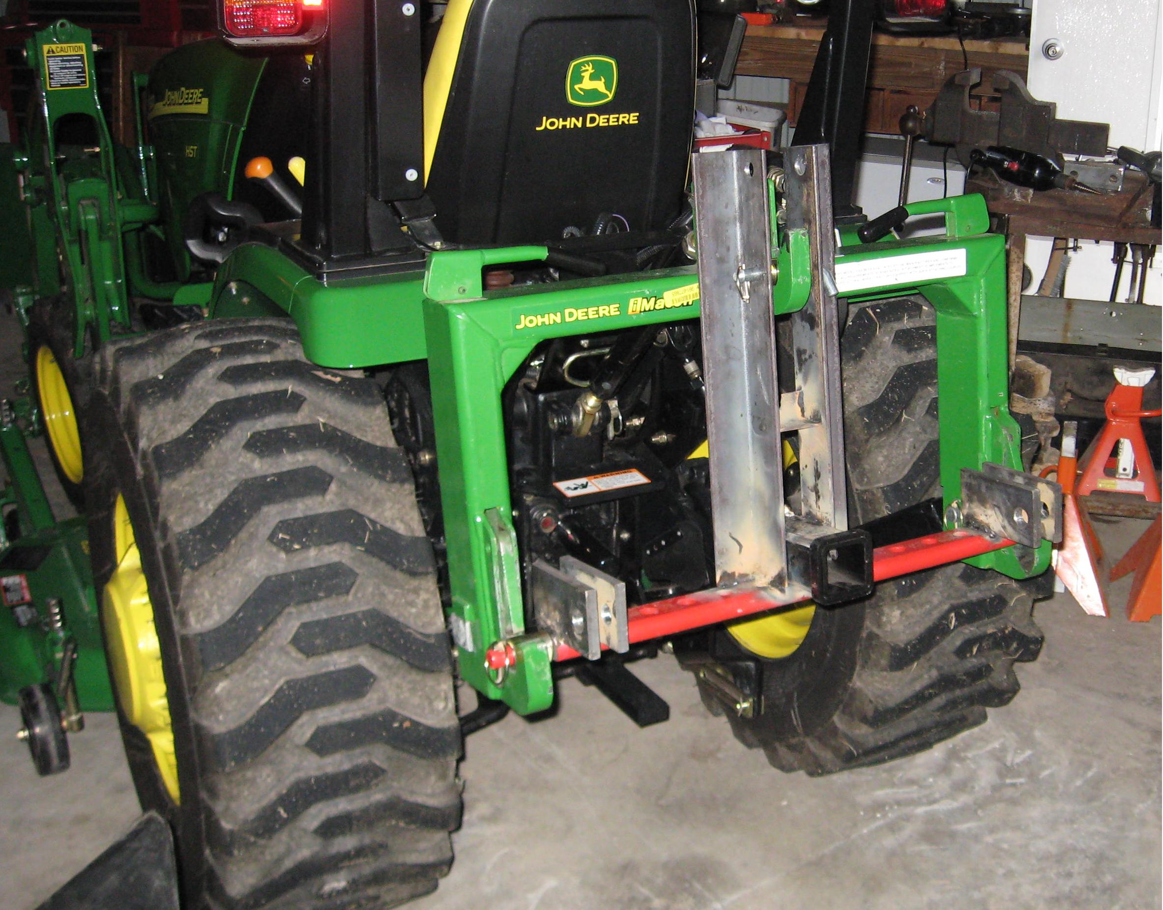

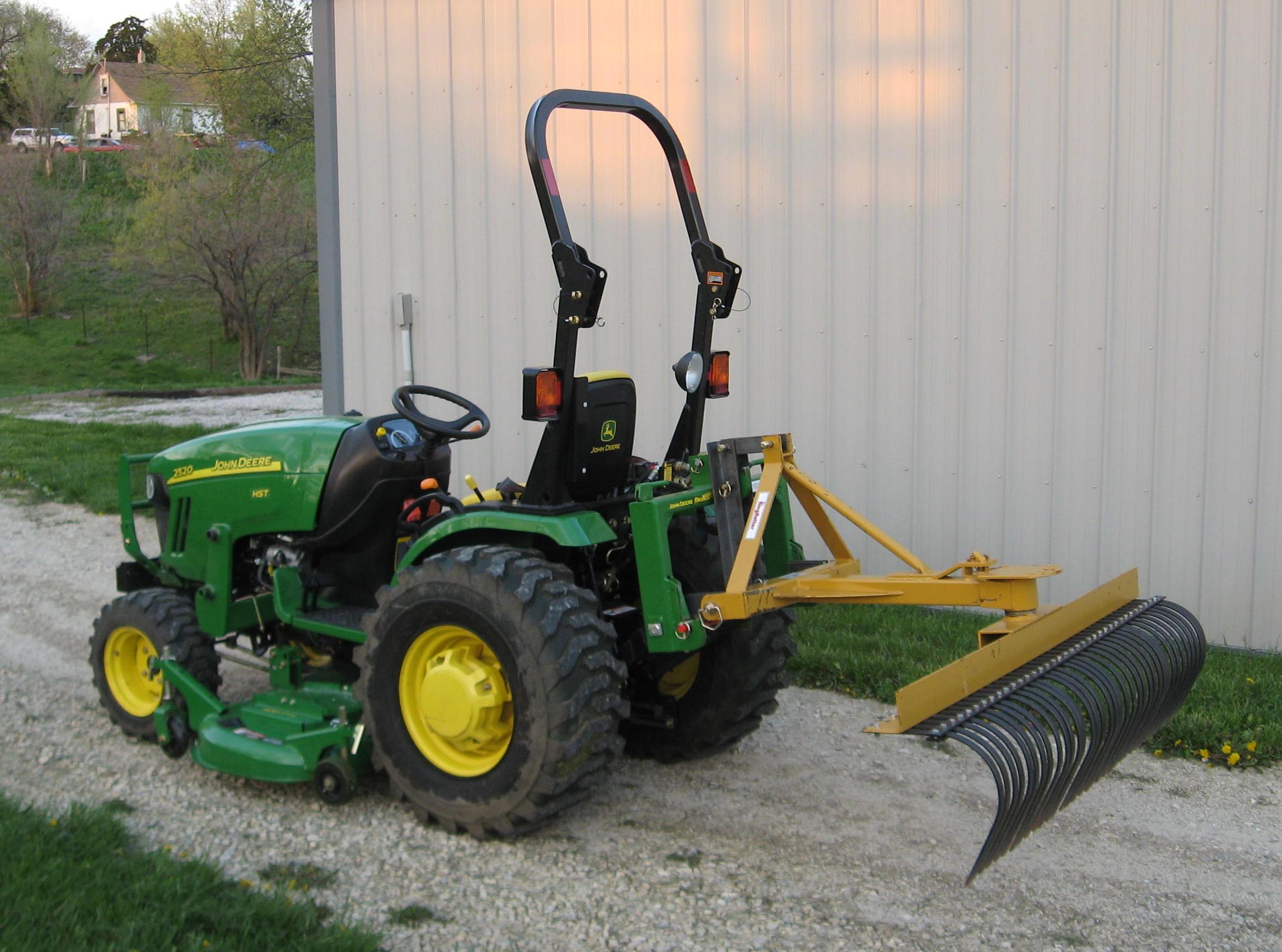

I move mine around with a three-point mounted hitch all the time. Works good for me.
Did you make this 3-pt hitch or purchase it?
Wedge
   / Using tractor to move boat/trailer around property #24
Wedge,
I made the hitch, starting with a three-point drawbar from TS. It also doubles as an adapter for a couple of non-iMatch compatible KK attachments I own.

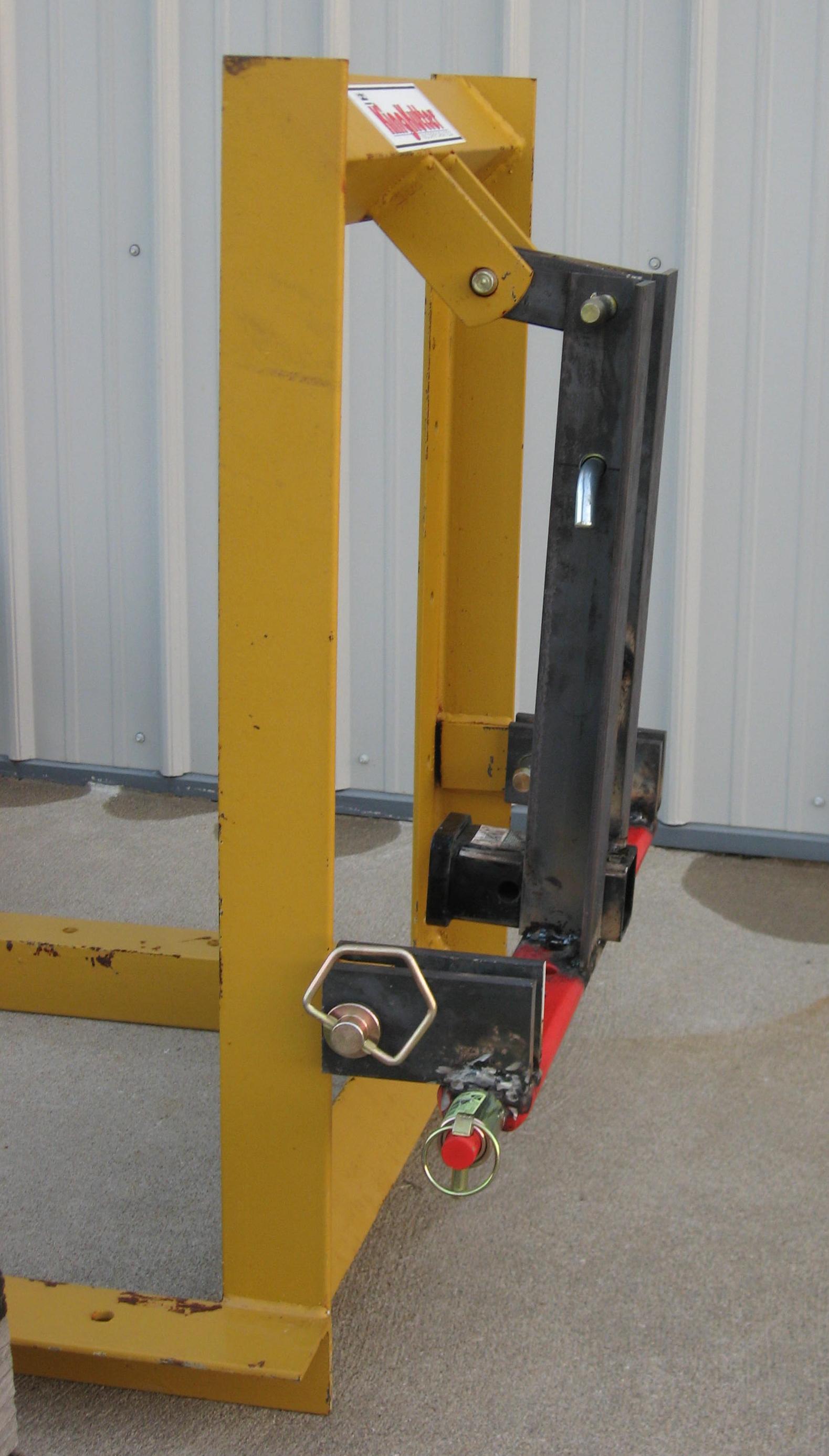

I use an Andy Tatro skid steer compatible trailer mover.
HANDY ! It has the really nice feature that it can be mounted on either side of the FEL and for maneuvering in tight quarters having it off-set to one side can be very useful.
Be careful whichever end of the tractor you use.
Back yards and driveways can be humpy bumpy and even with the hitch on the truck it is easy to plow up some grass or blacktop with the prop.
It is tempting to raise the trailer off it's tongue jack and carry it at that height, just remember that to put it on the truck it would be LOWERED from that height.
Try to keep the ball less than 18 inches from the ground at all times.
