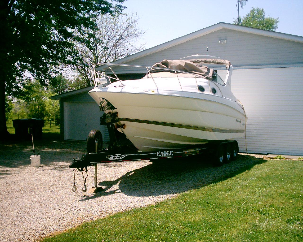

Wow! Thanks for all the responses guys!! Alot of good info here, need to sort through it all and figure out how to proceed.
Here is a picture of the boat. I can't imagine it weighs more then 2000-3000lb.

I have a very similar boat. Before I got my BX I moved the boat around the driveway with a 16hp lawn tractor. It worked, but I don't think the tractor really liked it. Most any way you move the boat with your Kubota will be an improvement over how I did it.
Matt.

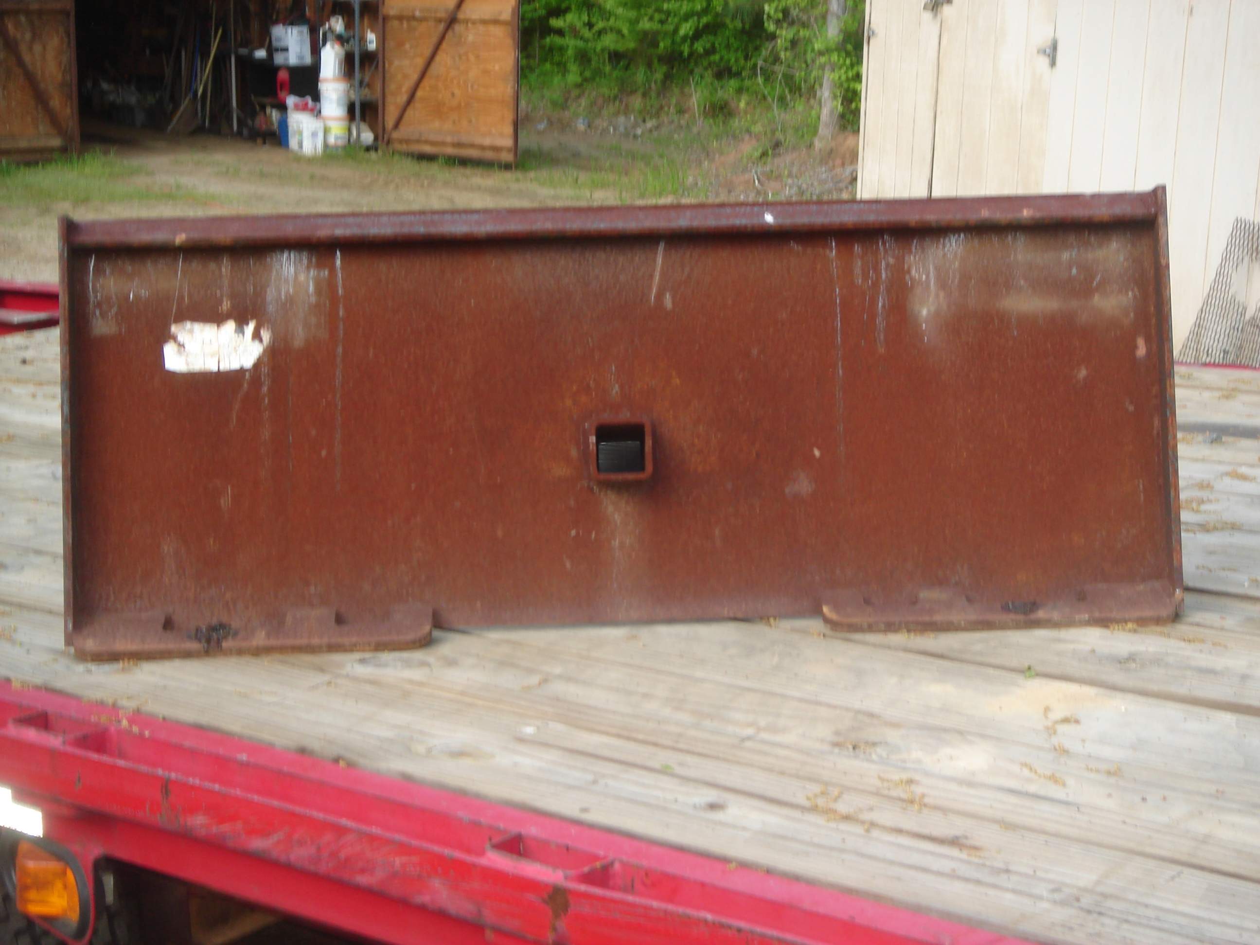

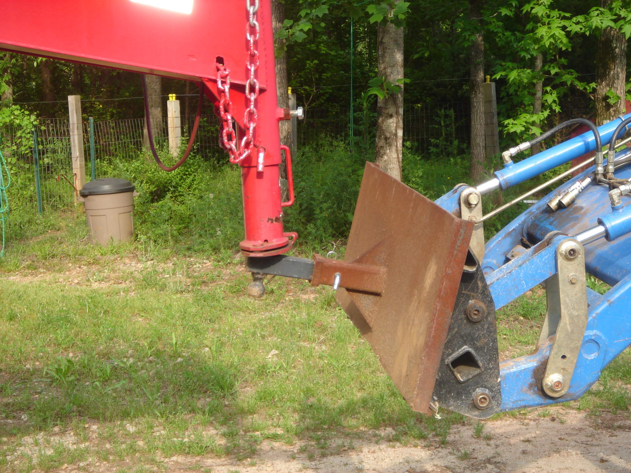

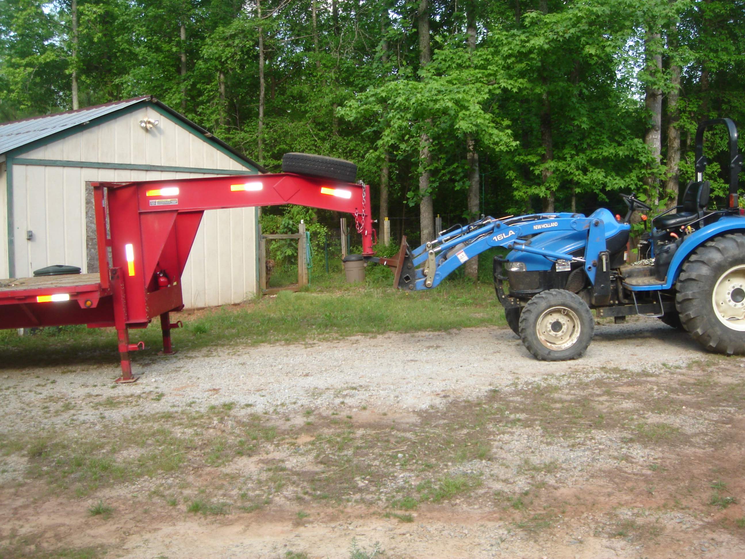

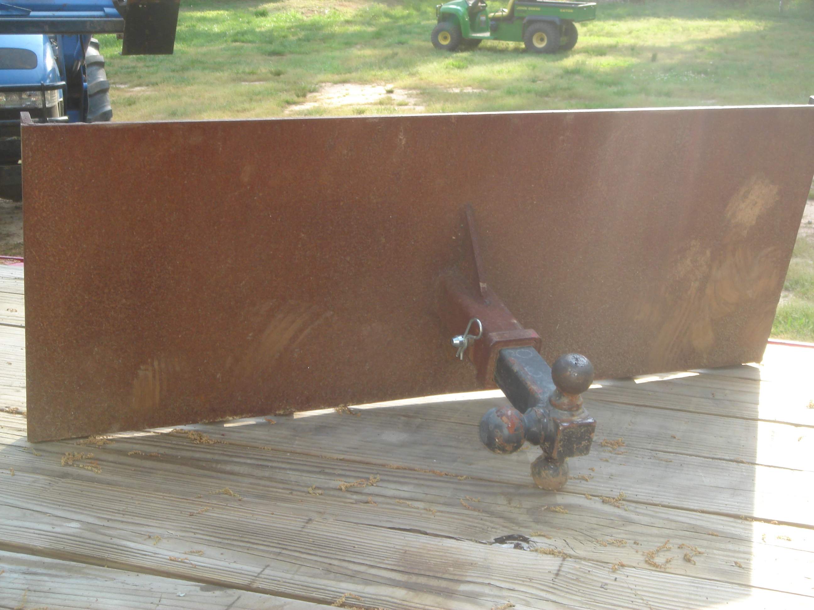

I made this with a QA plate I picked up from an auction. It works great. The pics show a gooseneck trailer, but I use it for my boat and utility trailer also. In most cases I'll have something on the back of the tractor for a counter balance. The ball mount rotates so I have all 3 ball sizes available. My tractor has R-4 tires so going across the yard is not an issue. I regret I never got it painted.
