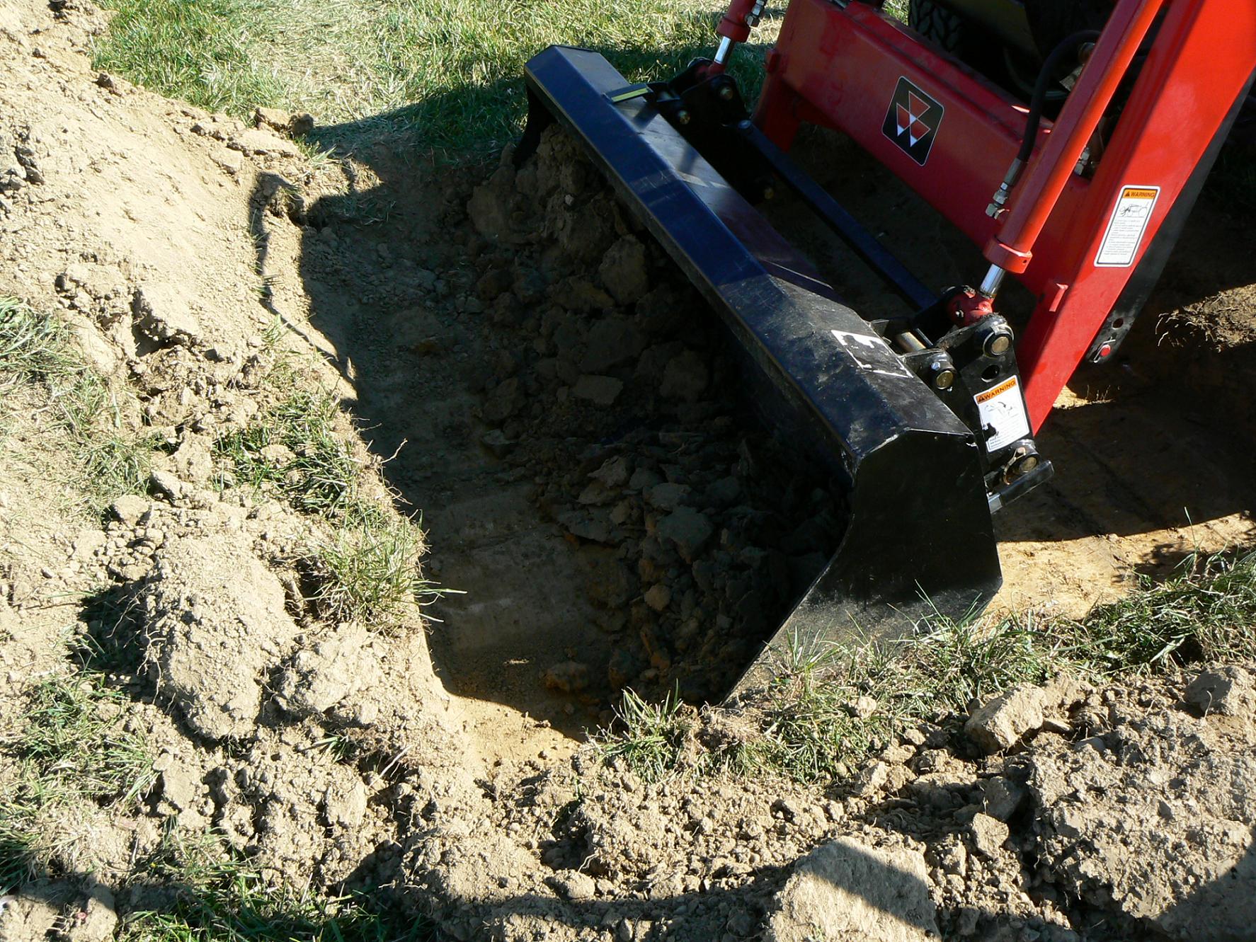

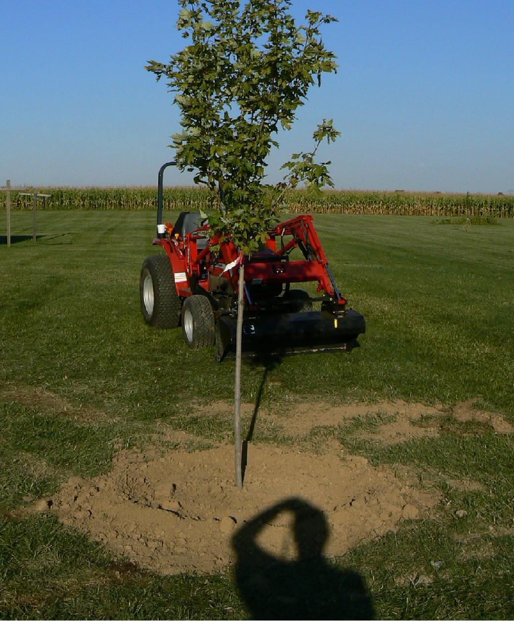

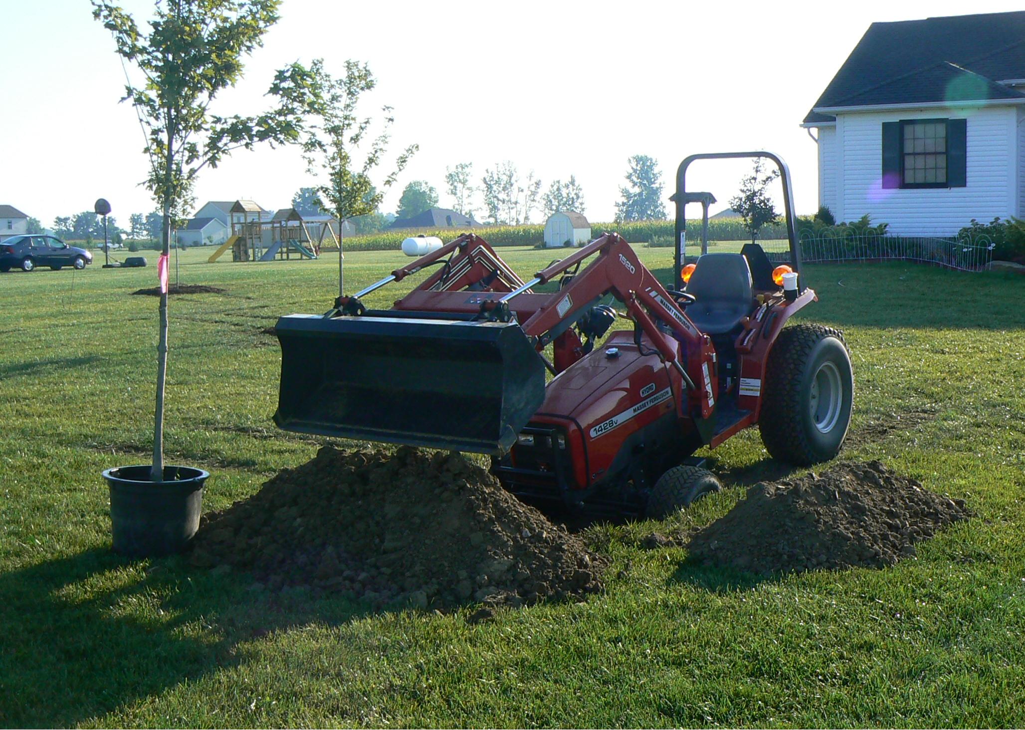

This was my first attempt at actual digging with my new (now has 85 hrs ) 1428 massey. All in all I think it did an excellent job and was impressed. The ground was so hard it was difficult to get a shovel into. Trees are Autum (sp?) Blaze maple. need shade in the front of the house in summer, hope they grow as quick as labled with out getting roots into everything like silver maple. Need to get a pic of both my tractors together.

A toothbar helps a lot with this type of FEL use.
However, you risk bending the FEL bucket and/or frame by digging in sun-baked soil.
My approach would be to break up the ground with a middle buster plow or a subsoiler and scoop out the loose dirt with the FEL.

Wow!!! Nice job!
Actually, I reckon that ground was pretty soft...you wouldn't have dug that well (especially with no toothbar), if it wasn't. Of course, that tractor weighs more then you do...so what's tough with a shovel is easier with a 2000 lb tractor.
Looks like you came in from all four directions to get that hole as squared up as you did. Looks right good, Duane!

Nice pictures and good job on the hole :D! I agree with flusher as to the wear and tear on your FEL. A toothbar in this application would really increase the efficiency of the operation. Keep watering your tree :)! Jay

A skilled patient operator can overcome alot of obsticals without damaging his equipment. Have been running loader tractors for over 30yrs, this is the first one I have ever operated with Hydrostatic drive. Much easier than slipping a hand/foot clutch while trying to operate hyd's . If you take small bites, use slow speeds and operate the tilt function as designed you will NOT bend a loader. Wish I had a video of me doing this, not bragging, but I can operate equipment, not just use it.
How I dug the hole.
The hole was only dug from two sides, reducing the wear and tare on my yard. 1st you get a decent bite with the bucket, apply slight psi from drive wheel (slooowly spinning wheels) then begin slowly working the tilt back and fouth, you will create a very uneven bottom, then you attack it from 90 deg and you can shave 1" to 2" off with very little effort, then from same direction create the uneven bottom again and move 90 deg again. NEVER do you use momentum with a loader, that is what will bend them. And YES, it was very hard ground, white compressed clay that actually developed black marks on it from spinning the tires, you cant use a hand post hole digger without spud bar. ( guess you can squeel tires on dirt, always wondered how the Duke boys did that.. LOL)

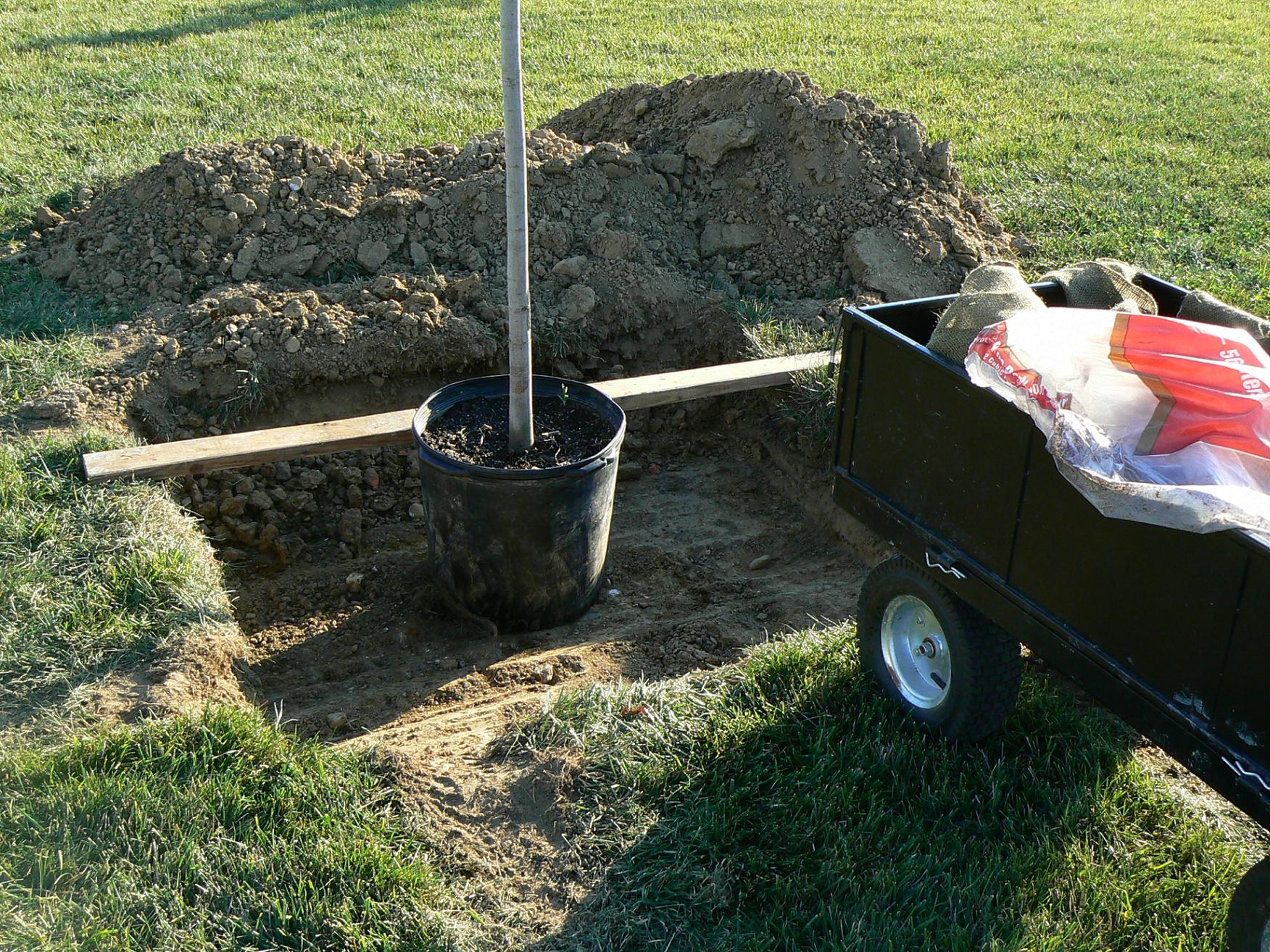

Just one comment on the tree planting...and it may be a trick of the camera.
In your last pic, it looks like the crown of the tree (top of the root ball, where the trunk meets the ground) is below the grade of your lawn. That's too deep. You want the crown three or four inches above the grade of the surrounding lawn and you want the mulch to thin out to nothing as you move from the drip ring to the trunk.
I mention this because you brought up the issue of silver maple roots growing at the surface. The biggest cause of this is trees being planted too deep.

It was a trick of the camera, but it was not 3-4 inches, more like 2-3 inches. If you look close at the pick, the top of the 2x4 is approx 1/2" below the top of the rootball, which is how I was told to plant them, I hope that is not to deep, what do you think?
You should be just fine. Just make sure you pull the backfill back away from the crown a little, so that the original potting soil is visible at the crown. You want the crown to breathe and you want those roots reaching down for water and soil instead of up. Looks like your water ring is well outside the drip line of the tree -- that's good.
One trick I got from the place I bought my trees (and it was one I remember my dad using years ago) is to bury a piece of perforated pipe vertically next to the root ball. Then when you water, you can be sure that the water is getting to the root zone where it is needed. After the tree is established, you can just fill the pipe in and it will never be noticed. I put a landscape grate over each of mine and will use them to feed and water for the next couple of years. I was also instructed to water weekly until mid-November, start again with weekly watering in March and continue through the first year. For Fall planting they suggested using no fertilizer until next Spring, then using a spike or root zone feeder.
