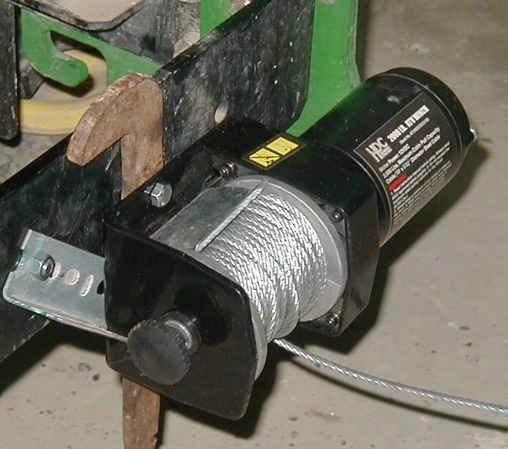

Occasionally I need to lift some heavy stuff out of the basement via the Belco permentry door. I have installed a winch on the front of the tractor.Nothing too special as its not a permament fixture, see attached.

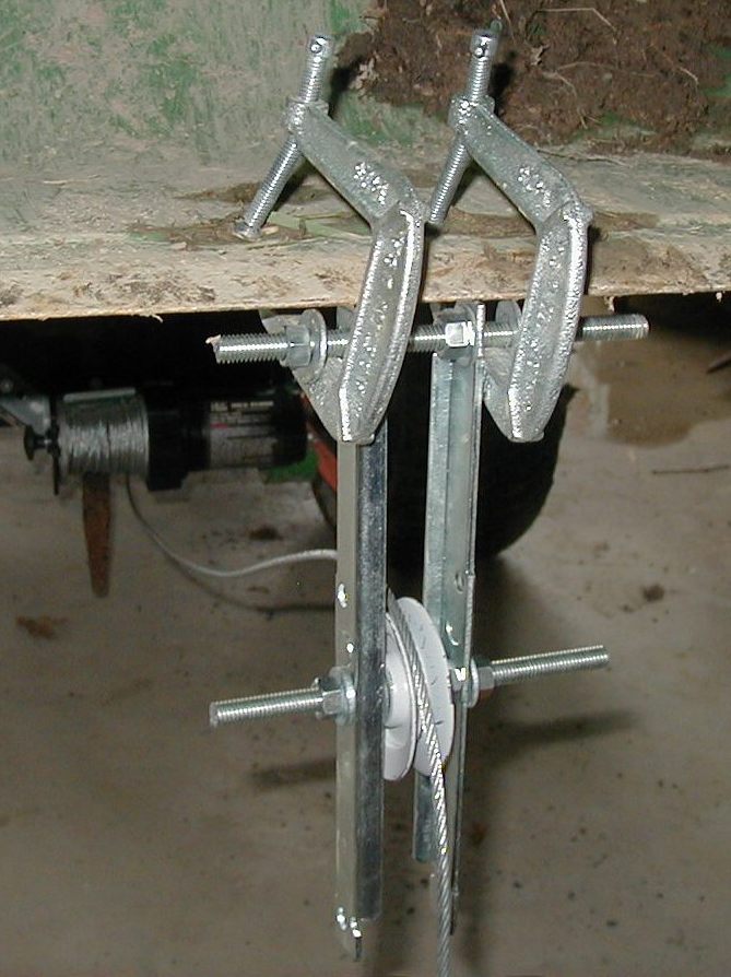

I then attached a pulley to the fel. It worked but the clamps were not robust enough. Any suggestions

How about trying to pack under the clamp as shown on the attached. If the height of the bolts taking the strain is reduced by doing this, you make it more difficult for them to bend. Might get you nowhere but maybe worth a try . . .

Might try bolting that pulley set-up directly to the bucket or use heavy duty welders clamps.

If a clamp will do the job, try a Kant Twist clamp, they're pretty stout and can't twist. /forums/images/graemlins/grin.gif

I think I read somewhere that the strain on the pulleys (and on your clamps) is more than twice the load the winch feels. How about some log chain around the loader crossbar with an eye at each side of the pulley axle? Otherwise some welding is in your future. I'd be cautious about how much load you're dealing with at the winch attachment and the pulley. I sympathize about the hoisting, as backs aren't as strong as loaders! Good luck, and let's see what you catch basement fishin'.

I'd just drill a couple ½" holes in the bucket edge and bolt your pulley to that lip.
What you have conjured up is pretty flimsy (need clamps that fit) and cannot be trusted for whatever you want to lift, nor for whatever is below it (when) the item 'drops'. /forums/images/graemlins/tongue.gif
The idea is good, and it should give you some good steady control of your lift task. /forums/images/graemlins/wink.gif
Another way, using the clamps and no holes, would be to bolt two heavy pieces of angle iron into a number "7", and hook the "7" over the bucket lip (edge) and place the clamp on the top holding the piece in the bucket tight to the bucket. Then place the axle of the pulley (it too looks too lightweight) through the bottom leg of the "7" (will need two of these to make it work like you have it shown). And you will still need clamps that fit the thickness you want to clamp.

If you've got welded hooks on your bucket, why can't you just use a chain to suspend your pulley & forget about the clamps?

I think what you are doing is an accident waiting to happen. Them clamps even with a block are not safe. Just my opinion.

I hope I did not come across as degrading what you are doing. I think you can make it work but I don't like the clamps or the pulley underneath the bucket like it is. Rig something permanent like a pully that could go over the top of your bucket even. Weld a couple of sturdy brackets on top of you bucket that you could just pin in a pulley. That way when not in use you just take the pulley out. No different then a clevace being there. Also drilling two holes in your bucket for another pulley in the front of your bucket would not be a bad thing either unless your trying to move water with your loader. But this way if a pully broke or pin broke your cable would still be tight and not free to let everything fall. Your idea works on lighter things but we tend to forget sometimes and then start adding heavier things and the next thing you know something happens and you either let something fall on top of a person or you damage something critical. Just a thought on everything and I hope you didn't take me wrong. We don't want to read about you in the safety section or the local paper.

No, not at all. My problem is that this is only an occasional use such as getting the winter cover for the pool up from the basement. and I really didnt want to spoil the bucket. Its kind of difficult to go back after you have drilled a hole.

All seriousness aside, I like your idea. I could have used that winch on many occasions. If I run across a nice pulley I will rig it to the bucket lip with a quick attach bracket and a pair of 1/2" pins or bolts. Each pin is good for ~4000#, and I can only curl ~2200#.

maybe you don't even have to bolt or attach the pulley to the tractor. why not construct a tripod made of heavy duty timbers or 4 X lumber, lash it with good strong rope or aircraft cable, and then suspend the pulley from the center with a piece of chain and let it hang down just a few inches? try to weight it down well. put this out in front of your tractor and maybe you'll never have to drill any holes on your bucket. just a thought. have a nice day, db.

Get a tow strap or a tree saver and wrap it around the FEL. Then attach the pulley with a D-Ring shackle. With a proper snatch block, this rig should be good for thousands of pounds. Your FEL will hit its limit far before the rigging. With your present "pulley" and winch attachment, I would not try to lift more than 100lbs. Even that might be a stretch. Also, I can't see all of the bolts that are holding the winch in place, but it doesn't look very secure. At the very least, upgrade your hardware to grade 5 bolts. Winch very slowly and check things periodically. Good luck!
