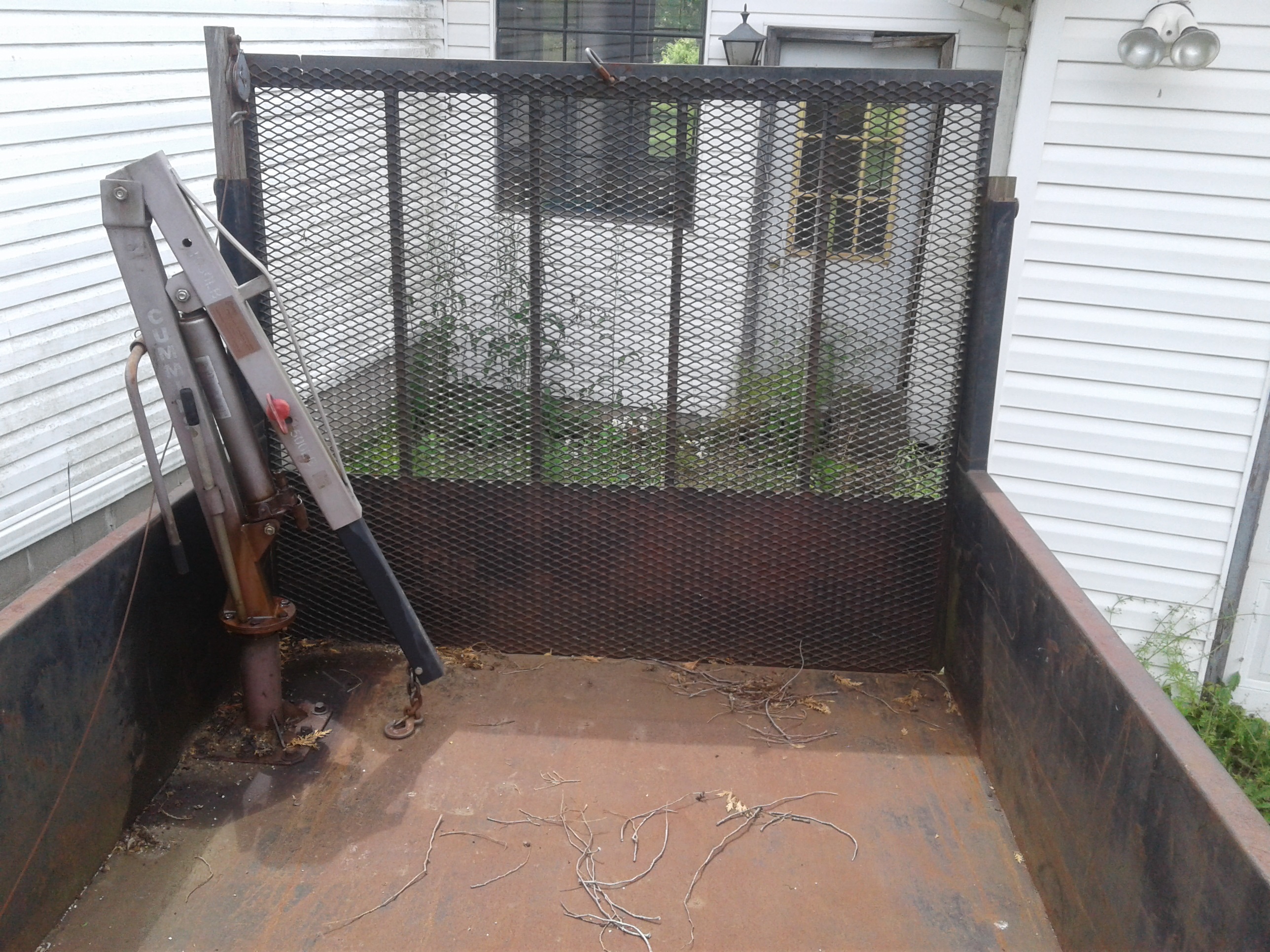

Anybody have any experience with slew gears?
I'm building a crane on my dump trailer and am trying to figure out how to make it rotate. I was going to use a chain and sprockets with a hydraulic motor but not sure if I can find one slow enough and powerful enough to swing 400 lbs about 10' out.
I'm not sure if a starter motor would do it either.
I want 360 degree rotation so I can load the truck also if need be.
I'm open to ideas.
The crane has a 1 15/16" shaft with a keyway in it.
Here is a pic of the crane as it sits right now.
thanks,
Dave

Have something similar on a dump trailer with a heavy landscape tailgate. Use lift to support gate. grab gate and walk it to side for loaded pallets. I the bearings are well greased you should be able to weld brackets on the side of the post and use a bar or pipe to turn it.

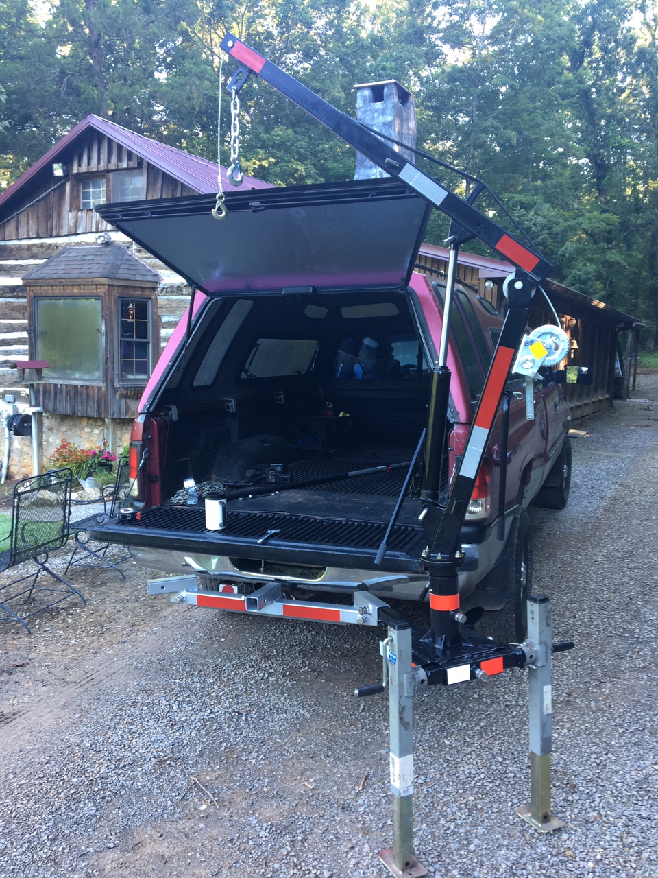

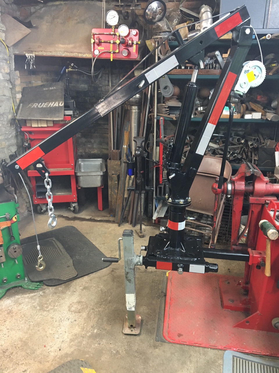

When this type of crane isn’t plumb it’s a bear. One reason for the leveling jacks. Also has a jam bolt on the base that can add friction or lock the turret in place. The base has a thick bushing on top and nice thrust bearing at the bottom. Modified to take apart to carry pieces and assemble quickly. Have a hitch on side of trailer to load too. Hitches on tractor bucket, grapple, welding table, shop support post, yardbox and anvil stand.
