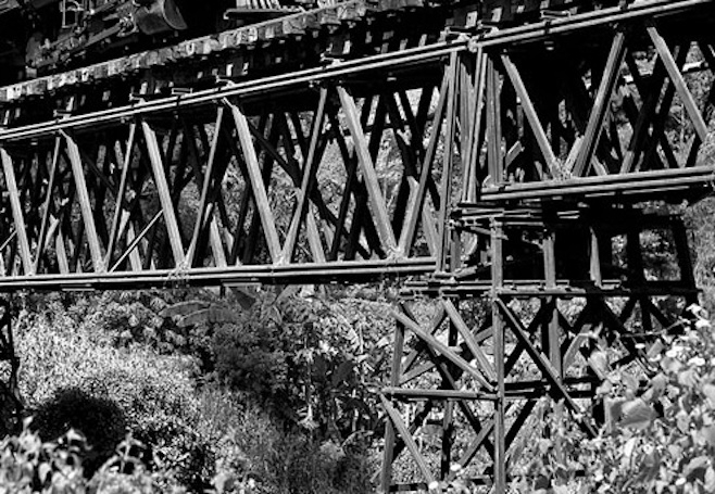

We are replacing all the 90 lb rail (90lbs/foot) at our plant with 120 lb rail to serve today's larger cars. I now have access to sticks of the 90lb rail in various lengths (most 20+ ft) at no cost. I need to build a bridge to get my Kubota M6800 across a creek on my farm. A couple of times a week I stand there and look at this rail and wonder if I can use it as the beams for a bridge to span about 20 feet. The tractor has a loader and the tires are ballasted so I'm figuring about 9,000 lbs of weight.
Has anyone used rail as bridge beams?
Thanks in advance.

There’s a reason the railroad track has supports every foot or so. It’s flexible. A semi trailer would be your cheapest option.
   / Using Railroad Track for bridge beams #10
I agree. Wrong material for the job. Beam strength comes from the vertical depth of the member, which is why the I-beam is such a popular component.

Railroad track is used for many structural applications. You need to brace the beams for lateral movement.
do You have a way to move them into place
   / Using Railroad Track for bridge beams #15
Can you post a single example of structural railroad track? And a railroad track in some more complex plan doesn’t count. Just track laying flat down as a beam like the op is planning.
