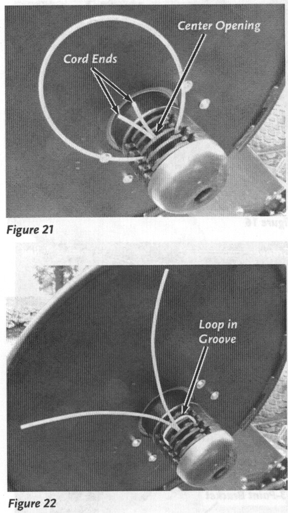

With a full season behind me I can say my opinion of this trimmer has continued to improve since I wrote the original review. The key thing has been to get it adjusted correctly. This keeps the lines out of the dirt and rocks.
One of the downsides is that if the tractor hits a bump and goes up while the arm is back (as seen below) it will angle the cutterhead down drastically and scalp around that post. This is greatly reduced if you ignore DR's recommendation and leave it locked in "transport" mode rather than putting it into "float" mode:
Aaron Z
I have yet to use or need the "float" or "pivot trimming" mode. DR's recommendation is that you lock the unit for "parallel trimming/mowing (terrain that is level with Tractor Wheels)" and use the pivot position (float) for "pivot trimming/mowing (terrain that is higher or lower than Tractor Wheels such as ditches)". Some of my fence lines are on pretty rugged terrain yet the parallel or locked mode always works fine.
It's also important to use sufficient RPM. In recent use I haven't broken any of the lines outright, and after mowing yesterday the lines show only an inch or so of wear after about a mile of cutting. This included some pretty rough brush. The idea of steel line is interesting, but the plastic is doing well enough for me that I don't think it's necessary. I did end up returning to the 0.175 line. With improved adjustments and technique I find it's probably better than the .155 line.
I'm also impressed with the strength and durability of this trimmer. I have unintentionally abused the heck out of it and it still works fine. The details would make you cringe.
The remaining shortcomings are mainly a result of using a larger tractor: I still have to be careful not to lift the unit too high so that the drive shaft doesn't make contact with the 3-point triangle. And I could use more reach, as I can't center the trimmer head in the fence line when I'm on the downhill side of the fence.
