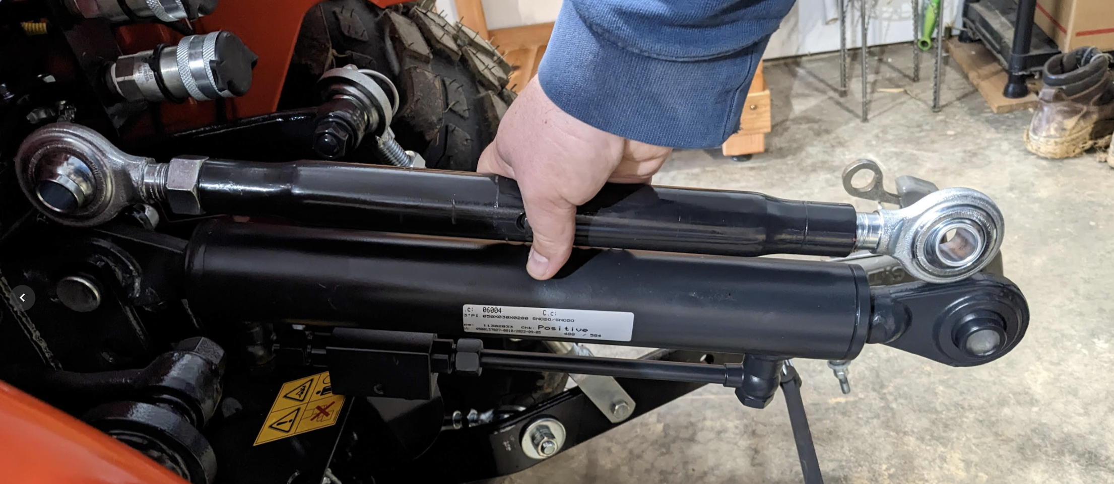

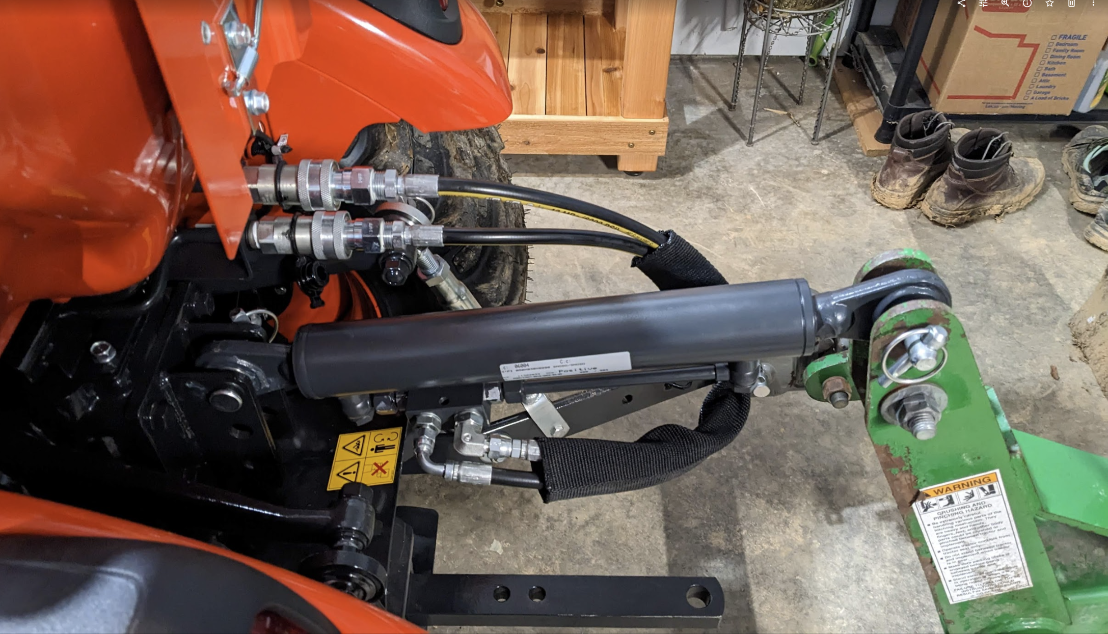

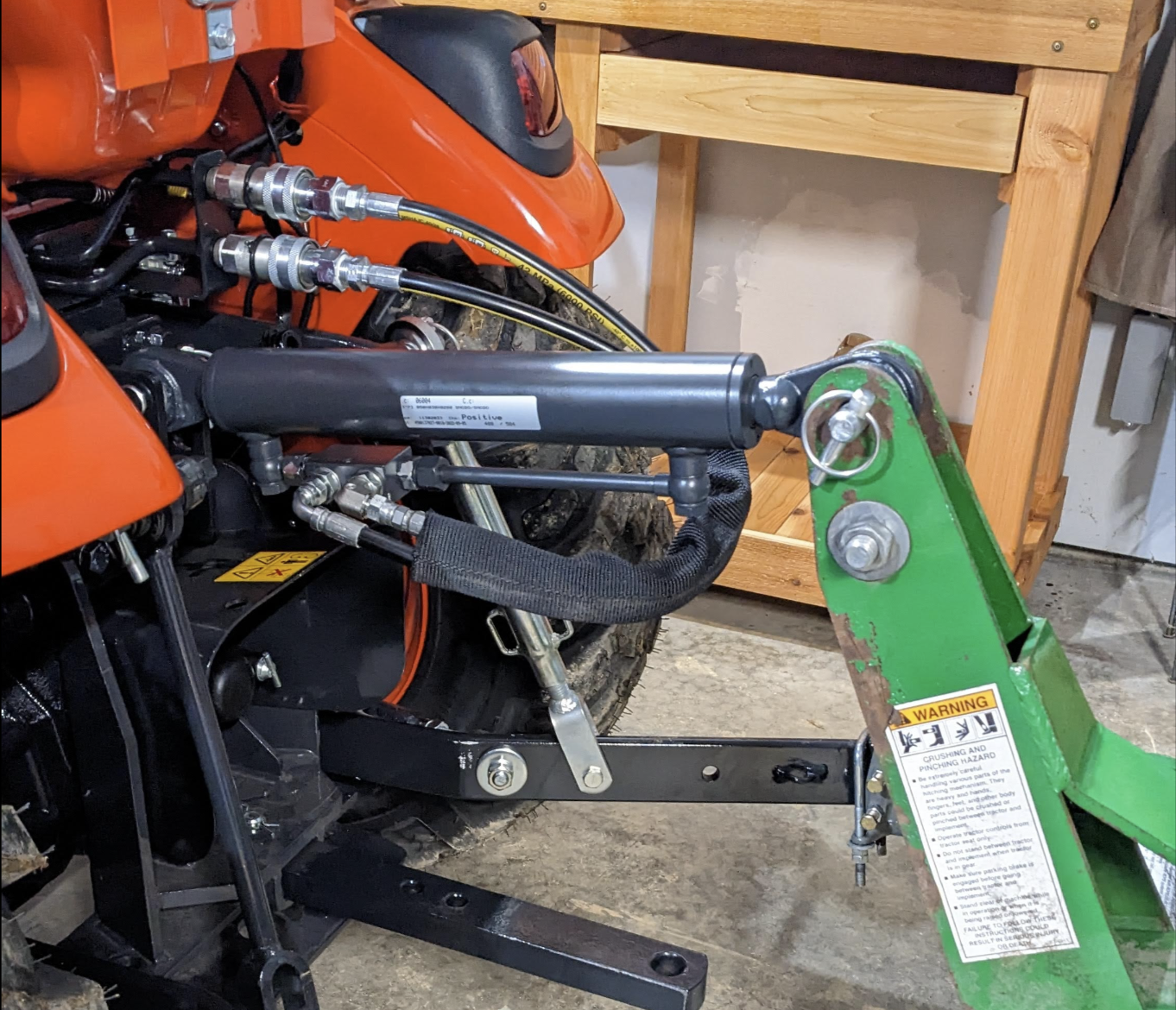

I finished my toplink and thought I'd just follow up with some info that may be helpful to others in the future.
The cylinder I chose is a 20-7/8" to 31-7/8" from Agri-Supply. I am running Pat's Easy Connect (add's 4") so not only did I need a little extra base length, I also wanted some extra stroke for boxblade smoothing with it's rear blade. I technically "lost" about an inch retracted by not using the factory toplink + Pat's, but I'm still ahead from stock range retracted (without Pat's).
Category 1 Hydraulic Top Link 20 7/8" - 31 7/8"
I had hoses made locally using 1/4" line. They didn't stock any BSPP banjo but I'm happy with this setup. One line is 27" the other 28". FYI the rear remote couplers are technically 1/2" ISO 7241-1 Series A (aka Parker 6600). This is a handy ID chart: https://www.discounthydraulichose.com/v/vspfiles/downloadables/qd_sizechart.pdf
Nice clean job , looks factory installed
