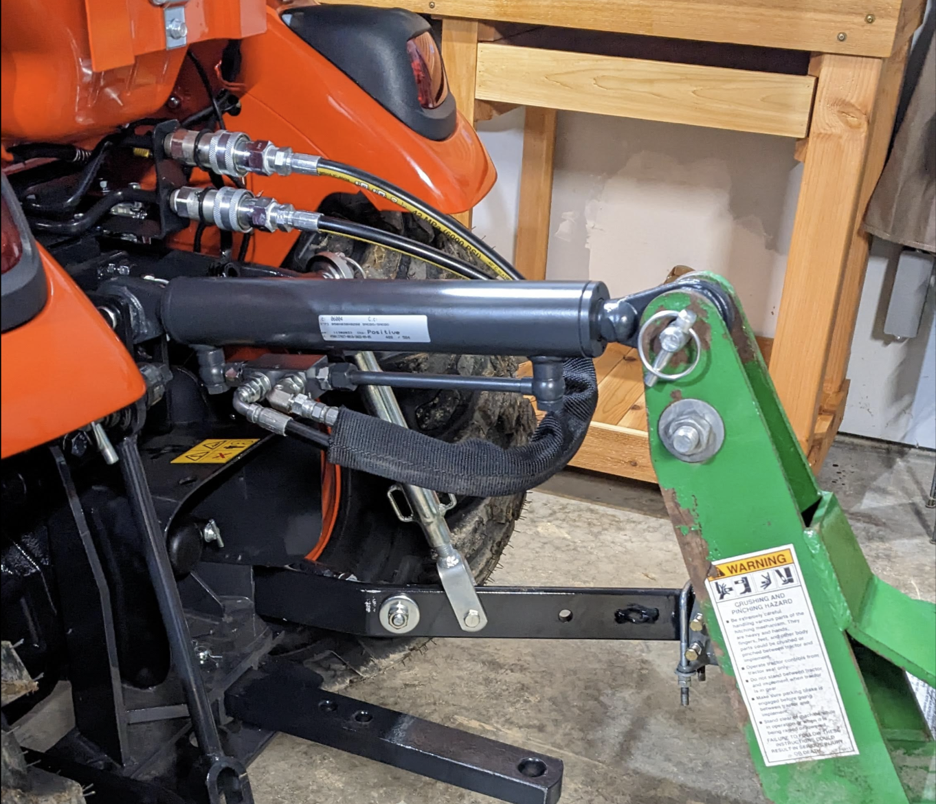

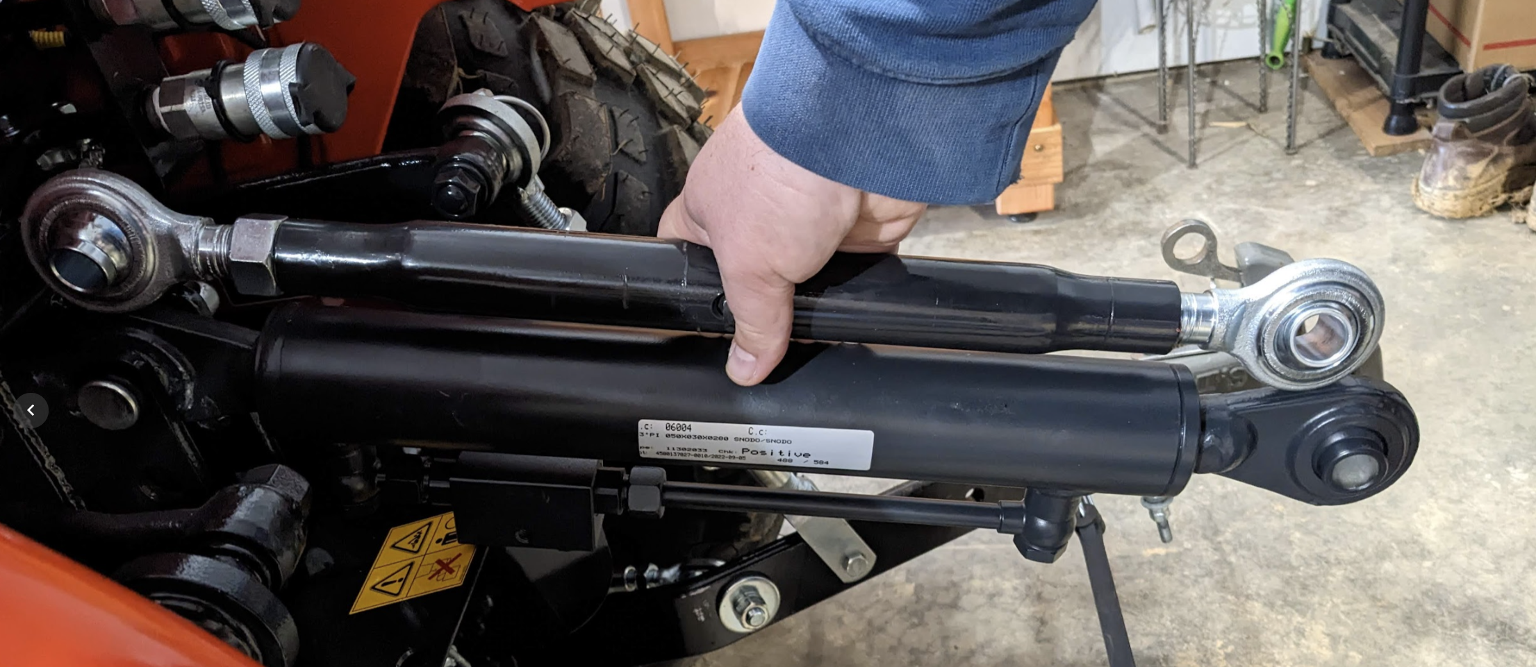

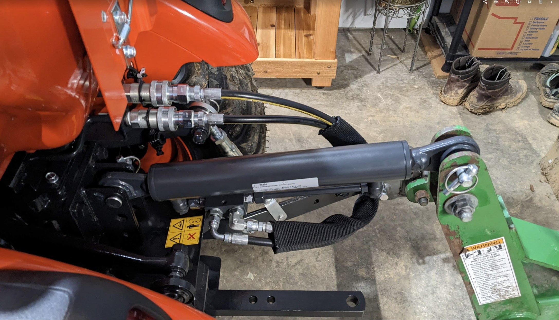

I finished my toplink and thought I'd just follow up with some info that may be helpful to others in the future.
The cylinder I chose is a 20-7/8" to 31-7/8" from Agri-Supply. I am running Pat's Easy Connect (add's 4") so not only did I need a little extra base length, I also wanted some extra stroke for boxblade smoothing with it's rear blade. I technically "lost" about an inch retracted by not using the factory toplink + Pat's, but I'm still ahead from stock range retracted (without Pat's).
Category 1 Hydraulic Top Link 20 7/8" - 31 7/8"
I had hoses made locally using 1/4" line. They didn't stock any BSPP banjo but I'm happy with this setup. One line is 27" the other 28". FYI the rear remote couplers are technically 1/2" ISO 7241-1 Series A (aka Parker 6600). This is a handy ID chart: https://www.discounthydraulichose.com/v/vspfiles/downloadables/qd_sizechart.pdf

I'm not an expert but I believe if you left the rear remote dead-headed long enough it will damage the pump eventually? Anyway as you noted it decreases performance of upstream hydraulics and anything after it won't work. (3pth) Something to keep in mind if you're trying to figure out "what that odd/different" sound is and why things aren't working as they should.
Nice job on the toplink.
