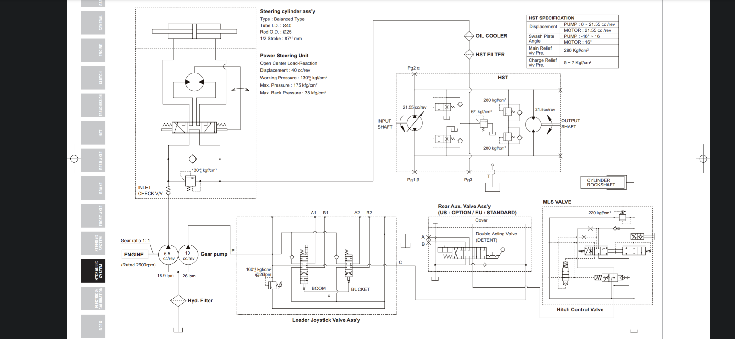

Just came across this, which I guess confirms it will return to tank, and that flow is blocked to three point unless it is centered. I suppose if backhoe is being operated they don't want it being actuated (since three point arms stay attached).
I'm actually not 100% sure if it springs to center when outside of detent... Do they normally? (Haven't taken delivery yet and I'm already buying accessories haha).
Also A and B ports are blocked at center, so do I really need the double piloted check on the cylinder?

As said above - pushing the lever all the way in either direction should cause it to hold in that position. You can feel it do so. Before you move the lever that far if you let go it should spring to center. At least I believe that's the common action for the remote option.
And unless you've got the backhoe hooked up you definitely don't want to put the lever all the way over to A or B and leave it there as you'll dead-head the system and ruin the hydraulic pump.
E.
   / Using backhoe ports for toplink on CK/CX
#11
Not saying it's good but based on the circuit above this would simply go up against the main relief, correct? Same as holding the loader valve in full extent.
