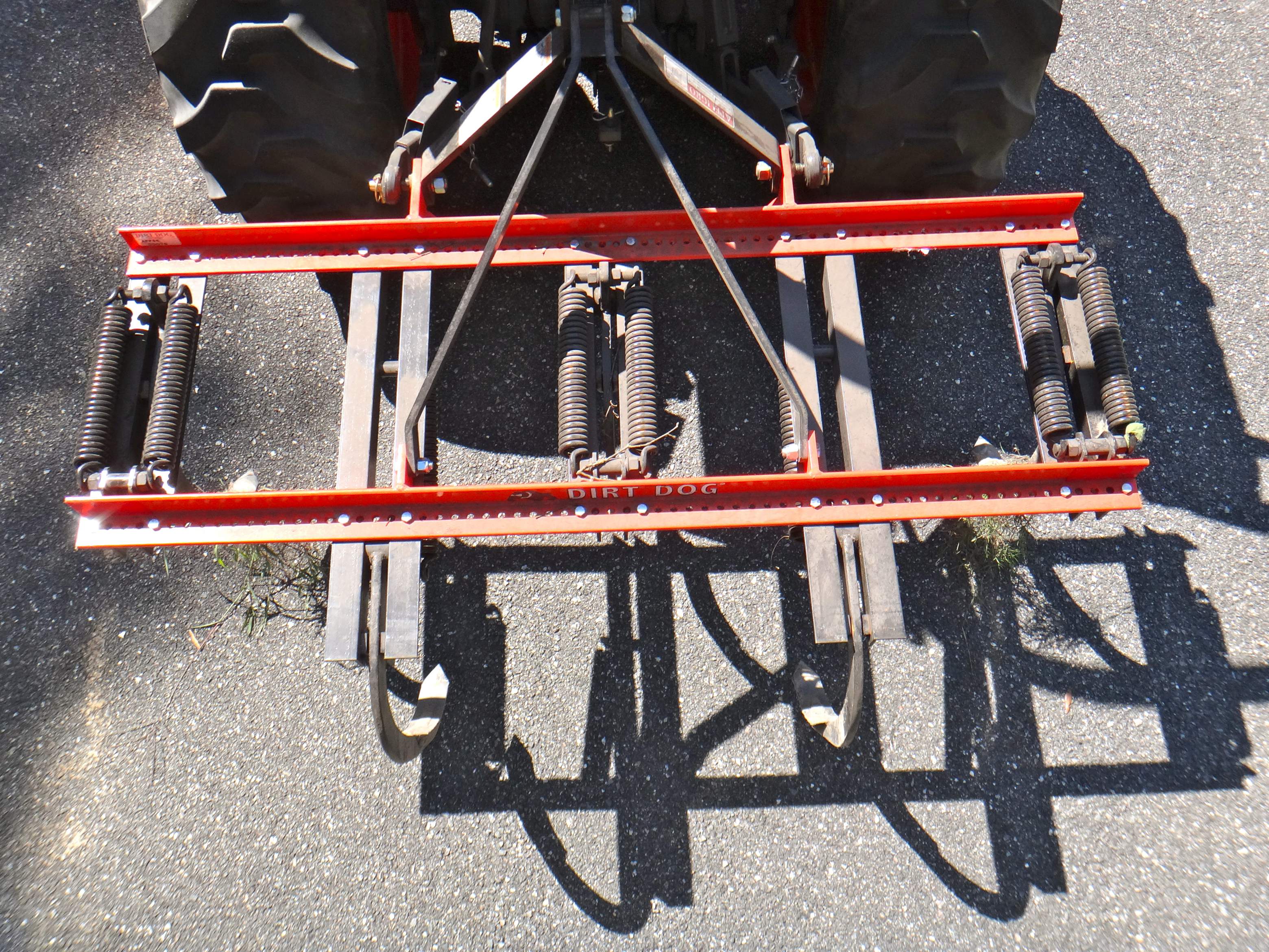

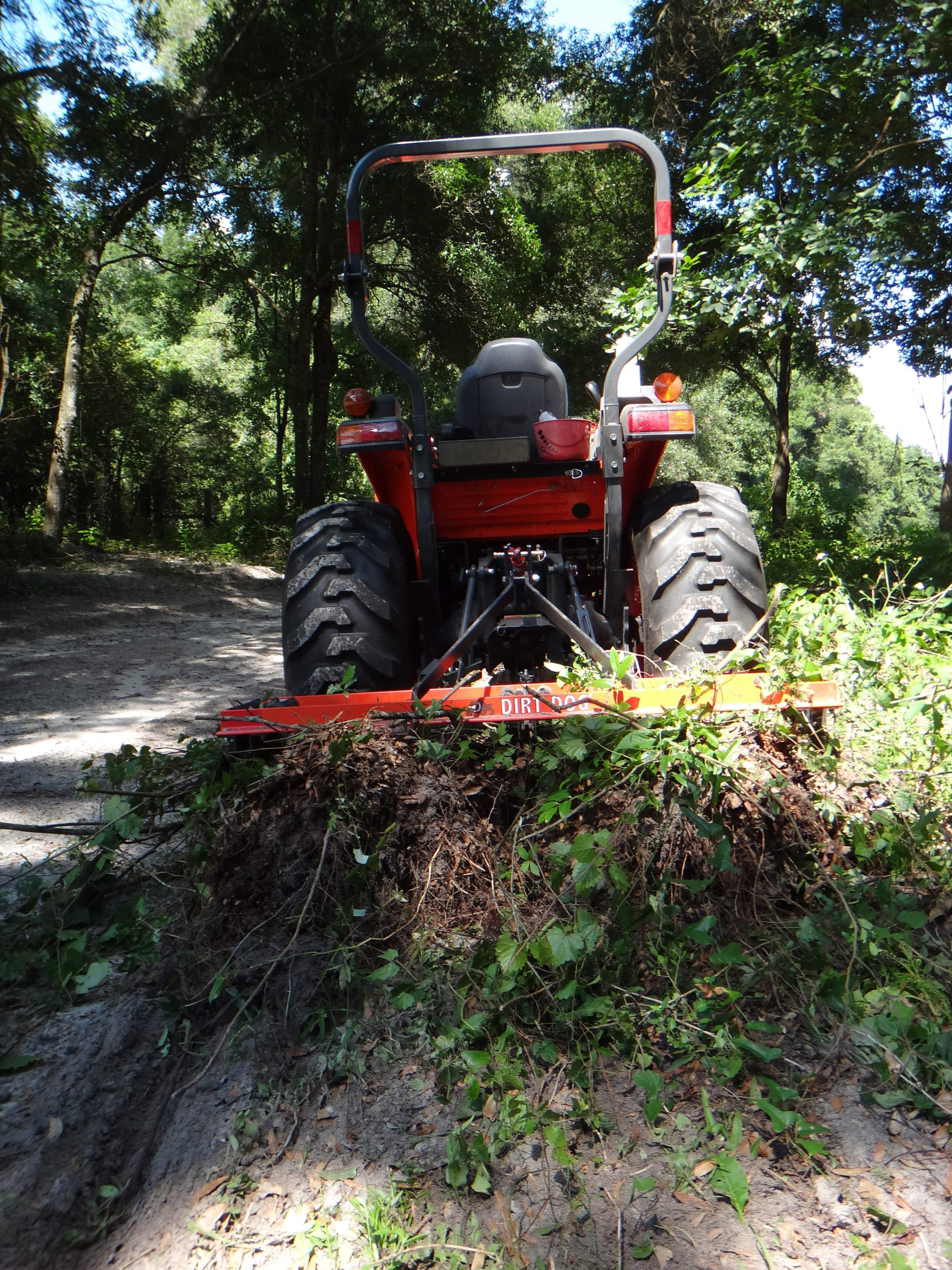

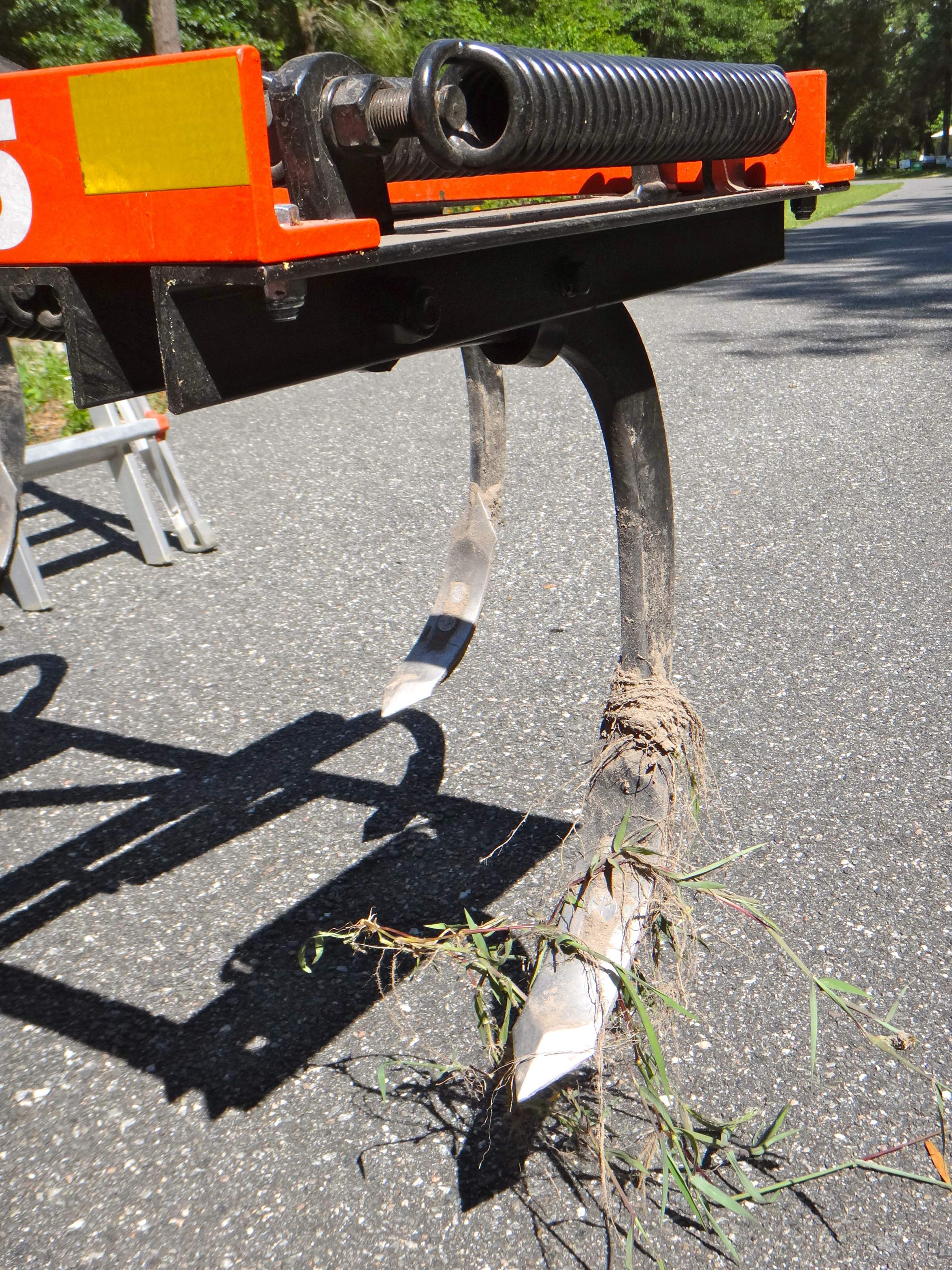

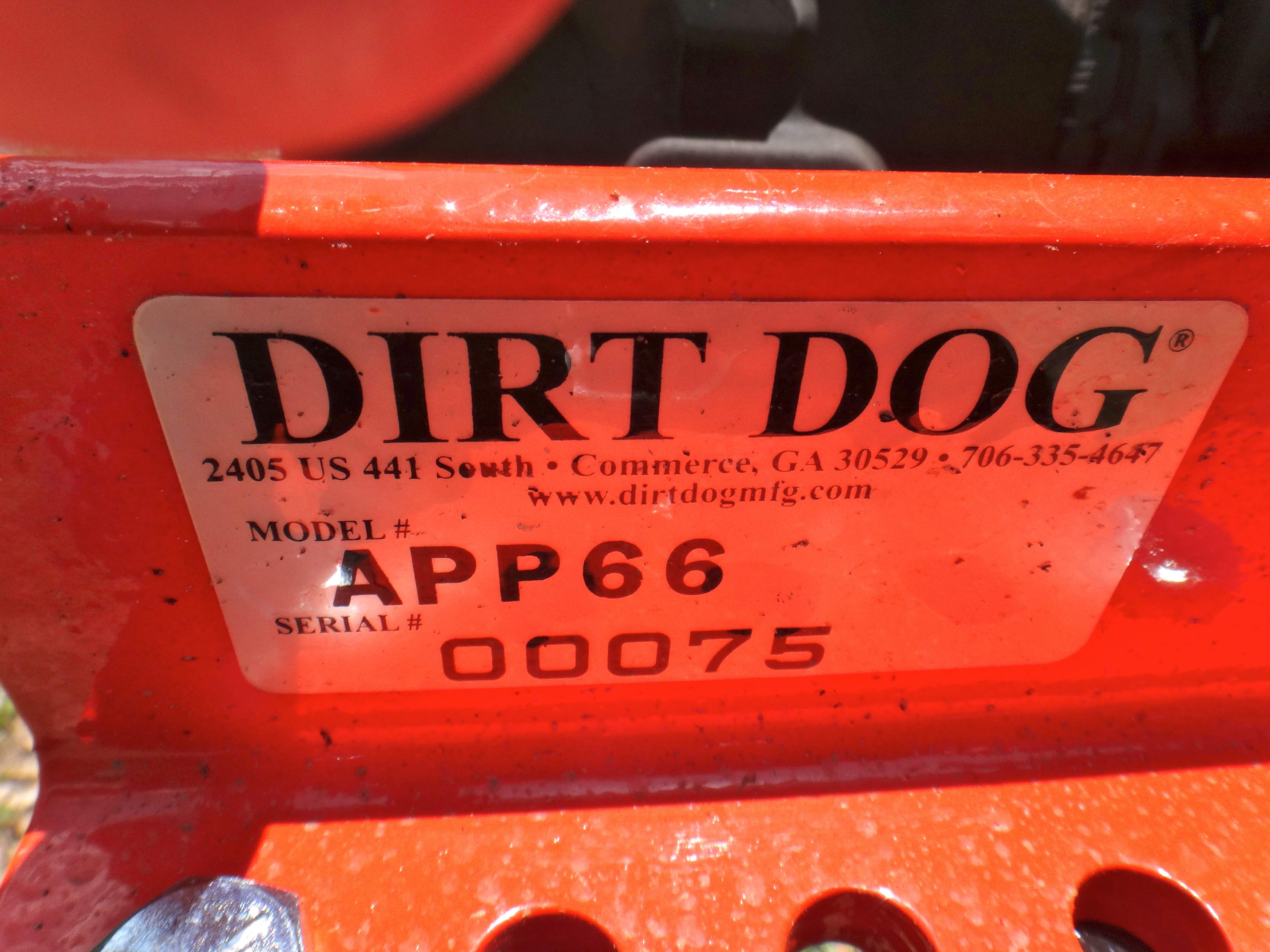

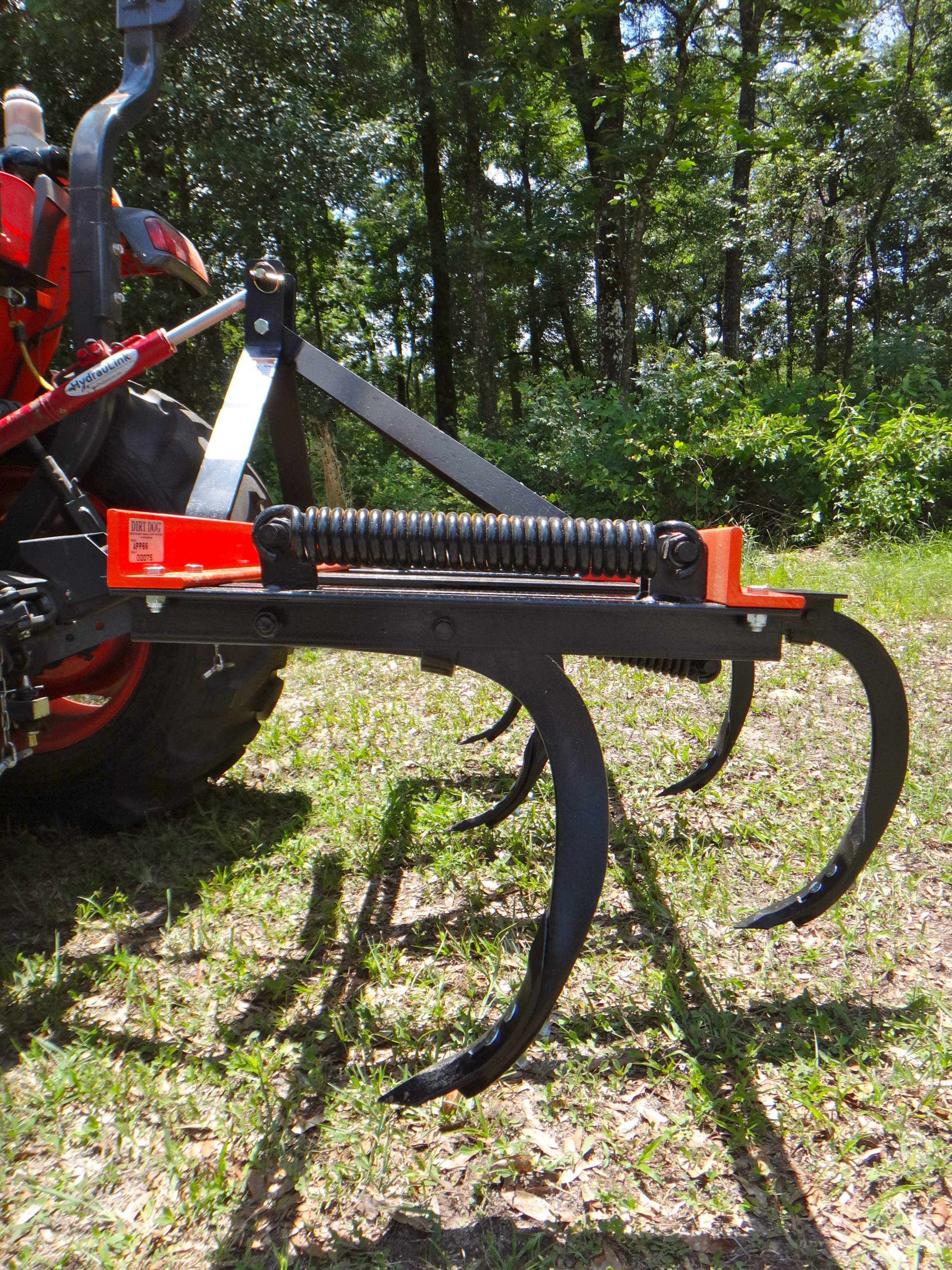

An alternative implement for pasture aerating would be a <$850 Field Cultivator. I have a Dirt Dog, five shank, which Dirt Dog terms an All-Purpose-Plow. Field Cultivators are available with many, many, shanks. Fred Cain is another producer of Field Cultivators.
I have pulled the Field Cultivator through mature Bahia grass pasture. The tines are 1/2" wide and the chisel points, which are oriented pretty much horizontally in use, are 2" X 10". I have typical Florida sandy-loam soil. This 287 pound implement penetrates 7" - 8". The parabolic shaped shanks draw tines into the ground.
The Bahia likes aeration. It springs back vigorously.
I do not have a picture of the FC in Bahia. Here is a photo, taken today, of FC tearing out wild grape vines by the roots.
