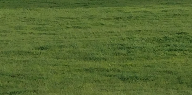

pretty much same boat here, we bought an old connor shea disc drill that needed work ( rodents had ruined the seed cups and they needed replacing) we use that for small sowing ( under 3 hectares) , for large jobs we still get the contractor to do it,
this is 6 weeks in, you can just see the oversewn grass coming through,

see above post for example of oversowing from on existing pasture, you can faintly make out the new seed on the lighter green lines coming through.
