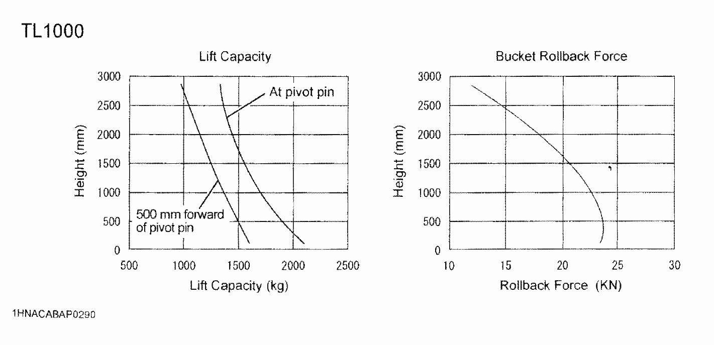

I have l some limited experience with Both Kubota and Mahindra Loaders. Kubota 364, 514, 723 & my own TL-1000, Mahindra tractors My Max 28, Neigbor's 2555, and a 5000 series utility tractor while haying.
Kubota Loaders seem to do well for their spec at ground level. Mahindra I think goes for the big numbers in their specs, but performance at ground level is no much more than Kuboa. Again limited experience.

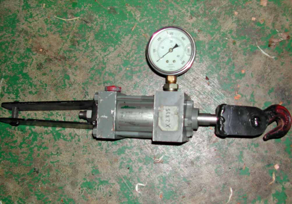

Shop around for a crane scale for your weight range.
Wow, those scales have sure come down since I built my hydraulic dangle-scale. I looked
at the time and there was nothing acceptable for under $100 as you have shown now.
Anyway, I bought a small new hyd tierod cylinder, and filled only the rod side with oil. A 600psi
glycerin-filled gauge and a grabber hook were the only other items purchased. I spent about
$40 total.
I welded up a connector to dangle from my FEL's chain hook. The grabber hook works with
all my chains. To calibrate it, I suspended a known weight, and figured the scale factor I
needed.
Works great.
As others have pointed out, using the FEL's boom cyl pressure as a scale is impractical as
the weight you are measuring has to be at the same point fore-aft and the loader at the
same height, on level ground. And the FEL's bucket curl has to be in the same position. There
are a lot of conditions!
/ using a pressure guage as a scale. #53
