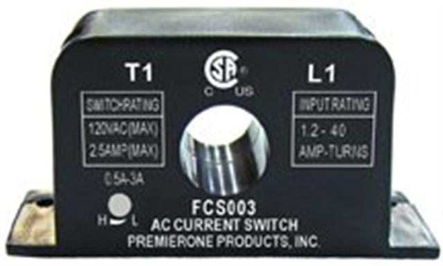

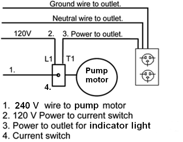

I wanted an indicator light for my deep well pump, a light wired on the pressure switch shows the pump should be running. The AC current switch that I used shows that the pump is running.
Found it on eBay.
The wiring diagram.

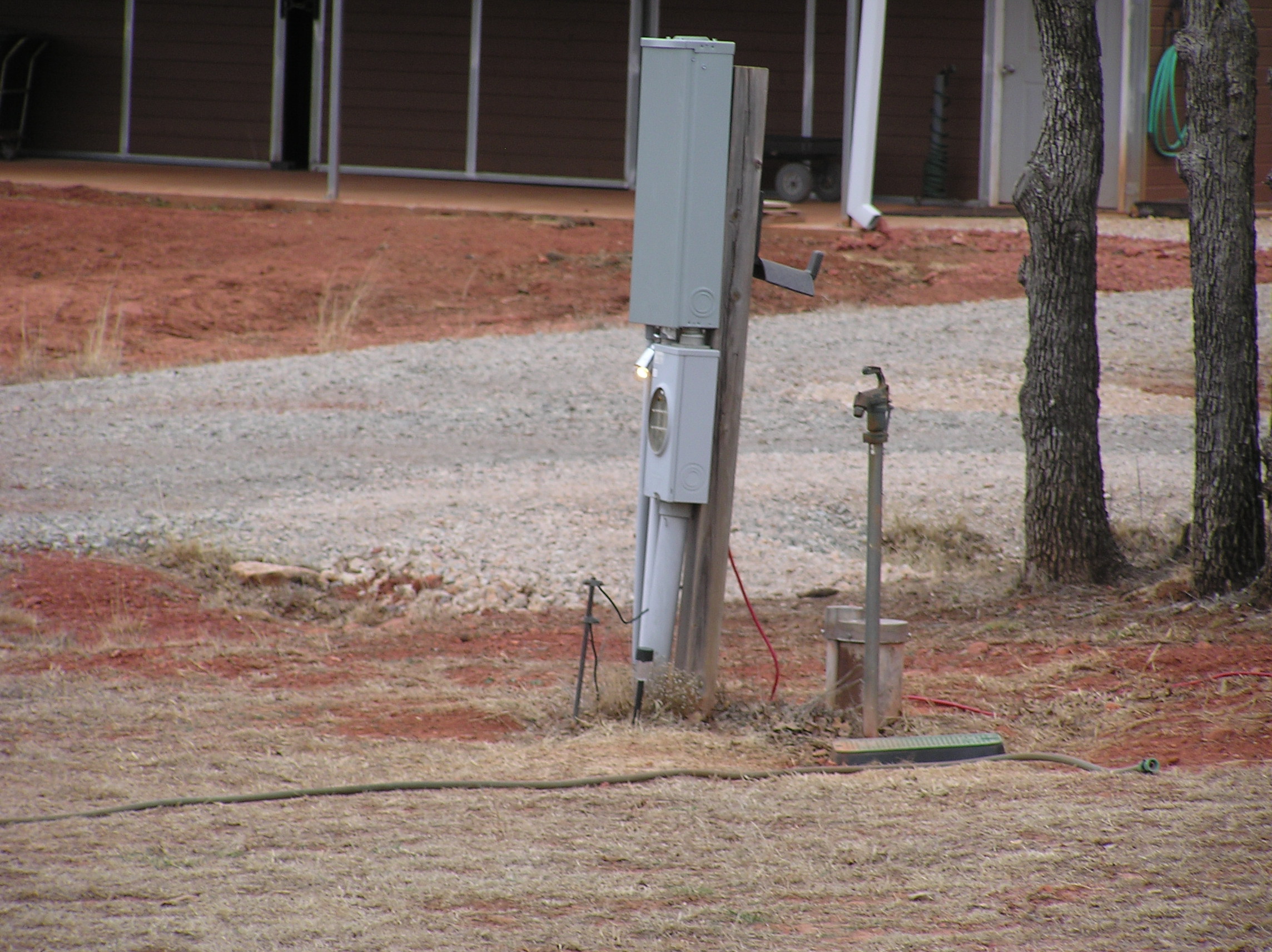

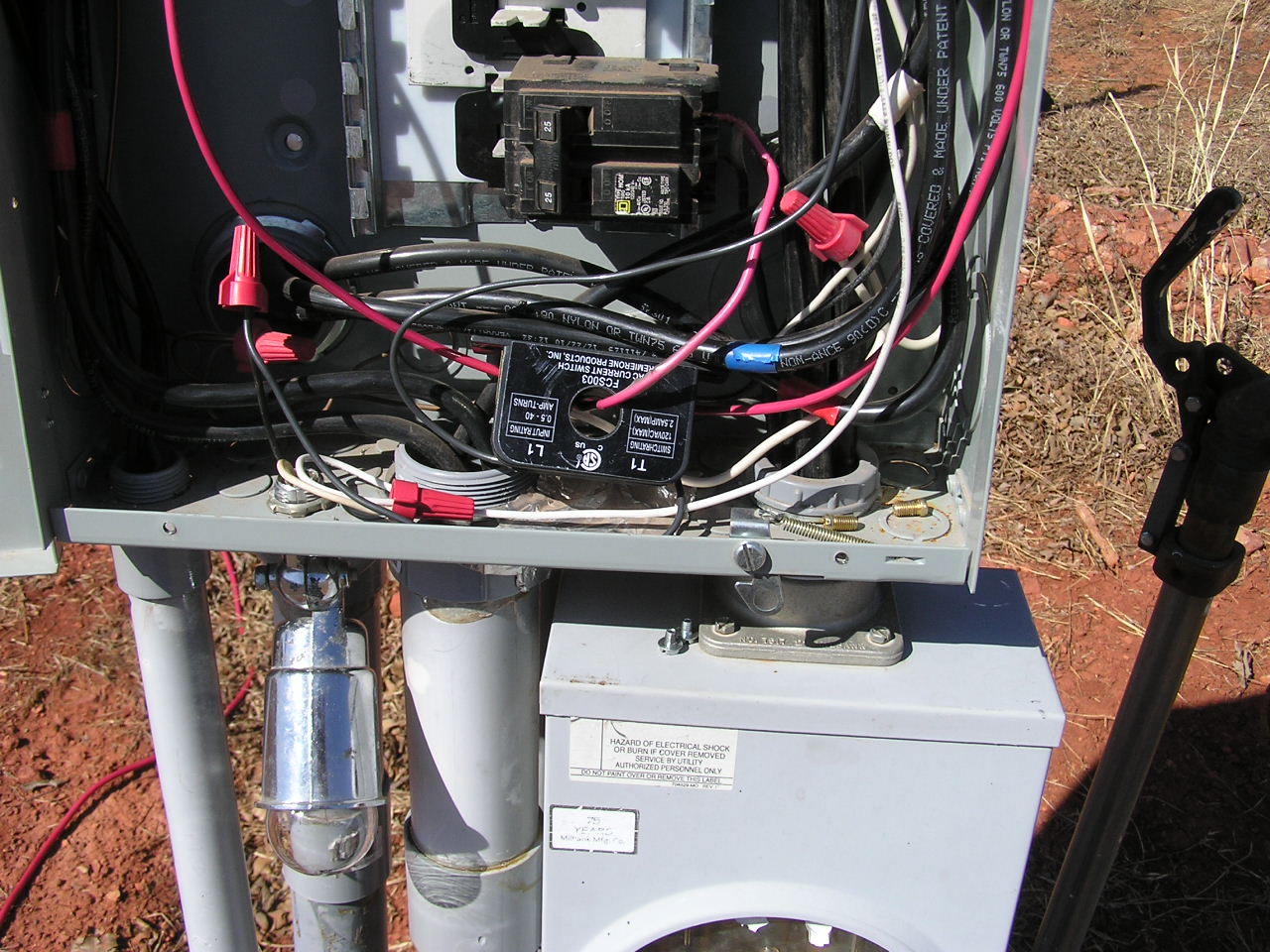

Installed in the breaker box at the well, about 50' from the house.

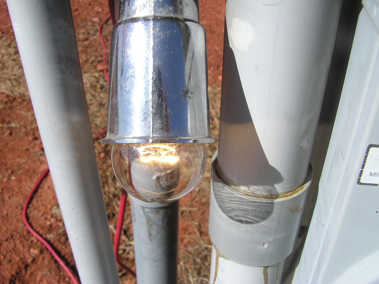

I now use an 11 watt Sign Light, visible from the house.
Installed it last March, the small investment is worth the peace of mind knowing all the outside faucets are off and the toilet valves and flappers aren't leaking.

so it just senses the current when it starts to flow on either leg of the 220 and switches on a separate circuit?
   / Using a LED light on a Well Pump (glowing) #15
It only senses the leg that runs through the hole in the switch. Normally on 220VAC, there will be current in both at the same time.
It also works for sensing 120VAC current.
The switch contacts are rated at 2.5 amp.
