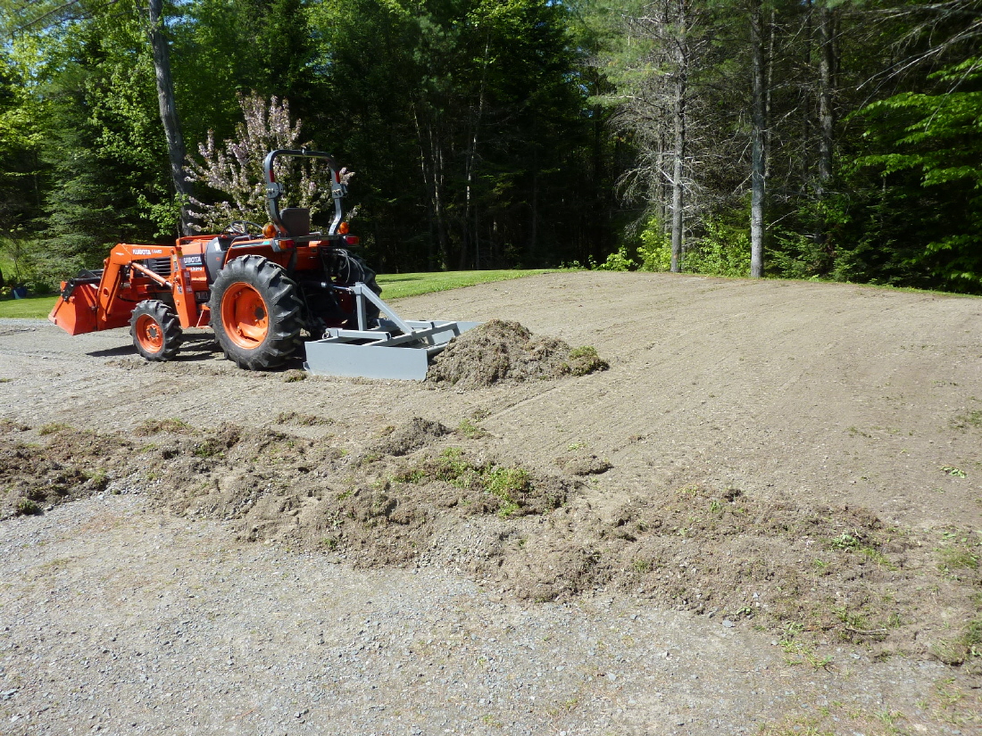

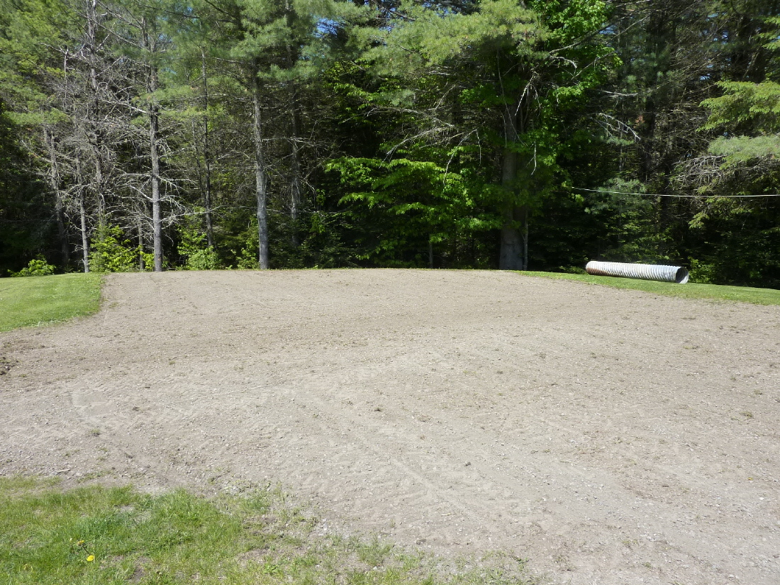

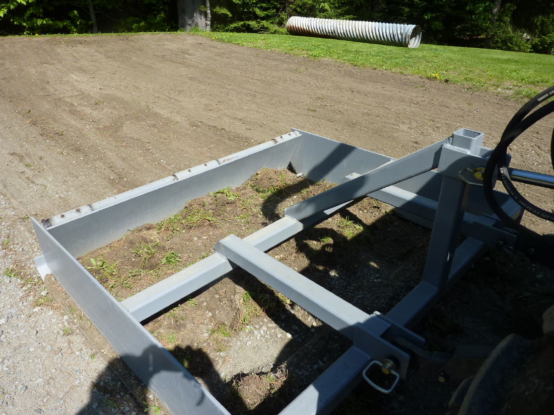

I have never tried my LPGS on a lawn per se but I do use it to remove sod in the drive and parking spots. It does like you say - shave off the tops. So some roots are left but it takes a few years to grow back. Here is a sequence of pics doing my door yard parking. Before to After:
Edit: LPGS is 5' wide and about 650 lbs. Straight blades down 3/4"
