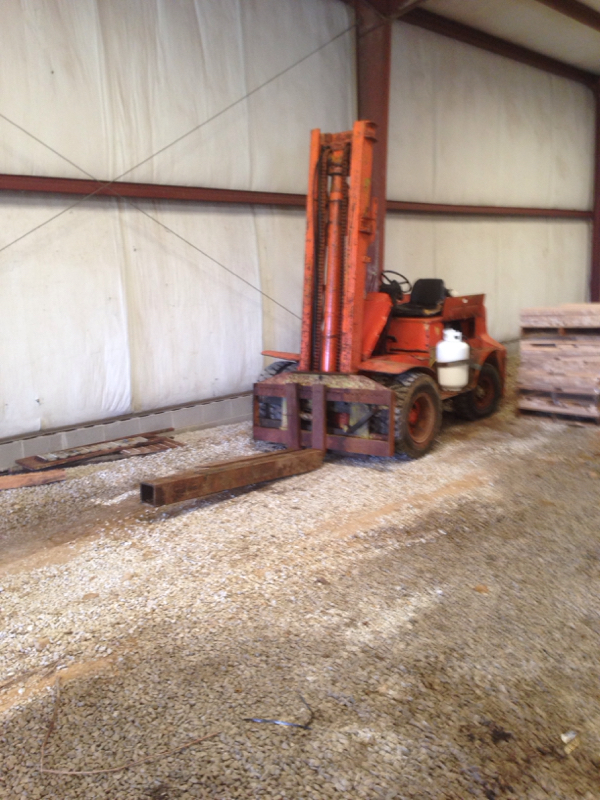

I think my yellow forklift pictured above is quite a bit bigger than your Clark. It weighs 11,800 pounds. It doesn't go at all off pavement. My Cat pictured above holding a trackhoe bucket weighs a similar amount, but has taller tires. It goes decent at best on gravels and bone dry dirt. My 3rd forklift goes pretty good on firm surfaces. If you could drive a pickup over it without leaving a rut it will usually go. image-818336012.jpg

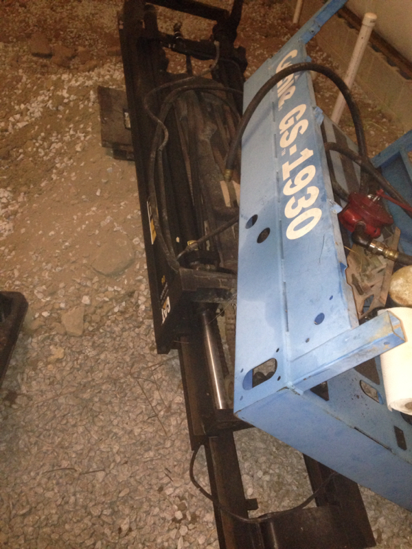

I have a mast off a 4,000 pound capacity lift. I have contemplated attaching it to my Kubota. Like you I want a solid mount and not the 3 point hitch. The backhoe 4 point subframe would be perfect, but I haven't figured out how to get it on it. It relies on the backhoe hydraulics to get it lifted up and attached. Edit. Factoring in some guess work and the hydraulic pressure of my tractor this mast would be capable of lifting over 8000 pounds.

Your forklift pictured here is a LOT bigger than my Clark. It would be nice, but I don't have anyplace large enough to store something that size. When I bought the Clark, I could have gotten a large off road with a diesel engine that would probably have been a better deal, but it was too big to even fit in my garage and I skipped it. Only spending $550 was more palatable to my wife, even though she will comment on my "junk" when I buy cheap and have problems. I like your barn even better than the forklift. I miss my 36 x 45 Morton pole barn I had 12 years ago in Ohio. I keep downsizing. From there I went to a 30 x 40 pole barn, and now as I am planning for retirement, I have a 24 x 32 garage to use for my shop. Oh well, it will be paid for so I can afford to retire and have fun with what I do have room for.

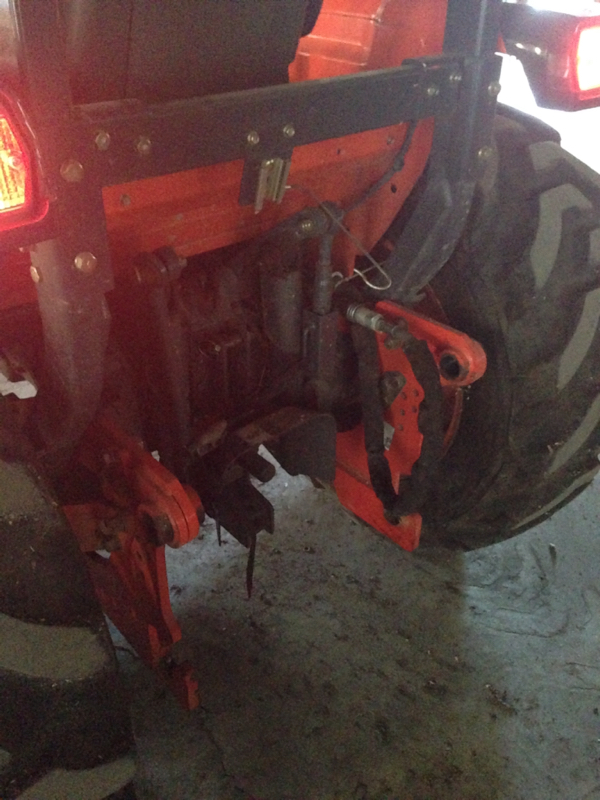

The mast you show is probably similar to mine, but I suspect it is a lot newer. The tractor you show looks like your L series tractor, not the B7100. It is nice to have live hydraulics at the back. If I can install the mast on the back of the B6100, I am sure I will be limited to about 1,000 pounds of lifting, just to keep from picking up the front or screwing up the tires. It would be a little trial and error to see what I could carry. I suspect that 1,000 lift capacity would be plenty for most of what I would use it for anyway. I am going to try and do some measurements on my mast and see if with a little help, I can come up with an approximate weight, and then find out if anyone has any idea of how much a Kubota backhoe that went on the B6100 actually weights. this would be a starting point for my trying to mount it as a lift on the back of the tractor, instead of getting rid of it or making it into a log splitter. The log splitter is probably my last option, based on the comment so far, and would only be to show my wife that the money was not a complete waste. I hate to get rid of anything that works, which is why I need a larger barn. Once I retire, I hope to put in a couple of hundred feet of concrete retaining wall on a logging trail behind my house. It cuts up the hill behind us and would give me access to the back half of our property where I would like to build a larger barn. On the lower property, I can't put anymore than I already have. I am less worried about the hydraulics on the B6100 than the mounting itself. I have the PTO hydraulic pump that runs the backhoe. I have the front pump that operates the FEL, and I have the internal hydraulics. If one of those doesn't work, then I just get the appropriate pump and controls to operate off the PTO, like the current pump. There is no mounting on it. Just a bracket to keep it from spinning. Other than that, is just mounts to the PTO. That would not be too hard to go with a different option. The B6100 has three different PTO speeds (could be 4, but I think it is 3 - I have never used anything but the lowest speed). I replaced the FEL controls a while back, and went with three controls to give me an extra if I wanted to install a grapple. I haven't, and it would not control the mast anyway, since I would need four. That just means time on eBay and Craigslist to find one at a reasonable prices. That assumes that I could use the current FEL hydraulics, which would be nice, or I can upgrade that pump to one that would work for both the lift and FEL. The FEL doesn't go very fast and it would be nice to have more volume anyway. Good luck with your project. I would like to hear more and see pictures if you are able to get it mounted on your Kubota and get it all working. I have a smaller tractor, but I suspect the information would still help me.

It's extremely unlikely the mast will ever be mounted on my Kubota. With the house finished I have a lot less need to lift stuff heavier then my FEL will lift and I have projects in line ahead of that. It doesn't hurt to dream up plans and I like to keep junk. I have a second and maybe a 3rd forklift mast laying around but that's the nicest one. I've also got a 6 way blade that came off a trencher. It'd be fun to do something with that.
I would mount that with a triangle of at least 1/2" steel for each side welded to the mast so it goes on one side of the lower pin for the backhoe 4 point, then a 2nd piece of steel offset so it goes on the other side. The triangle needs to be long enough that you can mount a cylinder to the top pin holes for the 4 point.
