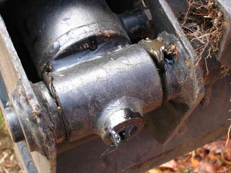

The zerks are well protected with steel rings just as Dargo points out. The issue is that those protective rings become filled with compacted soil resembling concrete so you need to dig them out with a screwdriver then clean them before greasing (all with the bucket raised to eye level and curled. Not the easiest thing to do when doing routine greasing of the tractor. What I really don't understand though is that the zerks (at least on my WRLong bucket) could just as easily have been placed in a location that would have been relatively free of dirt contamination and would be accessible from the backside with the bucket on the ground. Maybe there is a reason for having zerks in that location but it didn't seem necessary to me.

I just did a complete greasing of my machines yesterday. My LB-115 has over 50 fittings. What you do is keep a small screwdriver and a roll of paper towels with you and a trash can. Pick the packed dirt & grease out and wipe the screwdriver clean throwing your paper towels in the trash can. Make sure you wipe the zerk off completely before you grease, or you'll end up pumping dirt particles in your zerks then into your bearings or kingpins.

I'm gonna have to disagree. If the protected zerks were on the backside rather than the bottom then dirt compaction would be much less of an issue for starters and they would be easier to clean and grease.
When I backdrag I typically have the bucket tilted down a bit and mostly keep the dirt under the bucket not climbing up the back of the bucket as I reverse. Some dirt gets in yes but not under pressure like it would with the zerks on the bottom.
To clean and grease the zerks in the current location, you really need to start the tractor and move the FEL up and down. THat is an extra step that wastes time and might encourage "forgetting" to grease the hidden zerks.
I do exactly as you do with regard to cleaning and greasing but it does take extra time and requires that I drop the grease gun while I spend several minutes cleaning out the zerk spaces.
My point is that it should not be any more difficult to place the protected zerk 90 degrees from where it is on the fitting so it can be reached from the back of the bucket while the bucket is in normal rest position on the ground. No difference in production cost.
I just don't understand why the zerk on the bottom seems to be the industry standard.

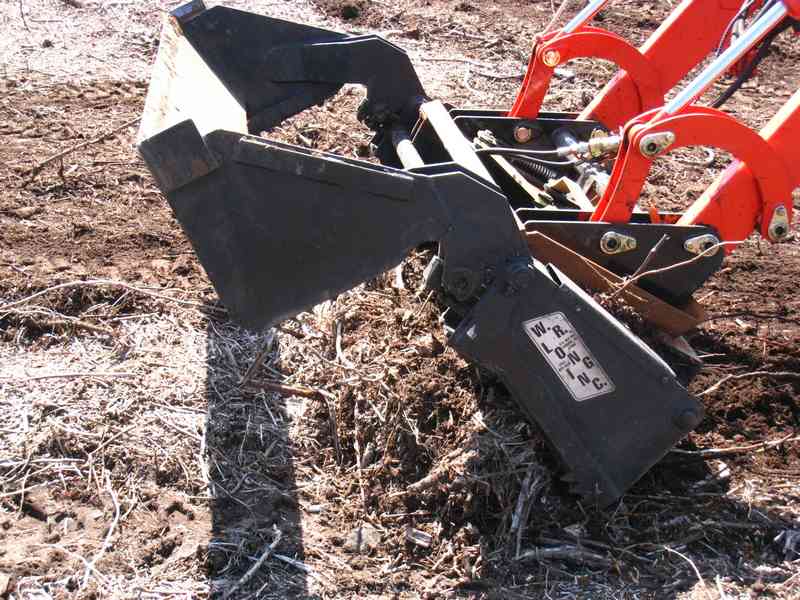

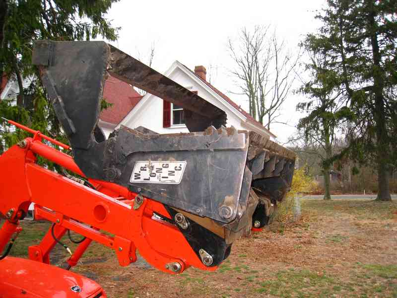

Photos show position of bucket to get at the bottom zerks (note that with the bucket this high you cannot reach some of the FEL zerks so need to change position of the bucket while greasing, another waste of time.) Other photos show bottom zerk after cleaning and after greasing. The photos of the zerks are taken from behind the bucket and you can see that the face just 90 degrees back from the bottom zerk is open and could easily be used for a zerk (with protective ring). Last photo is a typical scraping motion with the dozer blade function. Note that the current zerk position essentially jams dirt into the zerk location while the area 90 degrees back is relatively well protected and open. Yes, some dirt would get in but not nearly as much compacted material and it would be easier to get at to clean and grease.

I guess you have to be more careful when you buy a bucket to buy one that has the zerks placed where you want them.
Maybe it is on small time equipment. On my LB115, they're on the sides. I just looked on my 4/1 Kubota bucket on my 48HP CUT and they're on the sides, too. I can grease my 4/1 while it's resting on the ground. Maybe it's the brand you bought????? Or maybe it's a grapple bucket thing???
