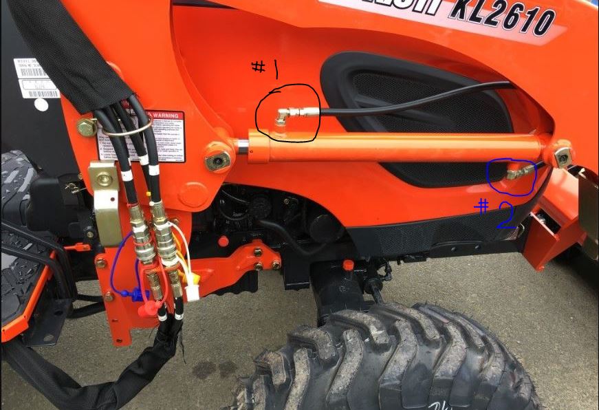

I've been trying to diagnose my loader dropping on my Kioti CK30 (KL130 loader), and the consensus is that..
1. the dropping itself cannot be due to just the cylinders leaking themselves. The problem must be either the control valve and cylinders OR just the control valve. Either way, the control valve is leaking.
2. Because the tolerances in the control valve spools are so tight, it's not possible to replace just the spool valves
If the entire control valve needs to be replaced, is there any place I can source a used/rebuilt replacement instead of buying new? Any and all input/recommendations are helpful.

You are correct the valve must leak for the cylinder to drift in the retract mode.
What is the big unknown is how much the increase in valve leakage is when the cylinder piston seals allow leakage which then pressurizes both ends of the cylinder and consequently both the raise and lower ports on the valve.
Testing the cylinders is typically far easier and less costly than replacing the valve and still having a problem.
A simple non invasive cylinder test.
Support the loader on a jack.
Unplug only the blind end hose on the lift cylinder. Remove the jack. If the loader drifts the piston seals are leaking and this leakage is going across the directional valve. Fixing the cylinders stops this leak path.

OK! And by "blind end hose" on the lift cylinder, you mean #1 or #2?
/ Used/rebuilt Kioti loader control valve options #7
#2 hose is the blind or cap end of your lift cylinder. This will not tell you which cylinder is leaking but will tell you that at least one of them is leaking.
The situation where the loader will raise when valve is first moved to lower also indicates bad piston seals. Reason for this is that if the spool is opening the pressure to lower port slightly sooner than the tank to return oil connections. This pressurizes both ends of the cylinder putting it in regenerative mode.

This weekend I did OldnSlo's test. The loader did drop, about 1in/30sec - the same drop rate as when using the loader normally. So, my conclusion is:
  • The piston seals WERE leaking, because the oil had a path to return to the tank since the rod end hose was connected
  • If the piston seals were not leaking and the control valve was leaking, the loader would not have dropped in this test since the cap end hose was disconnected/blocked off.
Is that correct? I've proven that the piston seals are leaking regardless of if the control valve is leaking or not?

You are correct. If you fix the cylinders, you might be satisfied with the internal valve leakage.

4lane
I greatly appreciate you posting your test results.
You have proven that the piston seals and rod end port of the valve leaks. If the valve did not leak the cylinder would not drift.
This proves that the leak path through the rod end valve port is definitely contributing to the loader drift.
