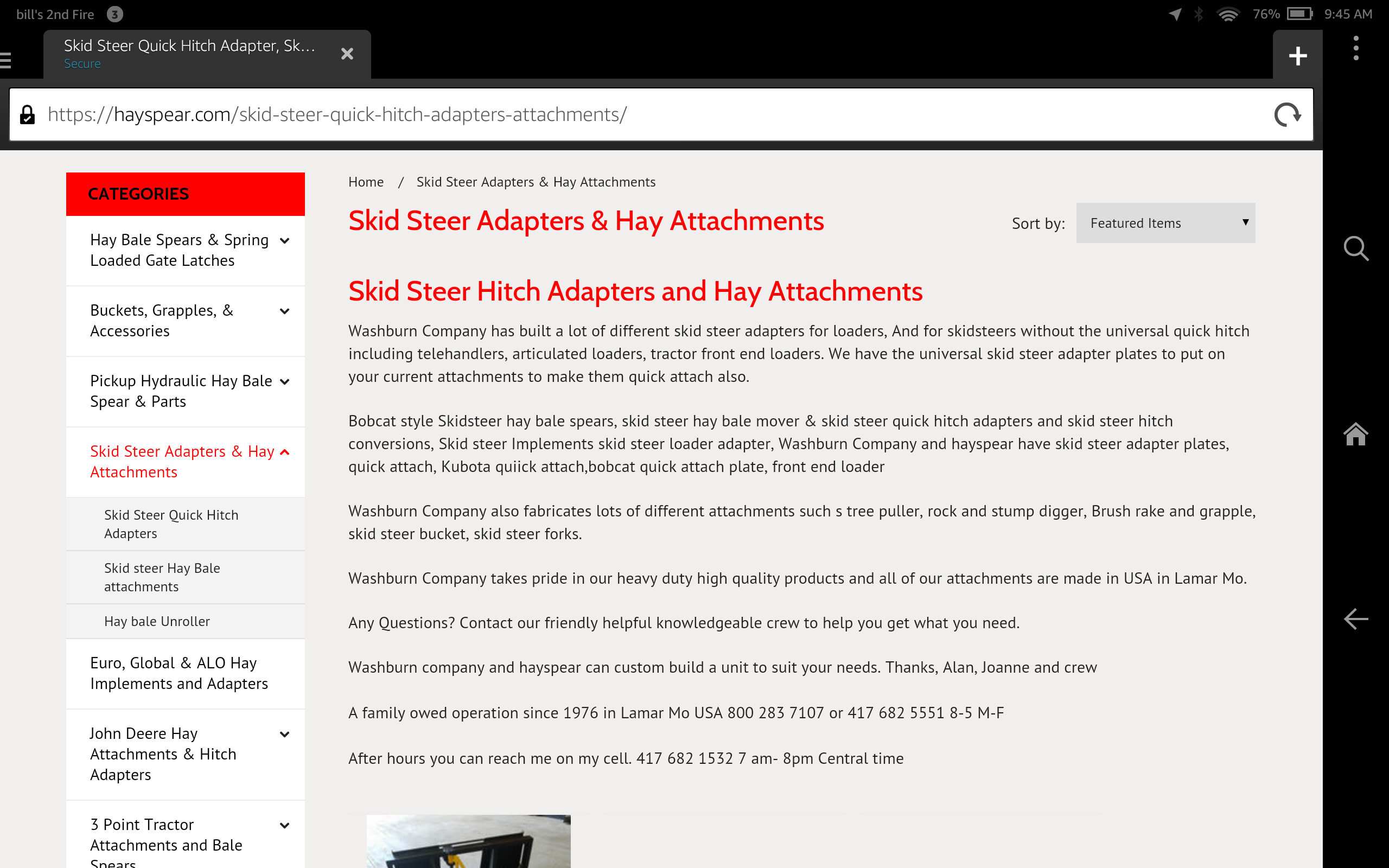

Agree with BLSXJ pricing analysis. Seems accurate. The kubota pin on bucket brackets are wierd configuration. Unless handy in metal working, purchase new SSQA ready bucket from Tomahawk, very reasonably priced, less aggravation. Might be able to sell used bucket, if someone has one which is damaged??
This company offers a SSQA with the new brackets attached, they are adjustable to fit, it is a plug-n-play installation, NO welding, little more expense, but simple expedited process. See screenshot.
