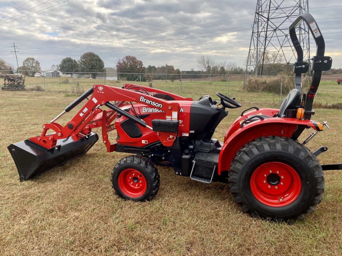

How about a legacy TYM T2515? Lifts 2200# at the pins, comes with SSQA connections on front, 2 years bumper2bumper/6years powertrain. Runs you around $20k+/-. Has a low tech mechanical injected engine and no ECU. HST or cogs.
   / Used John Deere 4005 vs New Tractor
I unfortunately don't have a TYM dealer nearby, but do have a Bad Boy tractor dealer that's pretty close. They are a powersports dealer that sells Mahindra tractors as well. I believe the Bad Boy 4025 is a Branson/Kukje/Tym 2515 with an HST, so it could be worth checking out.

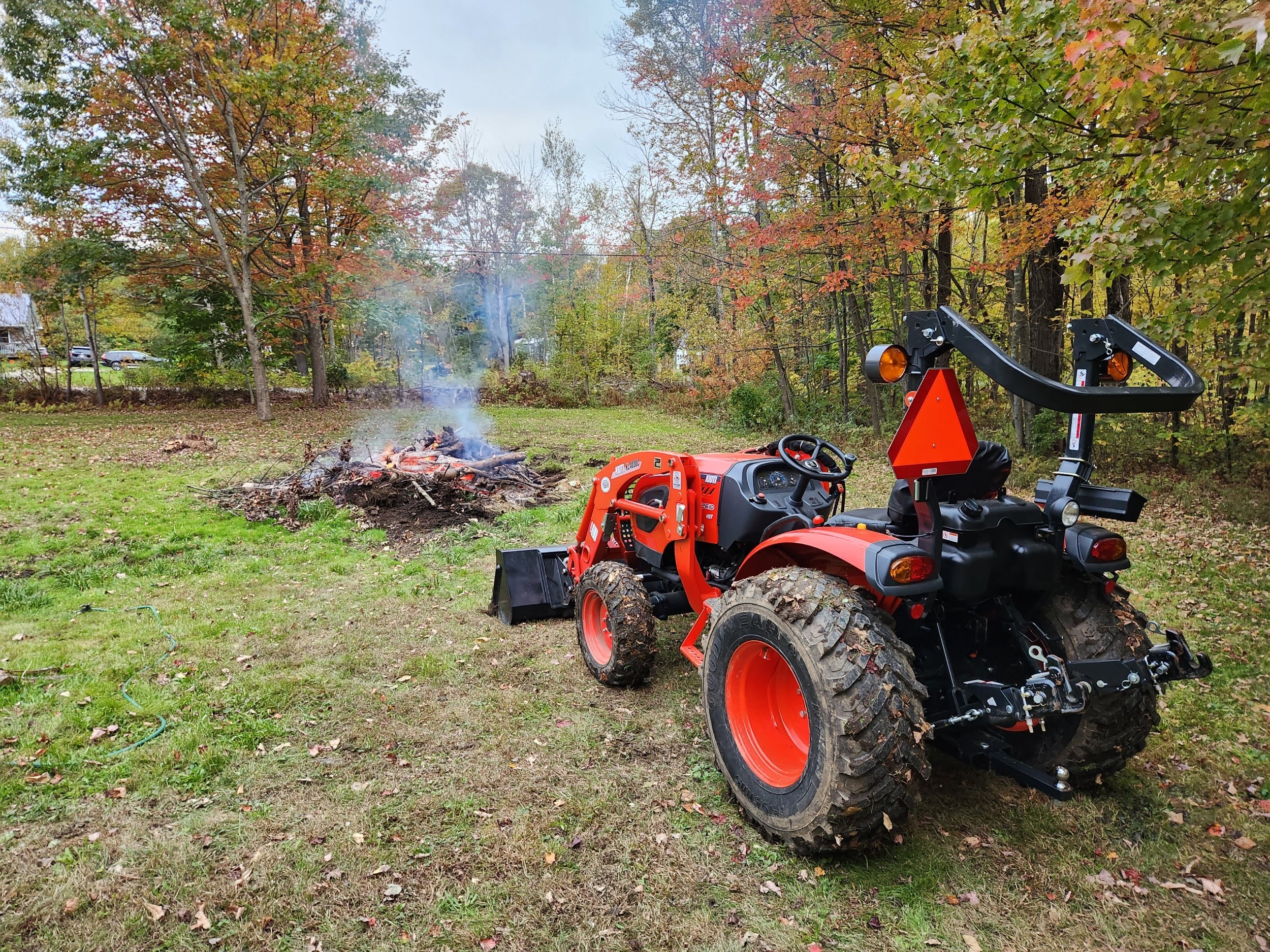

Oh, is that how it is? If you're going to pimp TYM, I'm going to offer up the Kioti CK2620 as an alternative. 🤣
Except I'll post my CK2610, out of vanity.
Now if you decide that a modern, larger frame, ~25 horsepower, HST compact tractor isn't right for you, that's okay too, and in that case the Deere 4005 is an excellent machine. It's a Yanmar built model, isn't it? They're simple and reliable, a lot of people here love the Yandeere models. You're going to get similar hydraulic performance in these tractors, roughly, so that asks- how big a rototiller or mower are you going to be operating? A 25 horsepower HST will produce roughly 19 PTO horsepower, and while the general rule is 5 horsepower per foot, you can get away with running 5 foot implements if you're willing to sacrifice speed or you're on flat ground. Or even a bit of both. The 4005 is 35 PTO horsepower, and will run those items at a faster speed, up and down reasonable hills.
If you can, operate all options a bit, get a feel for what is comfortable for you to use. A tractor that beats you up may not be a tractor you want to run for any extended period.
This is a fun time, with so many cool options available, enjoy yourself!
Oh, if you go new, get it with everything you think you'll grow into. Rear-remotes, 3rd function, extendable links, whatever you think you'll use- it'll never be a better time to add these items.
