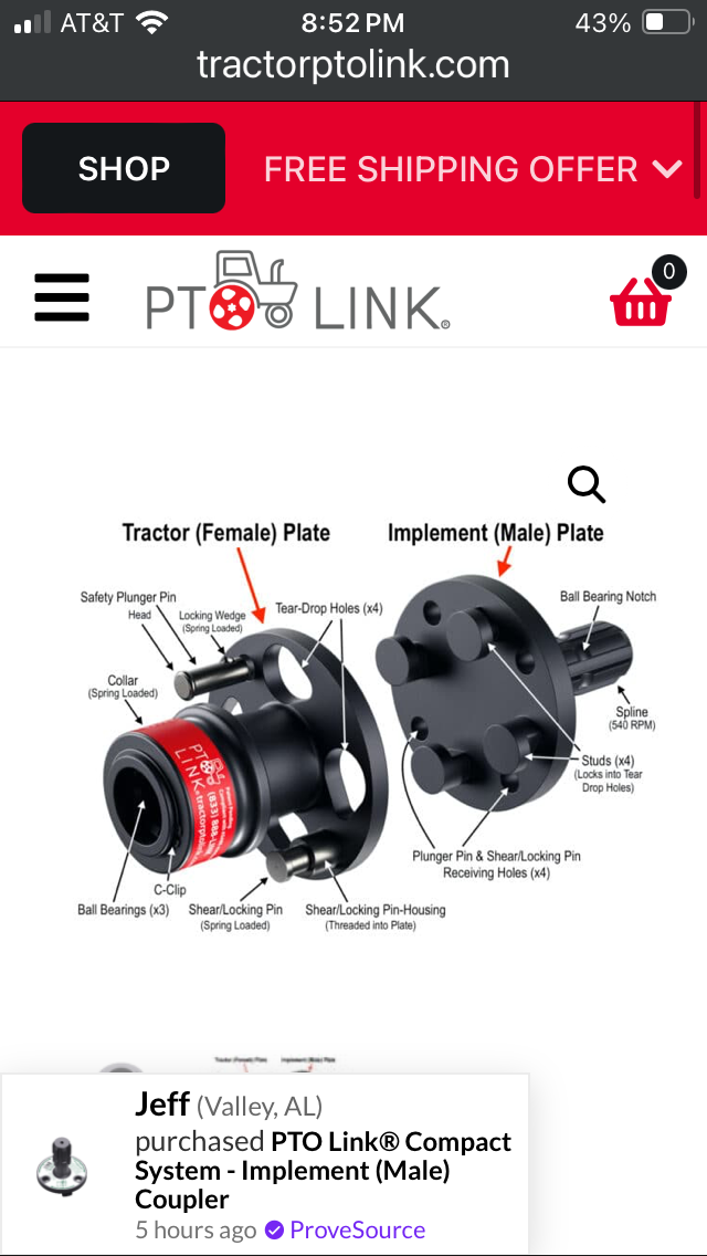

Anyone use one of the Easy 3 point hitches?

One, way too expensive and I'd need multiple implement sides anyway. I have no trouble hitching up anything PTO driven anyway.
To me, almost is like creating a problem and the solving it for a price. In my case I only run an over running adapter on my PTO stub if an implement don't have a built in over running clutch and all of mine do except the shredders.
Kubota's have notoriously weak PTO brakes, especially my M9's, consequently, I run the over running coupler which completely eliminates any inertia driven motion from the implements. IOW, I can disengage an implement at 540 rpm and not be concerned about the inertia of the PTO shaft destroying my clutch brake and replacing a clutch brake in any Kubota is a BIG job as in splitting the tractor to access it. You can see the brake if you take off the back cover, but you cannot reach it. It has to be replaced from the front.

I really cannot see any practical application for the PTO adapters, other than a severe lightning of your wallet. They are an insanely expensive option for something that is a non issue.
Kind of like the hydraulic fitting pressure relieving tool. I just use a brass punch and a hammer and point the fitting away from myself and tap the poppet and the pressure is relieved. Easy peasy and cheap too. I'm forever adding make up hydraulic fluid anyway as every implement change equals some drippage from the SCV's. I do a lot of implement changes, hence I loose a lot of fluid and have to add make up fluid regularly. Keeps the backside of the tractor 'oiled' as well.

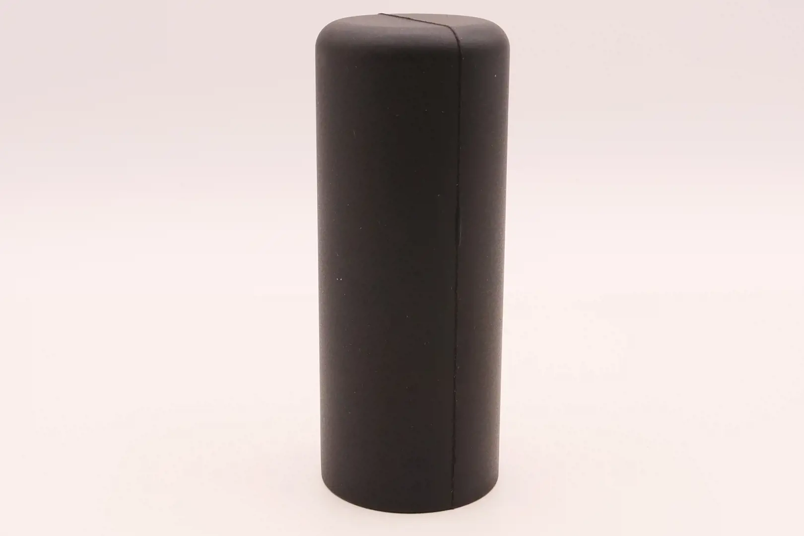

Another trick is to keep the PTO spline clean when it isn't being used. It's easily done with a spline boot, such as this one:
My Kubota dealer has a bunch of them in a bin in the shop. When they add a backhoe to a new unit. the cover goes in a bin. Last time I needed one, they gave me one, no charge as they have numerous ones in the bin. I keep my stubs covered when not in use and I always add some grease in the cover as it aids in installing it easily and coats the splines as well.
I've had any issues installing any pto coupler on my coated with grease, stubs and never had an alignment issue either. Most stubs (least on my tractors) will free rotate 1/4th of a rotation to allow easy mating of the female shaft coupler.
