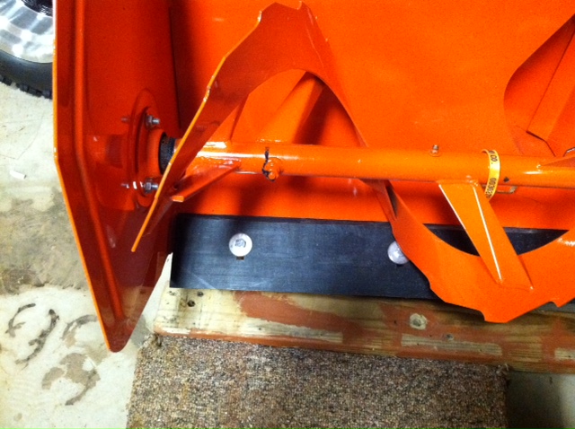

I finally got around to upgrading my snow blower.
I bought the UMHW at Interstate Plastics
I was able to get several different sizes and widths for a few different projects all for under $60..I think one set of parts for the tractor was around $20.
I used 1/2" material for the skids. I beveled the material countersunk the holes and bolted it through the skids. I was going to drill and tap the steel, but then I noticed the skids had a bend to them that gave clearance for a locknut. I got a little lazy.....
Installed:
The blade is 3/8" thick material and beveled both edges so I can flip it around if it wears out. I made slots with a mortiser instead of holes so I can get the adjustment right. Make the blade wider than the stock one to make up for the added height of the skids.
Installed:
Enjoy!

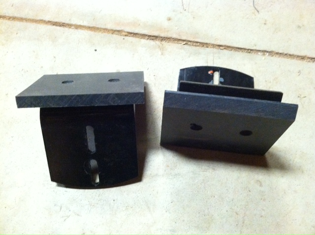

I made non-marking skid shoes for my B2782B blower using 3/4" thick UHMW. Made new steel mounts as I didn't want to modify the originals. UHMW is mounted using countersunk 1/4-20 bolts. Skid footprint is larger than original.
bumper
