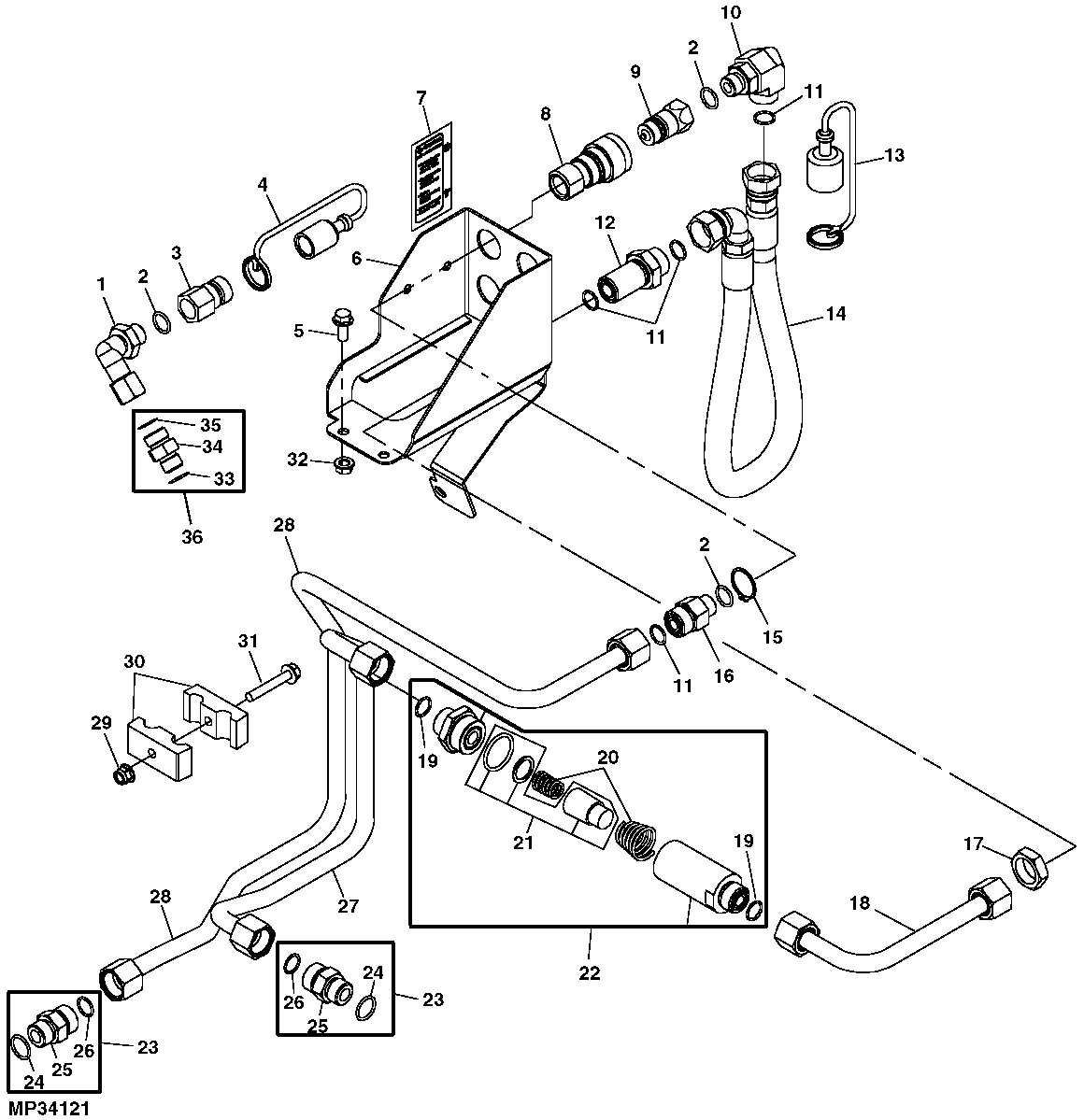

Attached below is a picture of the Power Beyond kit for your machine (open station right?) With that "kit" you can feed your new valve, and a backhoe and/or splitter.

1/4" IN/OUT simply will not work for you-it won't support the Flow (GPM) of your machine. PB is just a "better" way to add valves, I am not going to type it all out now...there are plenty of threads about in the Hydraulics forum.

kennyd
I then take it that hose #14 is where the 3 spool CV is plumbed into the PB, and when connected to itself it completes the pressure line to the 3 ph rockshaft system.
I'll be interested in what/where the 3 spool CV gets located on the 4320.
/ Upgrading the JD4320 Hydraulics #9
kennyd
Correct, the valve needs to be OC (open center) and will take place of the loop.

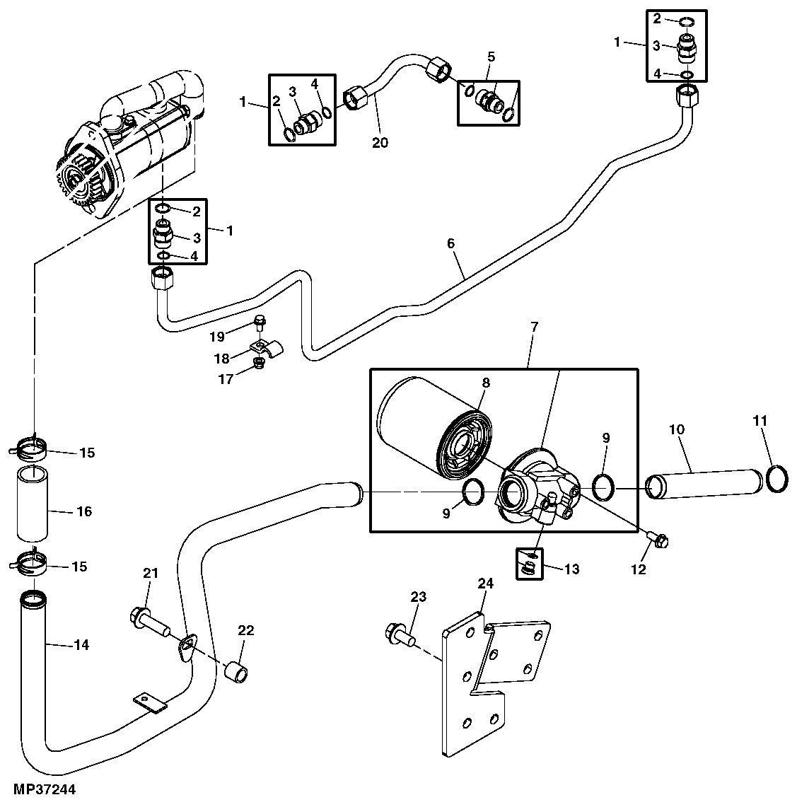

Your 4320 does not appear to have the line acrossed the rear...looks like the PB connects near the SCV valve or PTO valve, I can't determine exactly from JDparts. Here is the main pump lines to the rear:
