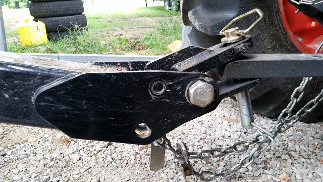

Try this again, I need help try and fix this.
Did the pic work?
/ Upgraded #63
Run bigger pin,lot of slack in the one you have by the look of picture,could be shadow.Some folks cut piece of angle iron with hole and run it on top draw bar. Another could do it take it somewhere and get them drill hole further up on draw bar,take a machine shop probably. Just throwing out ideas...

I agree I'd run a bigger pin if the cutter hitch hole is big enough to do so. Otherwise, not sure I see a problem. That's just what you get unless you run a Hammer Strap on your tractor hitch.

I thought the hitch should all be level? Notice how the draw bar is wearing at an angle?

No they all do that to an extent,once you get a bigger pen it won't be as bad.That angle iron piece I was talking about is more of a wear plate so not wearing on your draw bar.

I couldn't tell by the pic, but assume this is on your brush cutter?? If so, there is a lot of weight on the tongue and it will never set level. That's where the Hammer Strap drawbar comes in. It makes the wear occur on the cutter hitch and/or hitch pin rather than your expensive tractor drawbar. I'd be finding a fix for that soon.
On the other hand, if you have a hitch like that on a ground engaging attachment such as a disk you can adjust the tongue height on the attachment to get the hitch to pull level with a load on it. Of course, it will still flop down like yours when carrying the tool.
You might contact your dealer and ask if they offer a Hammer Strap for your tractor?? Or go to the Google link I offered and find one online.

Yes it's on the cutter tounge. I don't like how it is, so I will be fixing it just need to find the correct part

I totally agree, the hitch set up looks terrible. It seems to be an accepted practice and I run mine the same way and don't like it.
I think the solution is what the other guy showed which is a hammer strap.
As equipment has evolved, I am surprised this hitch set up is still the standard.
It will oval out and wear down your draw bar....

Sorry forgot to post an update...
I actually fixed it. Turned out the dealer forgot to put in another bolt
