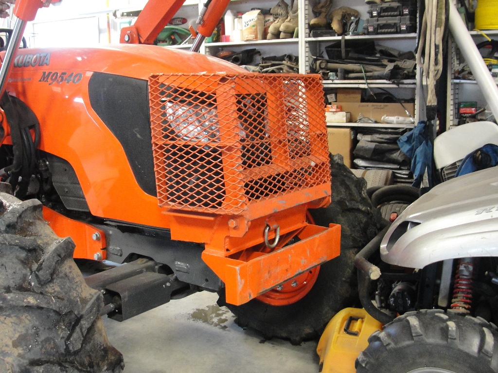

Im having a hard time finding tie down spots. Do you guys trailer often with this size tractor?
/ Upgraded #25
I trailer my tractors often. If FEL is on I tie over the bucket in the front. If no implement on the rear I use a clevis on the drawbar. If implement on, I tie over it. I also added a tie down ring on the front guard when I modified it to use when the FEL is removed.
/ Upgraded #26
I use straps,one usually goes on what I have on loader(pulls straight down),if nothing on loader I have a servey stick use push strap threw that hole on loader,other goes across brush guard(pulling forward)that's the front. Then on back I use a shackle in draw bar(pulling rearwards) If I have mower on back,I go in beside the draw on tractor(pulling rearwards). One going around mower tongue in X patteren(pulling straight down)short hauls may skip this one,then last one on rear tires of mower(pulling straight down). Chains scratch everything to much why I don't use them.

The back is where I struggle to find anything to go around. The front I do the loader and front gaurd and same as you on the mower. I drove home last night 5min and feel like it moved on me a little so I may have to reevaluate so tie down spots.
You need to post some pics of your modified ring on the front sounds interesting
/ Upgraded #29
This isn't a very good pic, but you can see it hanging behind the weight rack.

I purchased a large d ring that goes into my drawbar and run my chain through that.
/ Upgraded #32
Nice looking grill guard Richard. I really like the way it wraps the sides and the expanded metal is the cat's meow!
Thank you. An indication of it's effectiveness is the scratched paint and dents in the expanded metal. :)
