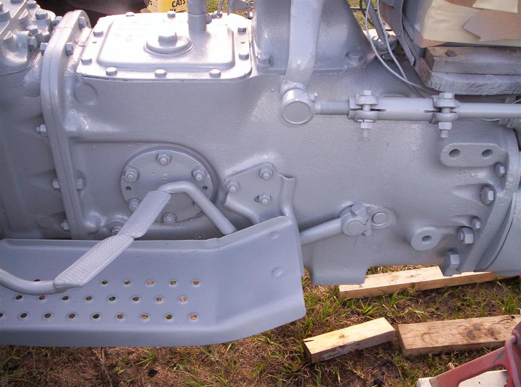

I managed to get home early enough to get some primer shot on the cast iron.
At the end of the day, I find I need to change my compressor oil.. it's getting dark. Also.. I think it is finally time to retire the 9$ harbor freight spray gun.. I had to keep dinking with the syphon control to keep it spraying that last few minutes of painting. Looked at new chinese guns.. looks like I got to spens 20 - 30$ now to get a new one! Darn! That 9$ one ( on sale from 15$ back in 2000 ) has been a good gun. Cleaned meticulessly.. but just wore out now..
here's a sneak peak.

I think I'm gonna call this one a ?refurbishment? It will be fully functional.. but I am not changing tires, and using 100% correct parts. I made the steering arm.. and the sheet metal is likely coming from a 900 not a 901 series.. Plus, this was a LPG machine.. so it was originally on propane and was converted to gas... since I'm leaving it that way.. can't see calling it a restoration as it will DEFFINATELY not be in factory condition when I'm done with it.

Well.. been raining alot here in the afternoon.. mostly killing my after work time.. but i did manage to get a flap and wire wheel and start onthe fenders on the 951. I spot checked them and found a few rust holes, and went ahead and put my first application of bondo on the holes, and then started buffing them down.. got about half of each fender done before I had to stop and jump to another task yesterday.

Had a couple hours earlier, after chores to work ont he 951. Decided to go at the 'driver' side fender. buffed it down to clean metal and shot some promer on it. took 2 hours exactly.. I work a shift each day this weekend.. so i will probably ony get a couple hours a day to work on her for a while.

The sheet metal I take to bare metal. lotsa ways.. like chemical strippers, then pressure wash.. then a 'black' 3m abrasive pad.. it takes rust and paint down to shiney metal. I then wash it with a water based solvent like purple power to remove any oil and degreaser... rinse, and towel dry and then set int he sun.. then wipe with a tack cloth.. then prime.. then paint.. following prime/paint recomendations.
On the cast.. I pressure wash well, and degrease..a nd pressure wash with water based solvent.. then wire wheel any palce with bad paint. I rarely strip the paint ont he castings unless it is bad.. if it is.. then a wire wheel.. or preferably.. a knotted wire cup.. it will take it to bare metal.. but it's a long job.. My work tractors i don't usually do.. onmy parade jobs.. yeah.. all down to metal.. frame and all.
Parts you don't want to seperate.. just mask off with clean release tape ( blue masking ) and contractors paper.. comes in rolls from places like lowes.

I've got 8yr old paint on my working tractors that was prepped just like I mentioned... so far so good. Key is getting down to something good for the primer to stick to... For a 100% job.. metal is best.. for a worker.. If you can at least get down to good old base paint that is sticking fine.. then for the cast iron.. that's pretty good.. sheet metal though.. always down to metal..
