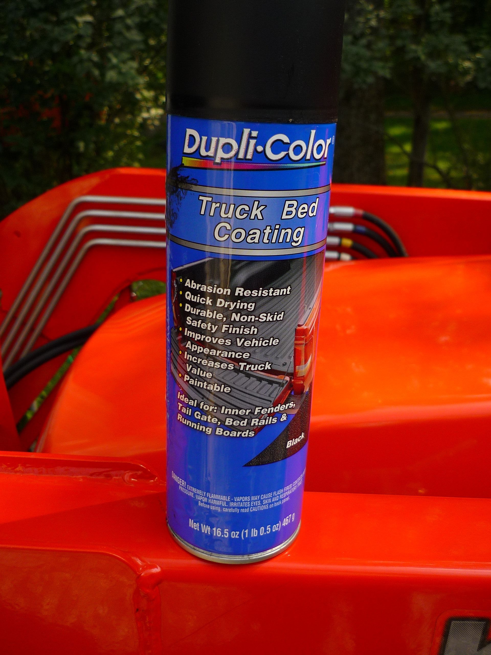

Has anyone done the interior of a mower deck?
You would trap moisture and create more problems with rust. I pressure wash my underside mower deck every now and then before winter and spray penetrating oil on it when it's squeaky clean. Seventeen years later it looks the same as one about two years old.

I used rattle-can Slip Plate Amazon.com: SLIP Plate(R) Aerosol, 12-oz: Automotive on the inside of my mower deck. Spray on a couple of heavy coats, let dry, then burnish with coarse steel wool to polish it slick. Depends on what you mow but mine lasted almost 2 year per application. It stays cleaner and more easy to wash off. Also in brush cans.

Answers: yup, I masked it off, and just stuffed some newspaper pieces on top of the hardware below the holes so it wouldn't get painted. The center cover was taken off, masked and sprayed. I used this stuff, from NAPA... and I would use it again, if a need arose.
Just a caution about the Dupli-Color product. I used it on my truck bed when new in 2004. I now have a large rust thru on the wheel tower I need to repair. The coating is pretty good and fairly tough but it is not flexible. Dents on my bed cracked the coating and rust went through those areas before I realized it was rusting. If you use this kind of material on a surface that can be dented, be sure to check for cracks and recoat to keep it sealed.
