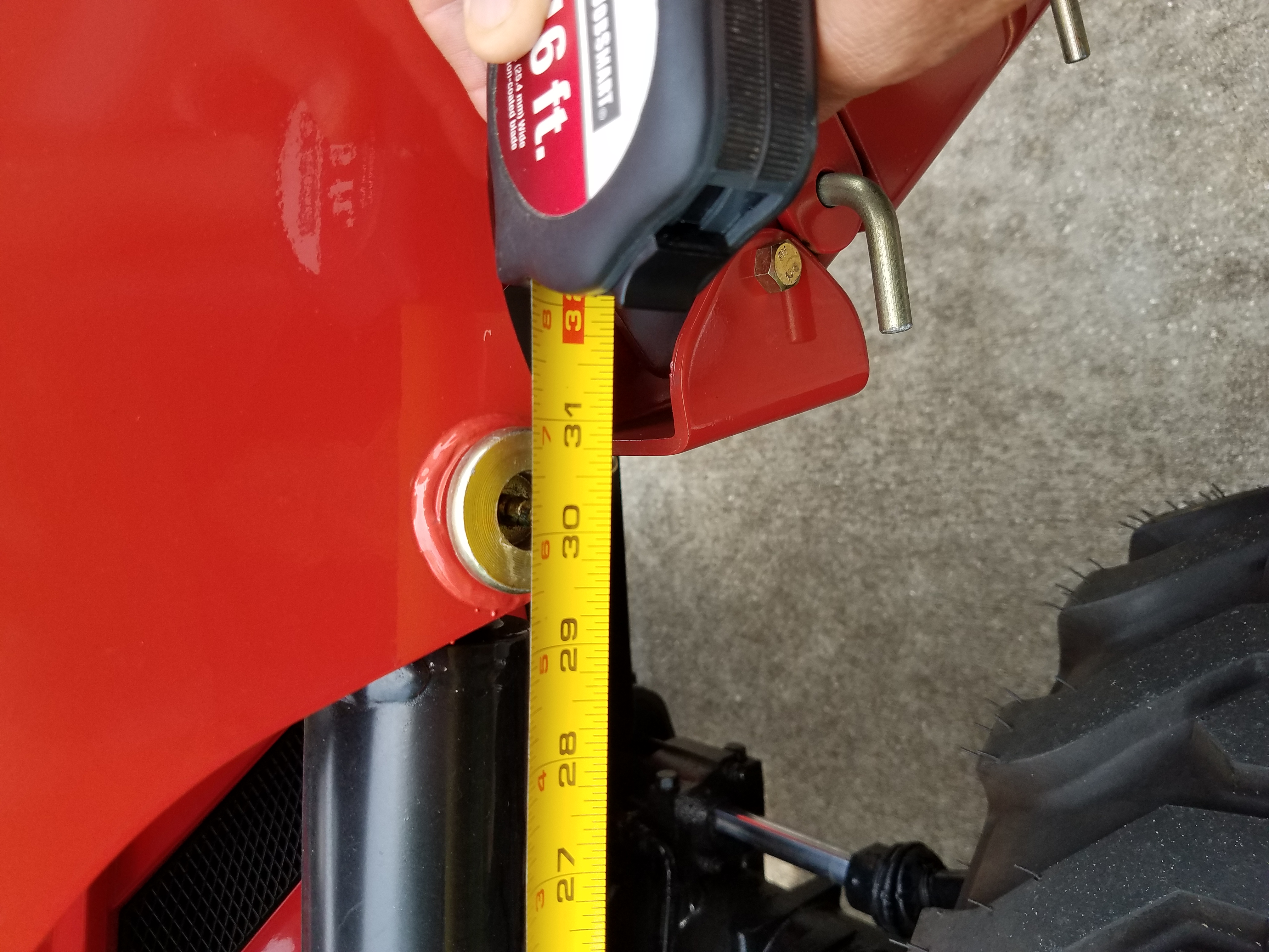

I haven't had a chance to contact the tractor guy at RK since sending him the pictures but this past weekend I did have the bucket off and my hay spear mounted and the left spear on that is also lower than the right. I guess I could disconnect one end of the cylinders from the FEL and then compare the length of each fully retracted to se if they match. If they do then partially extend them and measure again to see if they have extended at different rates.

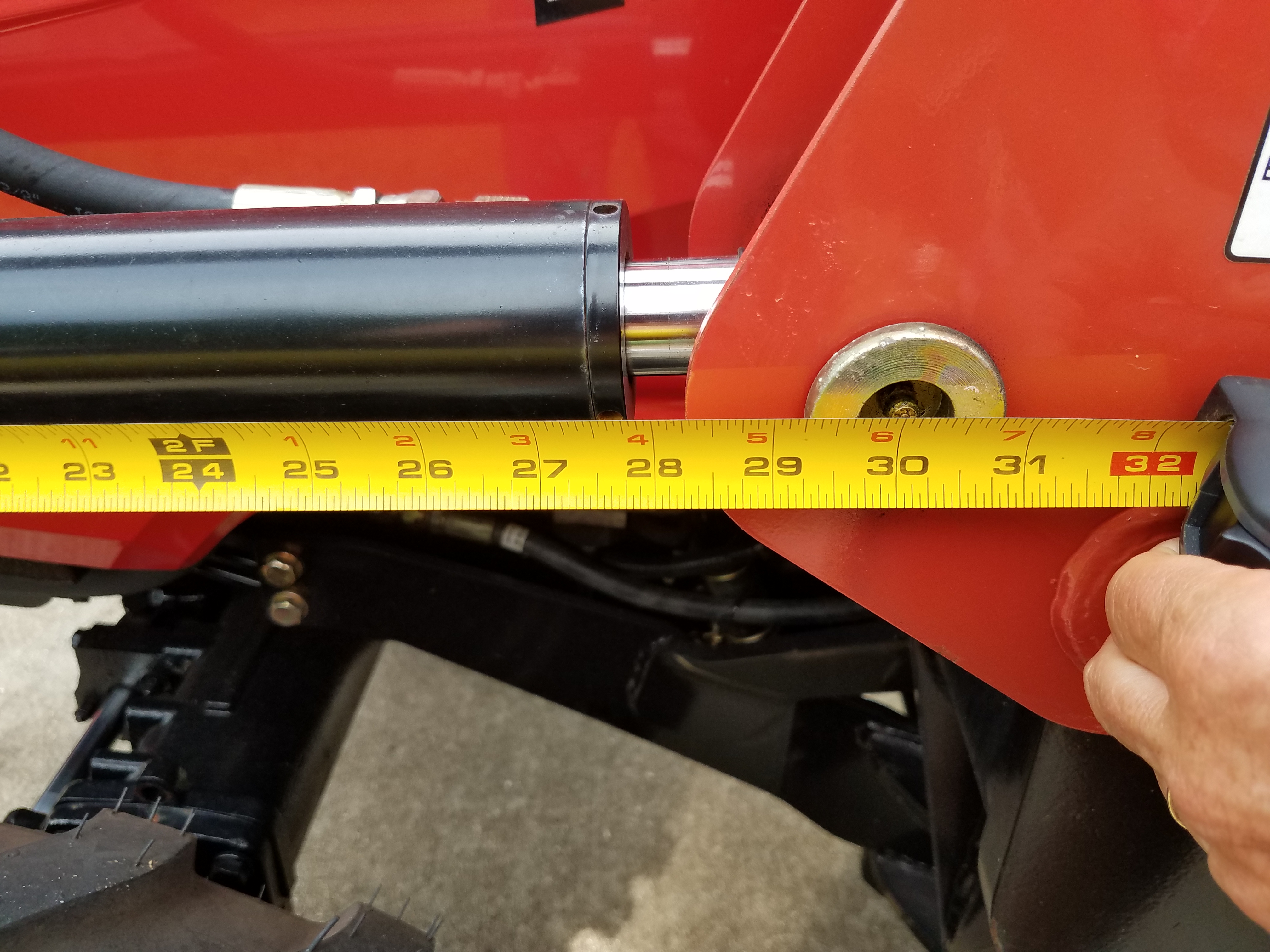

I talked with Dan the tractor guy here at my local store this afternoon and he said that he thinks that there's a mismatch in the cylinders when the FELs are assembled. I reminded him, that a few weeks back I sent him pictures of the cylinders being different lengths. After I got home I took another set of pictures with the bucket raised about 3 feet off the ground. Left cylinder is 33.75" from center of the grease fittings and the right side in 34". A quarter of an inch at the cylinders makes a big difference at the ends of the FEL arms. For those having issues with the FEL not being level with the frame you need to speak up so that something can be done.

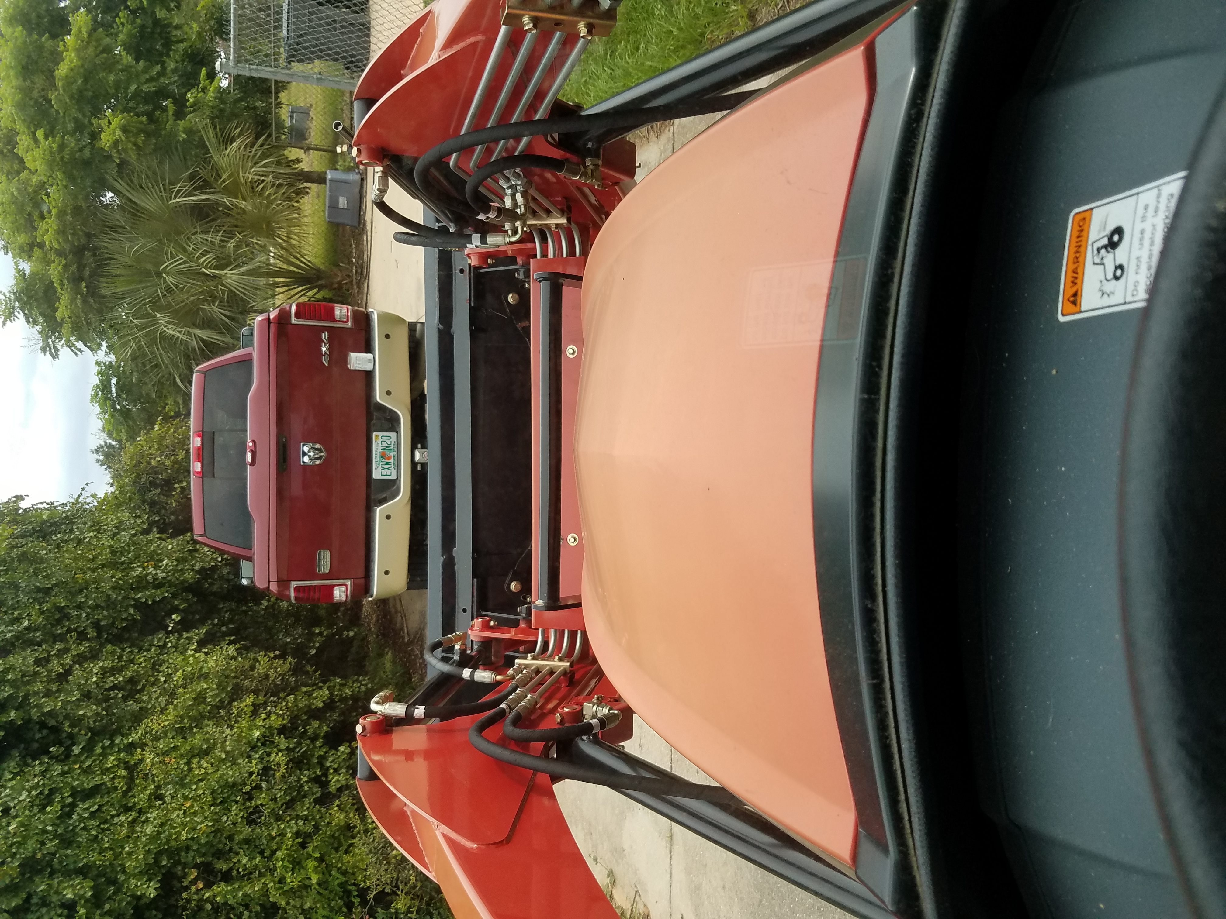

Is it possible that the mount for the bucket is welded off-level on the back of the bucket?
/ Unlevel bucket #36
I didn’t look there. I sent these pictures to the store where I bought the tractor and gave them all the previous information. I’m frustrated because I have my grapple and loader on pallets and you wouldn’t think an inch and a half would make a difference when picking up, but it does. As well, when I put the loader to the ground, if I want a flat surface it flexes the entire implement/arms.
Not what I expected for what I paid for. Hopefully someone will find a resolution. I’ll look at the welds tomorrow.
There are pictures above that show that the cross member is also twisted to one side.

I might be seeing things but in the 3rd pix the left cylinder seems slightly more extended which would be in keeping with the bucket misalignment, but then it could by an illusion caused by camera angle.
