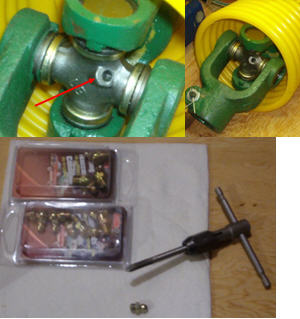

In the picture you will see that a grease fitting broke off and I removed it and tried to replace it with a standard 1/4 inch model. I burnt up three titanium drills trying to bore a new hole so I could tap the unit for a new grease fitting. NO GO. This stuff just does not allow itself to be drilled or taped. Can anyone suggest a solution Please! Thanks in advance.

Why not replace it with the correct grease fitting?
/ Universal Drive Grease fitting broken #3
<font color="blue">....and tried to replace it with a standard 1/4 inch model....</font>
Zerks come in both SAE and Metric. If it were me I'd unscrew an undamaged zerk and match it up at a hardware store, you'll find a lot of different thread sizes. Its easy and cheap to swap all of em out if there is a problem. As for the broken zerk, I'd try to back out the old fitting and just screw in a new one, the threads are tapered and it should self tighten as it goes in.
/ Universal Drive Grease fitting broken #4
Were you using cutting oil? I drill a lot of stainless and found two things important - the right amount of pressure on the drill bit and good supply of cutting oil.
/ Universal Drive Grease fitting broken #5
Sounds like it is to late to use an easy-out to back out the old zerk fitting. If you drill, do as the other poster said, plenty of cutting oil will help and maybe use lots of pressure at a slow RPM.

for the price of those 3 titanium drill bits you could probably have a new joint put in. I had one installed for $30 labor included.
Thanks, you are probably right.
You are of course right! However I live in Canada, we have gone metric approx. 20 years ago and do you think I can find a metric grease fitting anywhere?? NO! I did find a site on the net and will place an order. Thanks.
#9
Thanks to everyone for their suggestions. I did find a site on the net with metric zerks so I will place an order. By the way I did purchase some cutting oil, drilled at very slow speed and this stuff is very tough! Could not dent it. I will replace with a metric original.
/ Universal Drive Grease fitting broken #10
I'm not familiar with what Zerk fittings you need. But when one of my <font color="orange"> Kubota </font> FEL fittings went bad. I got some metric fittings from the local auto store. They did not fit. Thread on FEL was a finer pitch. Had to go to dealer and get fittings from them. I now have several spare fitting. In case I lose another. /forums/images/graemlins/frown.gif
/ Universal Drive Grease fitting broken #11
Could you plug the hole and grease that u joint with one of those grease needles instead.They work great ,i grease sealed bearings all the time with them.just slip it by the seal and fill her up
ALAN
#12
Thanks, just got the metric fittings (zerks) and it worked. I know have an ongoing solution, replace with stronger model of zerks.
