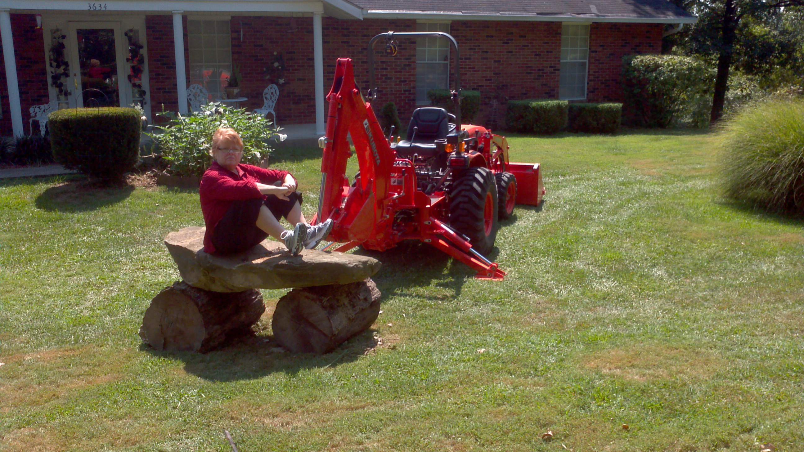

You think you've always got to be "messing" with stuff.:) Now you've checked it, leave it alone until you do an oil change service when you'll probably remove those panels anyway. You know these Kubotas don't burn oil, it'll be OK till change time.:laughing: :thumbsup:
Good looking tractor and is that picture going to be titled "Woman on the Rocks with Kubota"? If that's you, get off your butt and start working. Good looking property to.:thumbsup:

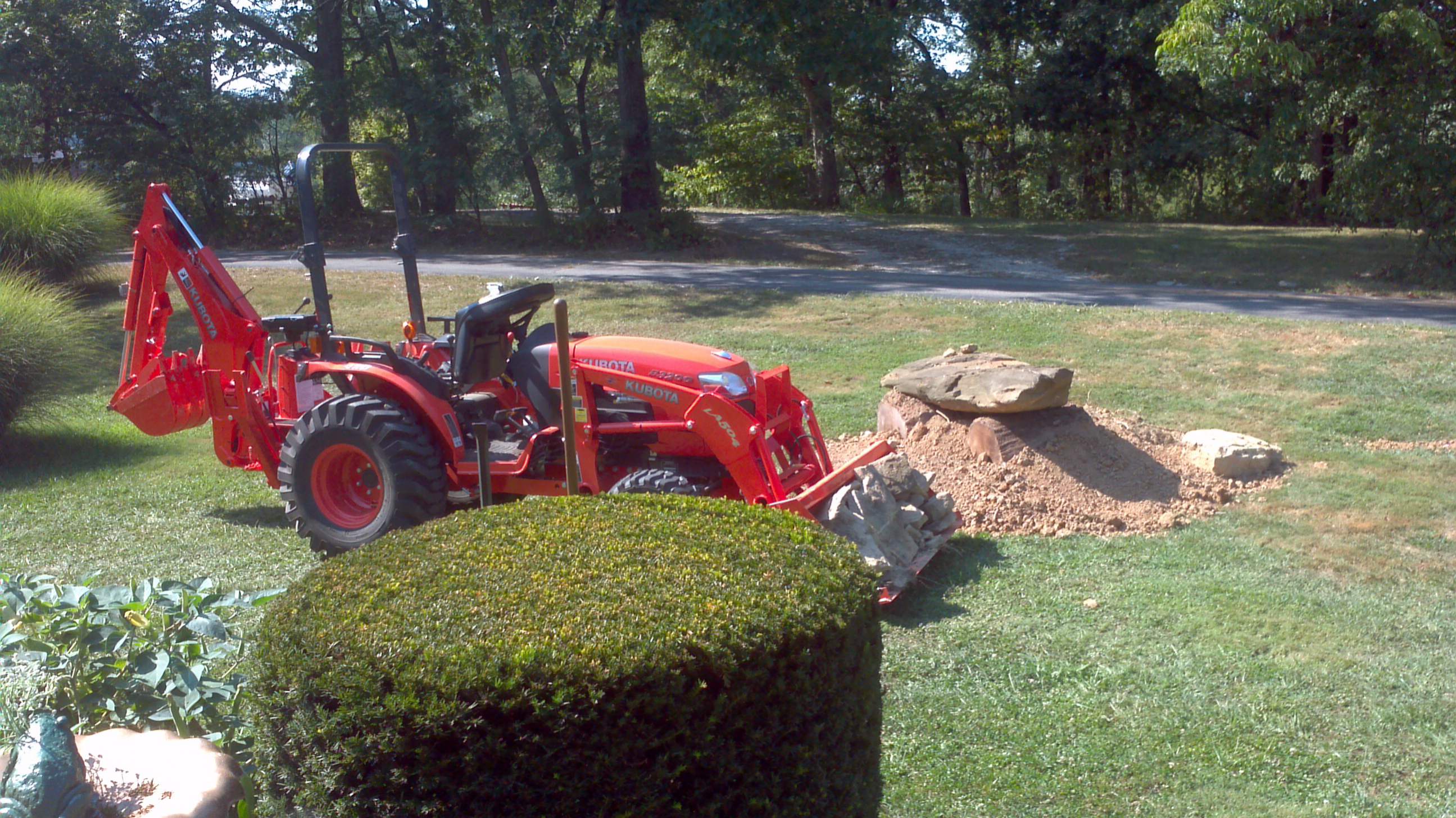

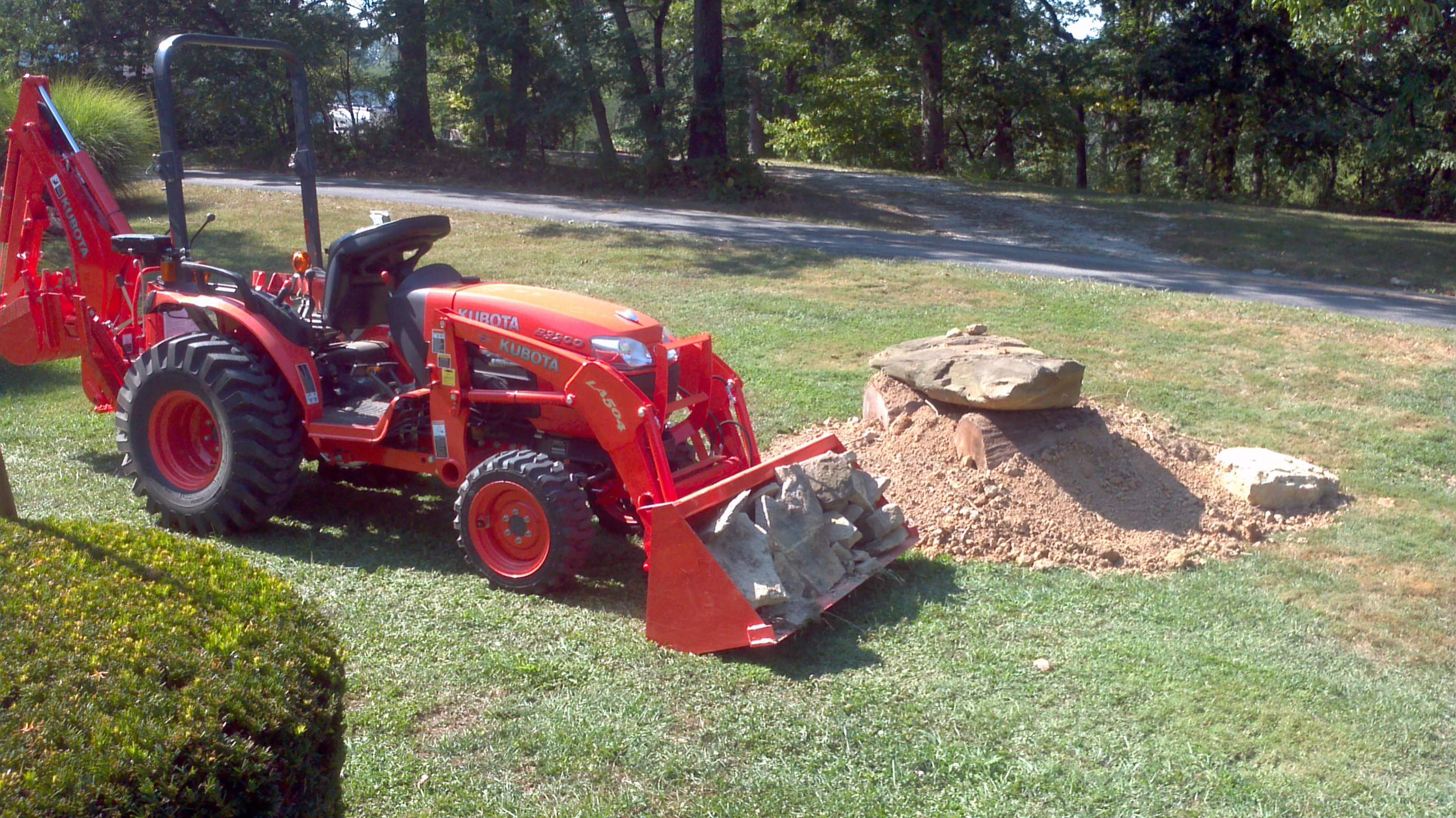

No JOHNTHOMAS that is not me. That is my lovely bride of 42 years. And thank you for the complements. By the way, that rock she is sitting on was picked up by the b3200 and put in place at idle. That rock is the same one that is in the bucket of my ex b2620 in my avatar. And it could only get it off the ground enough to move it. :cool2:
