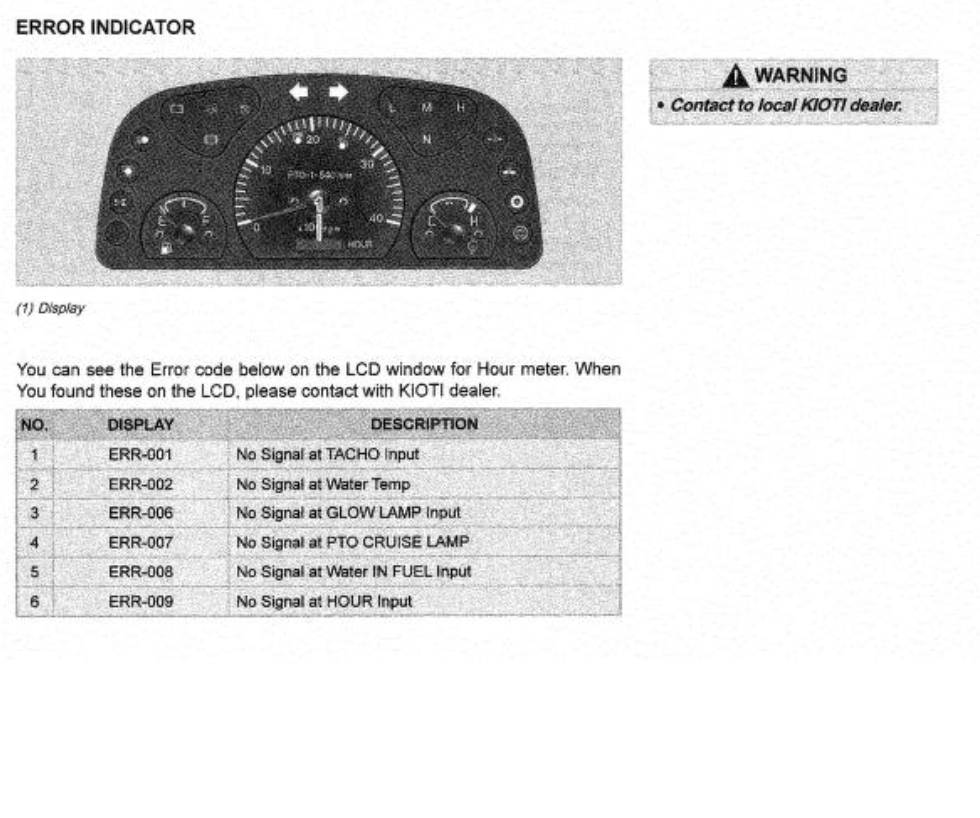

I thought ERR-008 error was water in the fuel (page 4-32 in your owner's manual). Unplug the fuel sensor at the bottom of the fuel filter and spin it out until the water pours out, then tighten it back up again. Prime the fuel system again and go start up the engine.

No it’s not Eric , the dash cluster has a light that illuminates if the sensor detects water. Look at the photo you attached, it clearly says what 008 is.
/ Understanding Error 008 #13
Not sure I understand your response. From the picture Eric attached, it says error code 008 is "No Signal at Water IN FUEL input". I'd take that to mean there's an issue with water in the fuel. Are you saying it's an issue with sensor signaling (as in no voltage detected) vs. sensor activation (as in water in the fuel)?
/ Understanding Error 008 #14
Yes that’s what I’m saying.
/ Understanding Error 008 #15
Ah, okay. I think it's easy to make an assumption either way, given how poorly the manuals are written.
