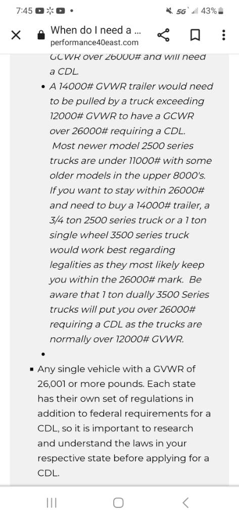

So, quick googling; and I think I understand. The 10,000+ trailer is irrelevant till we get to the 26000 GVWR. So, our OP, based on attached, can have his 10k truck and his 16k trailer; or his 12k truck+14k trailer; OR any truck upto 26k, as long as his trailer is under 10k.
And looking at options; if I was the OP; I would be looking at 10k truck and 16k trailer. I just don't think any 10k trailers will be able to haul a 8800 lbs machine.

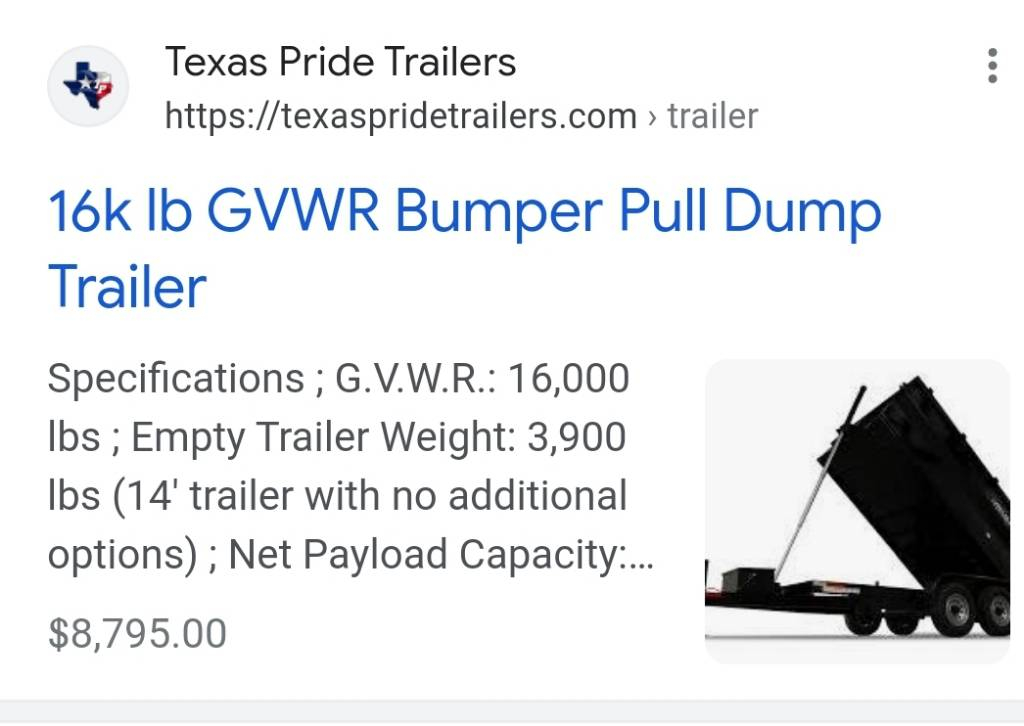

And looking at options; if I was the OP; I would be looking at 10k truck and 16k trailer. I just don't think any 10k trailers will be able to haul a 8800 lbs machine.View attachment 792907
No, there is no 10K trailer with an 8800lb payload.
That’s why I’d opt for the 2500-3500HD SRW with a 14-16k trailer to haul machine, then buy an older 25,999 dump truck.
It’s really not that complicated.
It makes a lot more sense to have a bigger digging machine to load a 25,999 dump truck with anyway. It’s the best way to “go big”, but stay out of CDL territory.
If you go with an F450/550, that limits your trailer greatly, and therefore your machine size greatly.
The 25,999 dump truck will cost 10-15K for a decent one with a diesel and an allison. They are all over the place, and one thing that has stayed pretty cheap.

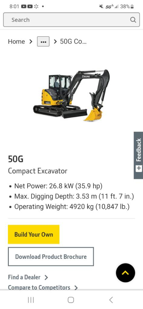

Looks like Some 15,900 lbs GVWR goose neck dump trailers, can be as low as 3900 lbs curb weight. That seems light, but, thr lighter curb weight means more usable payload. I dont know that it's match made in heaven, But, with the trailer shown, you could haul a JD50G, Or 6 tons of material. Just need to keep your truck GVWR below 10K. Probably the JD35G, or 4 tons of material are more realistic. Gives you room for fuel, chains, people, ect.
