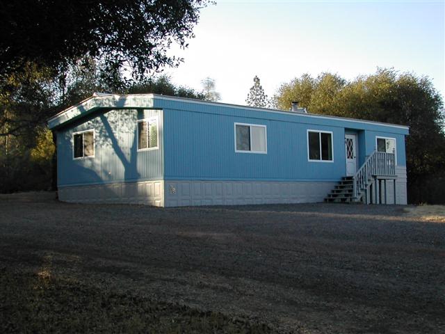

Hey UncleBuck,
I used discarded/defective garage door sections. They were free and just took some cutting/fitting to make them work acceptably.
The bottoms are screwed to treated 2x6s that are anchored to the ground with rebar. The tops are screwed to the lower part of the mobile. As you can see, the horizontal panel sections are installed vertically.
I'm happy with the way it all turned out (it's probably been at least 15 years since I installed them all). The attached photo is two years old.
I can provide more details if you like.
Phil

/ Underpinning a doublewide..Need help/suggestions #7
That looks pretty good. Almost like big concrete blocks.
