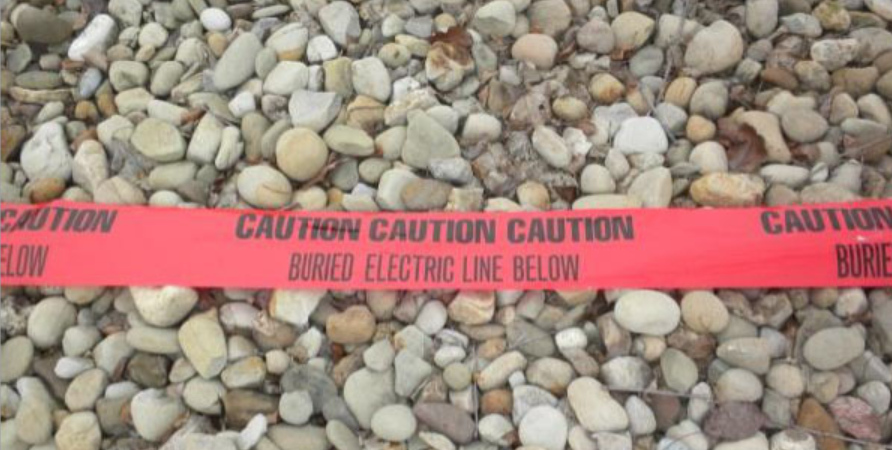

I thought the national code required metal conduit, but in any case the conduit should be sitting on and covered with #2 crushed rock and then cloth and hazard tape and then the top soil so that anyone digging will hit the rock and see the tape before they hit a live wire. The rock will act as a French drain and keep water out of the conduit.
All good ideas. I’m not aware there’s a national code requirement for metal conduit. My lines are in schedule 40, and that’s all I see contractors using.
