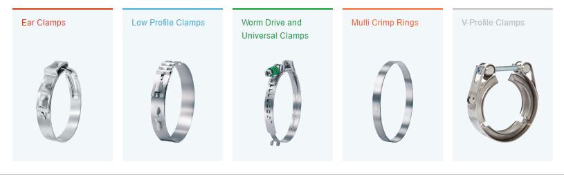

For poly, simply use barbed fittings with Oetiker type clamps..Double the clamps for buried connections. Heat the pipe slightly before sliding onto the barbs, and just before you tighten the clamps and you will never have a problem. Dont over heat though as 99% of problems/leaking come from over heating and thinning the poly.
This is the simplest most secure way.

Which oetiker clamp?

right, oetiker is a brand but the type you are looking for can also be called 'pinch' or 'ear' clamps.
they come in single- and double-pinch styles. as you pinch the "ear" you close the clamp up. the double-pinch styles accommodate a larger range of diameter and are generally suggested for thicker wall tubing but can require access to the clamp from two sides (not always so easy in a ditch). just make sure you buy them in stainless.
here is the single-pinch:
no moving parts. little chance of failure. use two on each barb.
