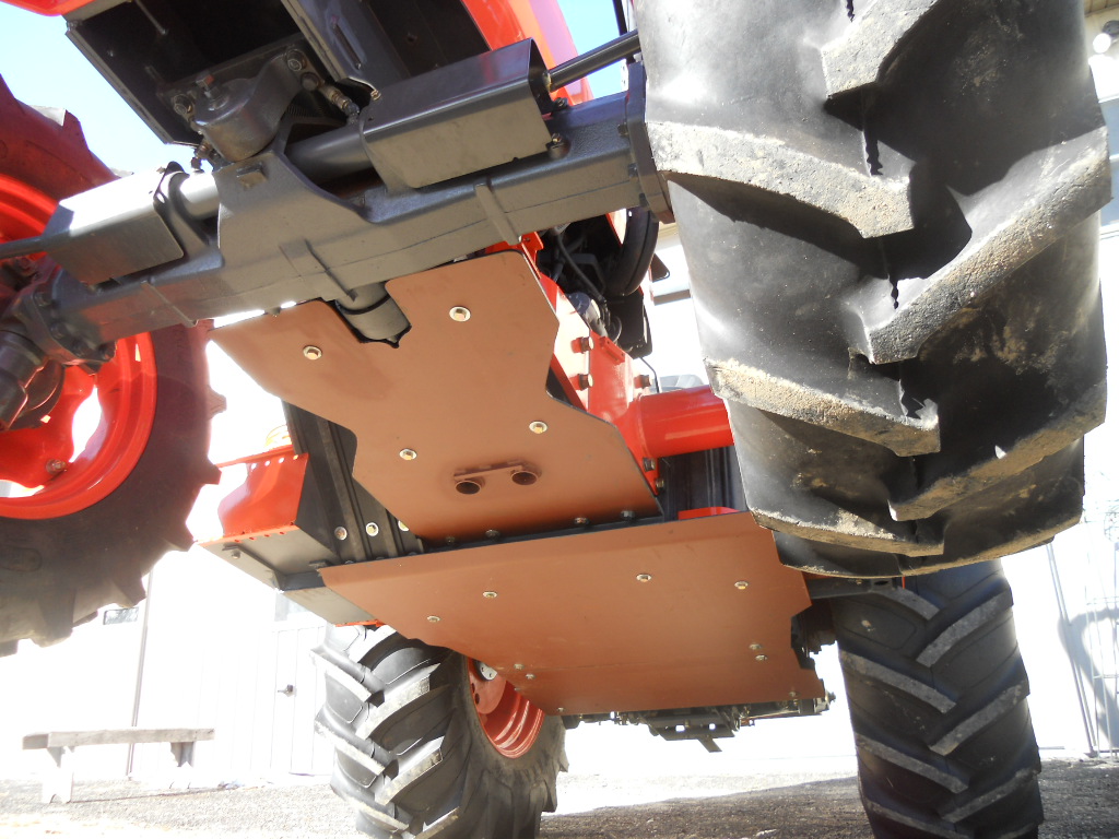

I like what you have done, Certainly cleans up the underside of it!!! I too have a backhoe and the soft lines that are zip-tied underneath broke when I snagged some brush. I re-attached and they are out of the way for the time being. Looking at what you have done; I would consider it to be a great permanent upgrade to what was there before
/ under armour for a max26/8? #17
linuxman51;4238237 Hard poly probably isn't a bad idea said:
Find an old plastic bedliner from a p/u tk. I use them for all kinds of "protection" on my tractor along with a steel skid plate from front to back. They cut nicely with a "skillsaw" and can be re-formed with a little heat. And I think that all of the newer tractors have a "tender" belly with all the hydraulics & wiring that the older machines just did not have. That's a hunk of bed liner on the grill guard, and a piece of it (with the stripes vertical) serving as a 2nd layer guarding the sides of the fuel tank above the step.:thumbsup:

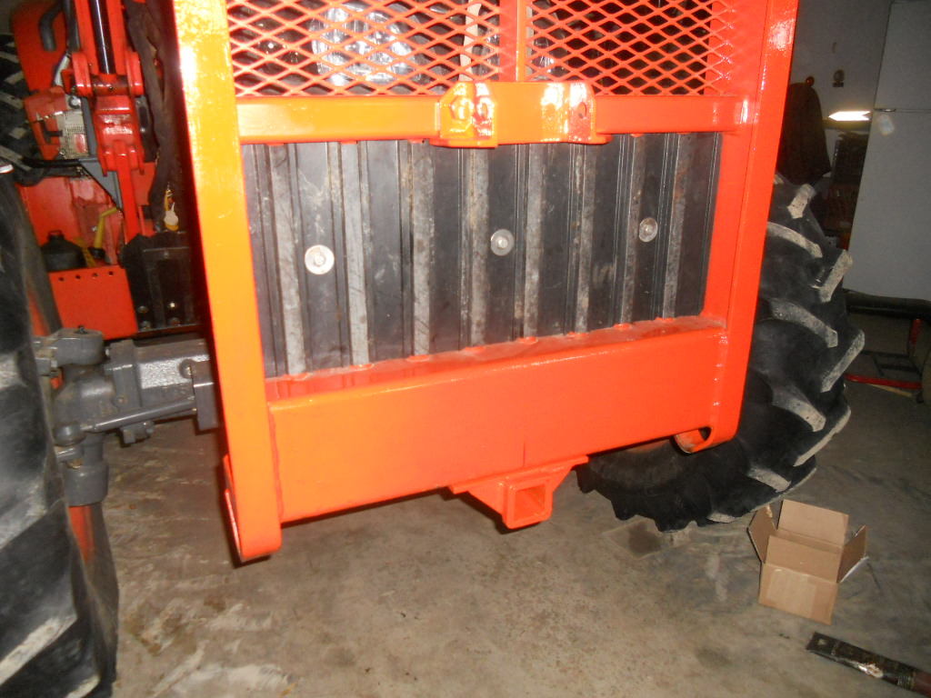

You fellas inspired me to make a belly pan(s) for mine as I'm very concerned about the brushes and rocks that I deal with at my place.
